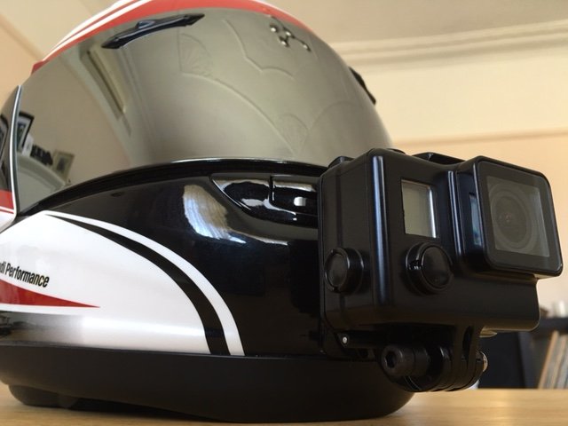

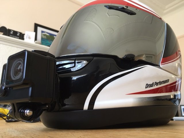

I've just setup GoPro on my helmet with a chin mount and a microphone tucked inside.

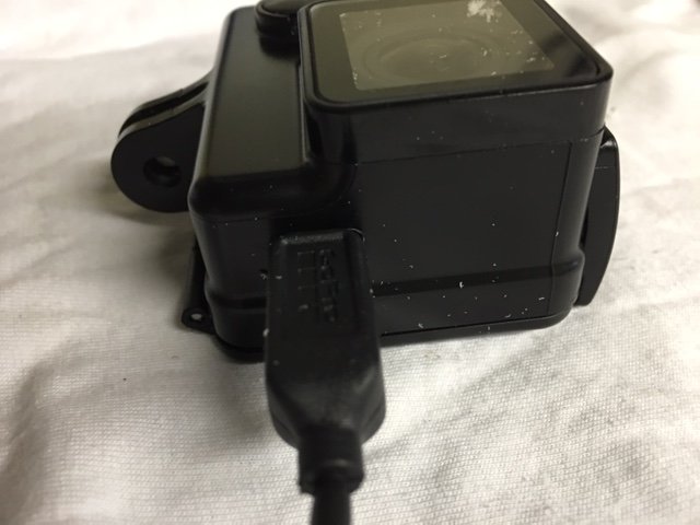

I made a hole on the side of the case for the mic adapter.
I found a small M5 bolt for the mount instead of using the large twisty things.

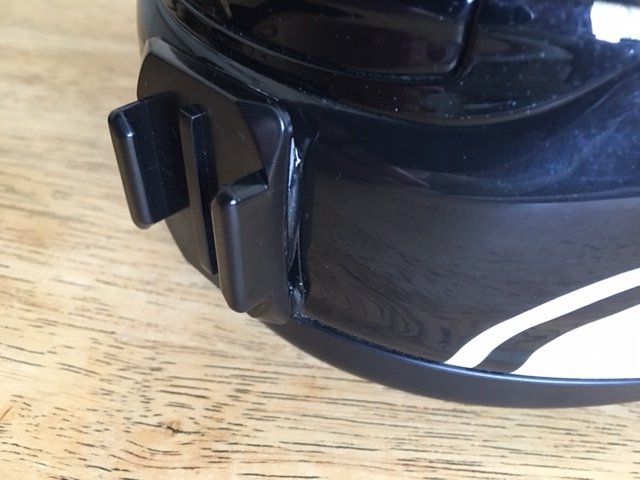

I glued the stick on mount to the chin of the helmet as I don't trust the 3M sticky tape long term and it wasn't quite the right radius to fit.
I like the clean install, all I'd like to improve is getting a right angle adapter because the GoPro one sticks out so far. BUT JEEZ... It's hard to find one that works, I'm going to get do a mod to one I have by soldering in a resister to help it block off the internal microphone on the GoPro as right now it doesn't. That's what you get for $1.05 from eBay with free shipping from China. Until then, I'll just use the BIG GoPro adapter.

Does anyone know where to get a working right angle mic adapter for 3+black. One that shuts off the internal mic and records in stereo with a stereo microphone??? I can still make my own, but I'm also lazy.
Nice, I might steal your idea of using glue, what glue did you use? I'm going to post my setup late tonight it's a bit sketch :P
Nice, I might steal your idea of using glue, what glue did you use? I'm going to post my setup late tonight it's a bit sketch :p
I used some 2 part epoxy from the local hardware store. Just a small tube of it. The stuff that mixes as you squeeze it out. It'll never come off and I don't care about that being on the helmet forever.
Thanks mate, I'll have a look into it, I have some cheapo glue sticks and a hot glue gun at the moment, but haven't got much confidence in the glue I have.
