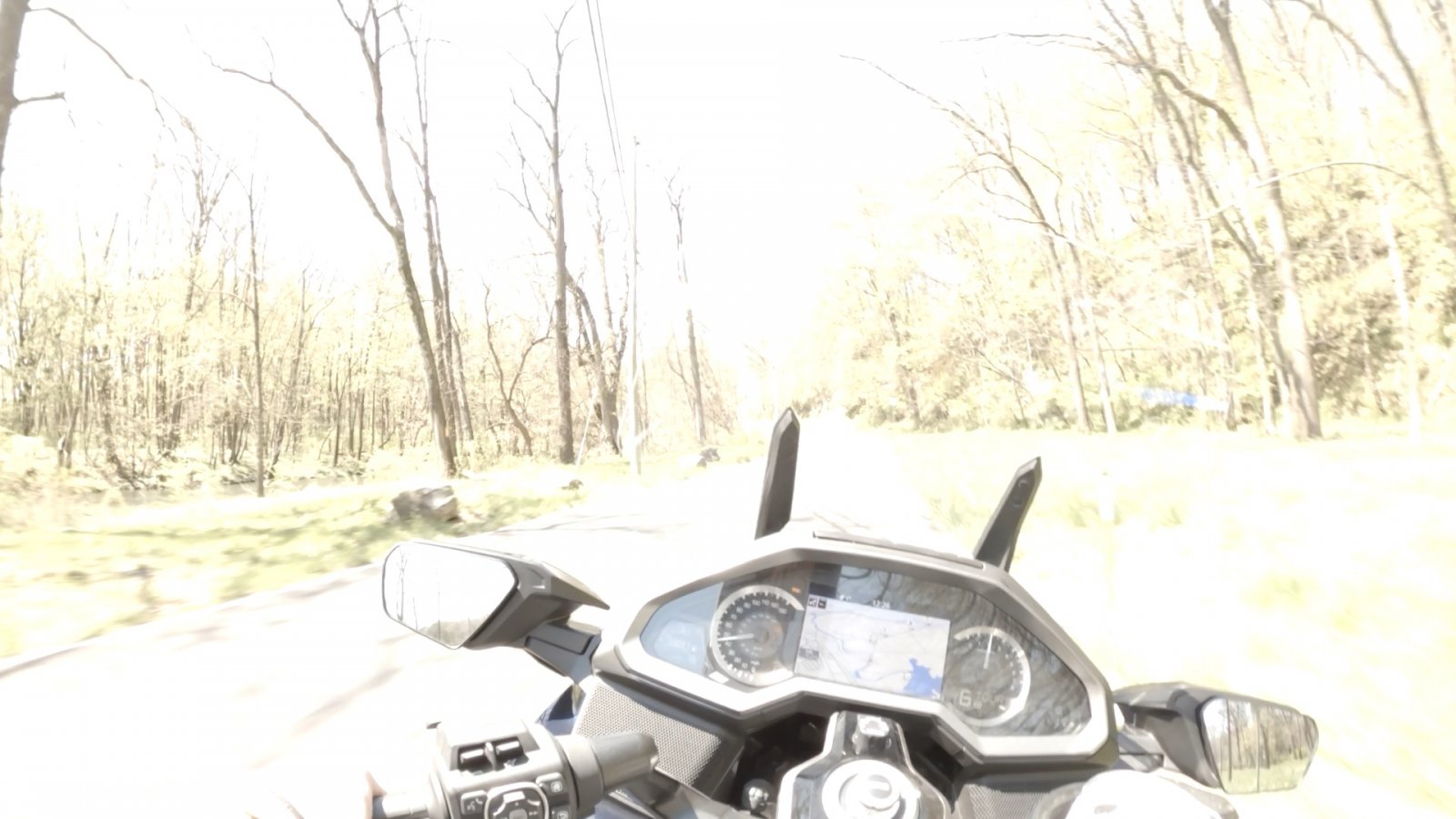

Well, my experiment with manual settings on my Hero 8 did not go so well!
This is how my footage turned out looking:
I've been trying to correct it in Shotcut and no amount of filtering and such can fix this, LOL!
Here are what my settings were:
ISO: 100-800 (low to hi)
1080p @ 60fps
Shutter: 1/120
Color: Flat
Sharpness: Low
White Balance: Native

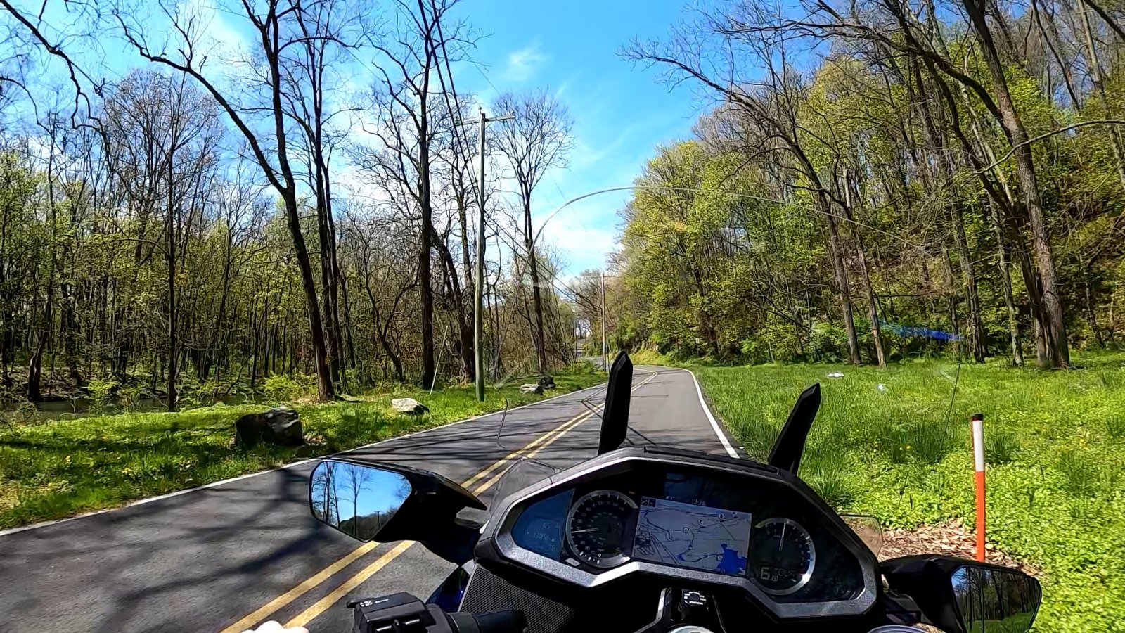

And here is how a ride one minute later looked at the same spot with my normal fully auto settings:
The manual setting seems very overexposed but I'm not sure what setting is causing it?
Your shutter speed is causing the white out. Without ND filters you need to adjust the shutter speed and white balance to compensate for each other. If you are going to run the proper shutter, you need to change the white balance till it darkens the picture. The ISO, shutter speed and white balance all work together for this purpose.
This is something you have to test and play with till you learn your camera. I did a test of different settings and ND filters on my Hero 4 and Hero 7 over the winter and will post the results when I get a little free time.

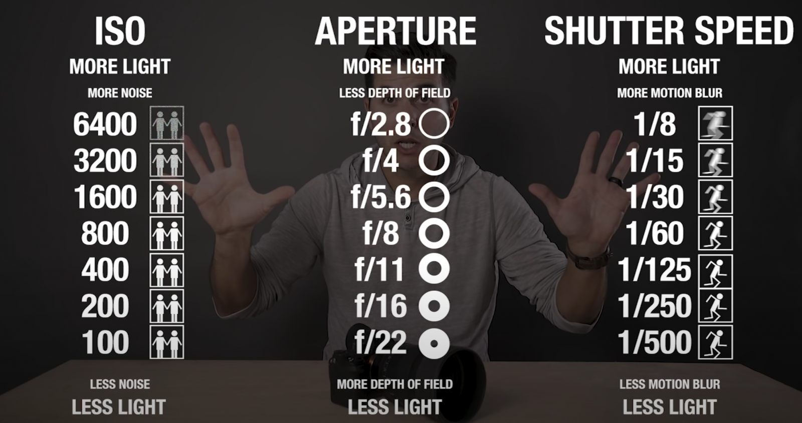

I bought some ND filters (ND2, ND4, ND8, ND16) that go on my Ulanzi case (round not square) and have played with white balance, ISO, etc. Also watched some YouTube on what those settings mean. For me I'm willing to go through the learning curve just to understand the photography / videography basics a bit better. Worst case, I decide after learning that it's not worth adjusting most of the time and leave on auto, but have the knowledge to adjust if ever needed.
I found this chart handy:
