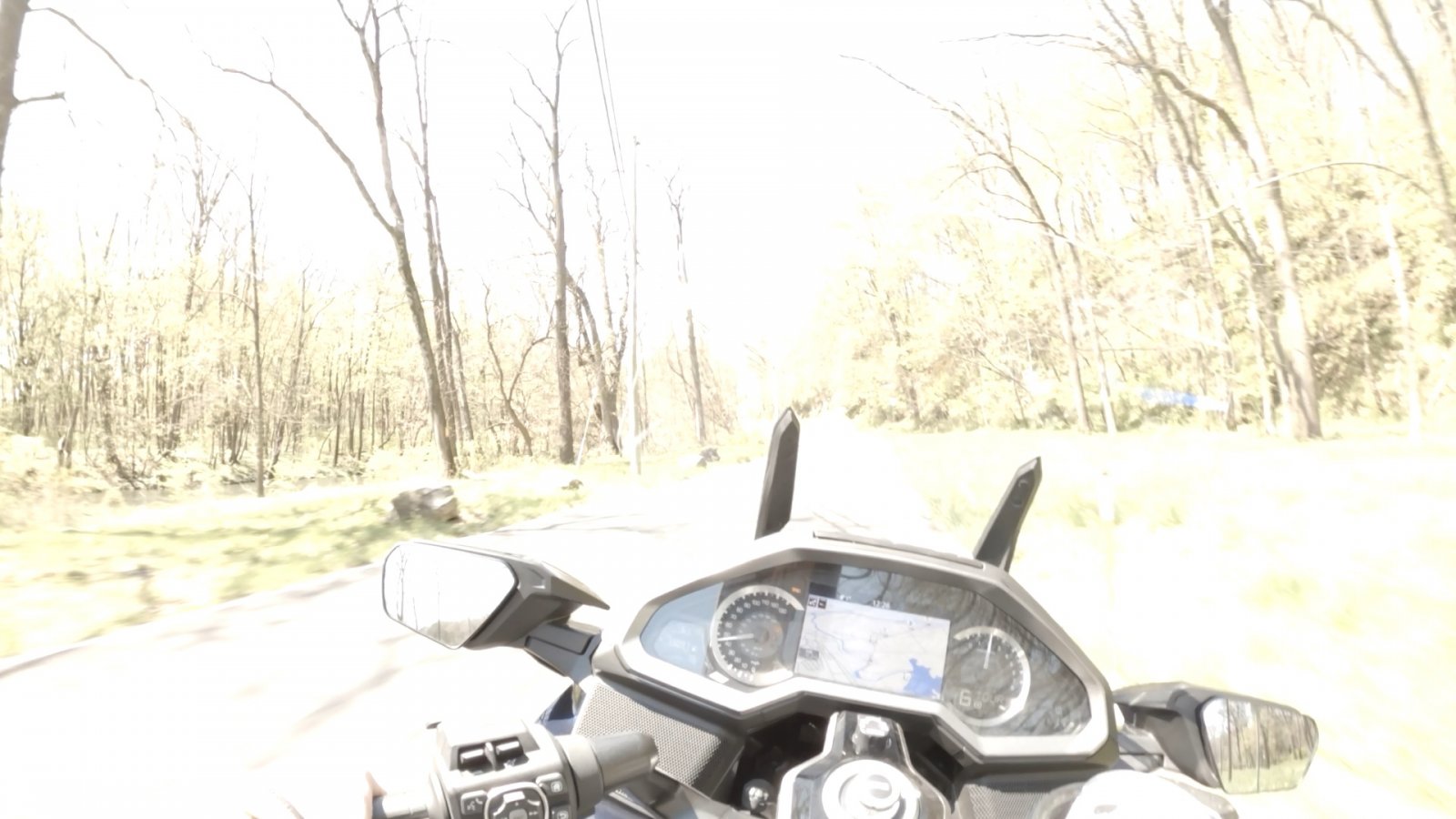

Well, my experiment with manual settings on my Hero 8 did not go so well!
This is how my footage turned out looking:
I've been trying to correct it in Shotcut and no amount of filtering and such can fix this, LOL!
Here are what my settings were:
ISO: 100-800 (low to hi)
1080p @ 60fps
Shutter: 1/120
Color: Flat
Sharpness: Low
White Balance: Native

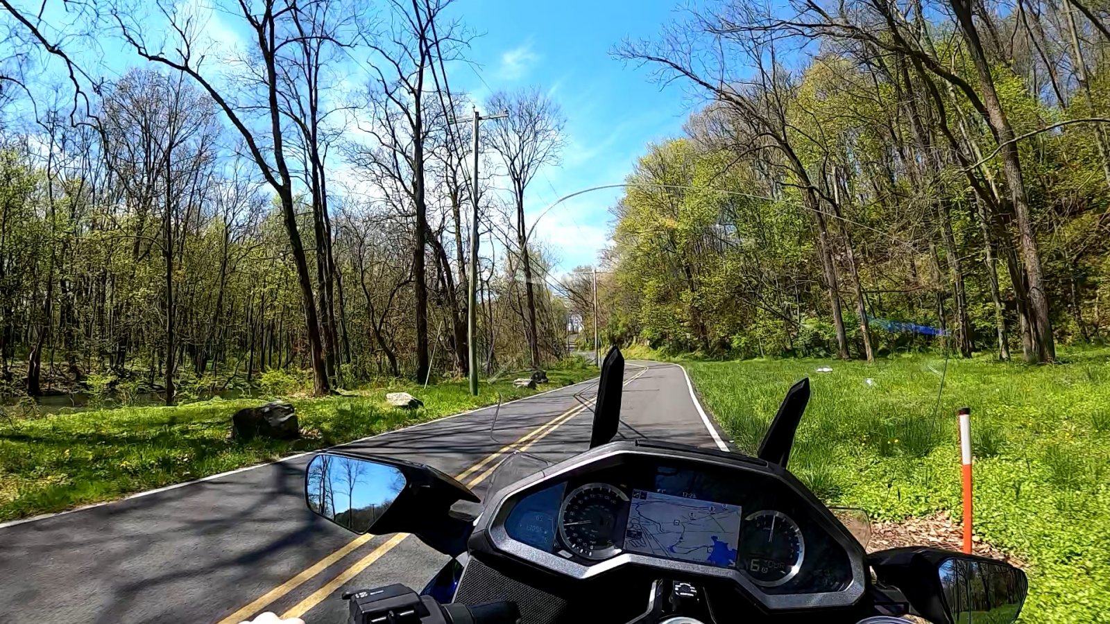

And here is how a ride one minute later looked at the same spot with my normal fully auto settings:
The manual setting seems very overexposed but I'm not sure what setting is causing it?

too much light, throw an ND filter on it

I don't have an ND filter, and I'm not sure you can with the Hero 8?
And too much light seems like a settings error to me. Maybe if I force the ISO down to a lower range?

I don't think the Sony IMX377 has extended ISO ranges so 100 is as low as you can go. Anyway native ISO should be 400 or so for best dynamic range you'd lock it at 400 and use an ND filter to stop it down 4 stops or so. Yes the Hero 8 uses the same ND filters as any of the cameras since the Hero 5.
