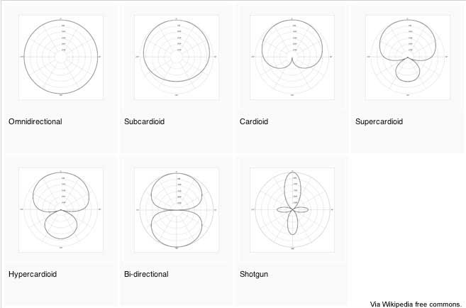

First, lets begin with a basic understanding of pickup pattern ...
Lavaliere mics are generally cardioid or omnidirectional microphones. The image above shows a cross section of the "on mic" area of each ... or where you get clean, natural-sounding audio. Imagine the images in 3D, where the center of a graph is the tip of the mic and the pattern shown rotates all the way around it.
As you can see, the omnidirectional pattern will pickup audio from any direction and the cardioid is focused on the 180* directly in front of the mic. This is great for a lav becasue when the speaker turns their head the dynamic range of the audio is maintained.

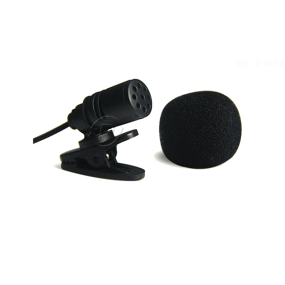

This is a standard form factor for a lav mic. Looking closely you can see open areas for sound waves to pass through uninterrupted on the tip and also on the sides. While great for a presentation, when you put this thing in 60 mph winds, those areas catch the air and if they don't direct wind directly into the mic itself, they create turbulent vortices right beside it that's picked up in your recording. Even if the mic is pointed right at your mouth with the wind behind it, the air will still catch on the sides and wrap around the tip and be picked up.

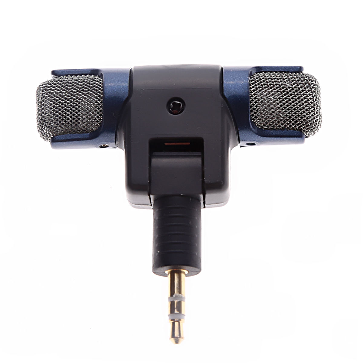

This choice is even worse with dual microphones exposed in all directions. There is literally no direction to face this thing that would begin to shield the mics from wind.

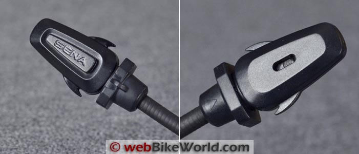

Personally, I've been suggesting the Sena 20s mics to people with issues. I use a Sena wired mic from a SMH10R that I had to custom wire. The 20s versions are the same mics but have a 2.5mm plug that can be easily adapted to the common 3.5mm plug needed for action cameras.
I recommend these mics becasue they are engineered to reduce wind noise in our specific application.
Look at the design of the Sena boom mic. Notice the small opening and large plastic shield with tapered edges. This is engineered to divert wind coming directly at the back of the mic around it. And it does so far enough away as to not let any created vortices reenter the mic's pickup area. The tapering on the edge reduces the turbulence created as the wind is diverted.
This mic can capture clean audio at speed from an open face helmet. Sure, Sena uses advanced noise cancelling technology, but they can only apply that to the audio that's captured. With only one mic, you have to kill the wind noise to effectively clean up the voice because you don't have a secondary audio stream to compare to and remove the unwanted frequencies.
And yes, the Sena mics come with foam windscreens. These are no different than the same ones I've said don't work for other mics. In the case of the Sena application, they are there to reduce noise coming directly toward the front of the mic, like breath or a crosswind when you turn your head. If you look hard over your shoulder, the Sena mic will still pick up wind noise with the shift in direction.
So, all that to say that while foam and fur and position can help, the only way to actually cure the wind noise issue without sounding like you're speaking from another room is to divert the wind around the mic. And there are mics out there specifically designed to do this. Maybe don't reinvent the wheel and spend $25 on a mic designed for the job. It's worth it.
