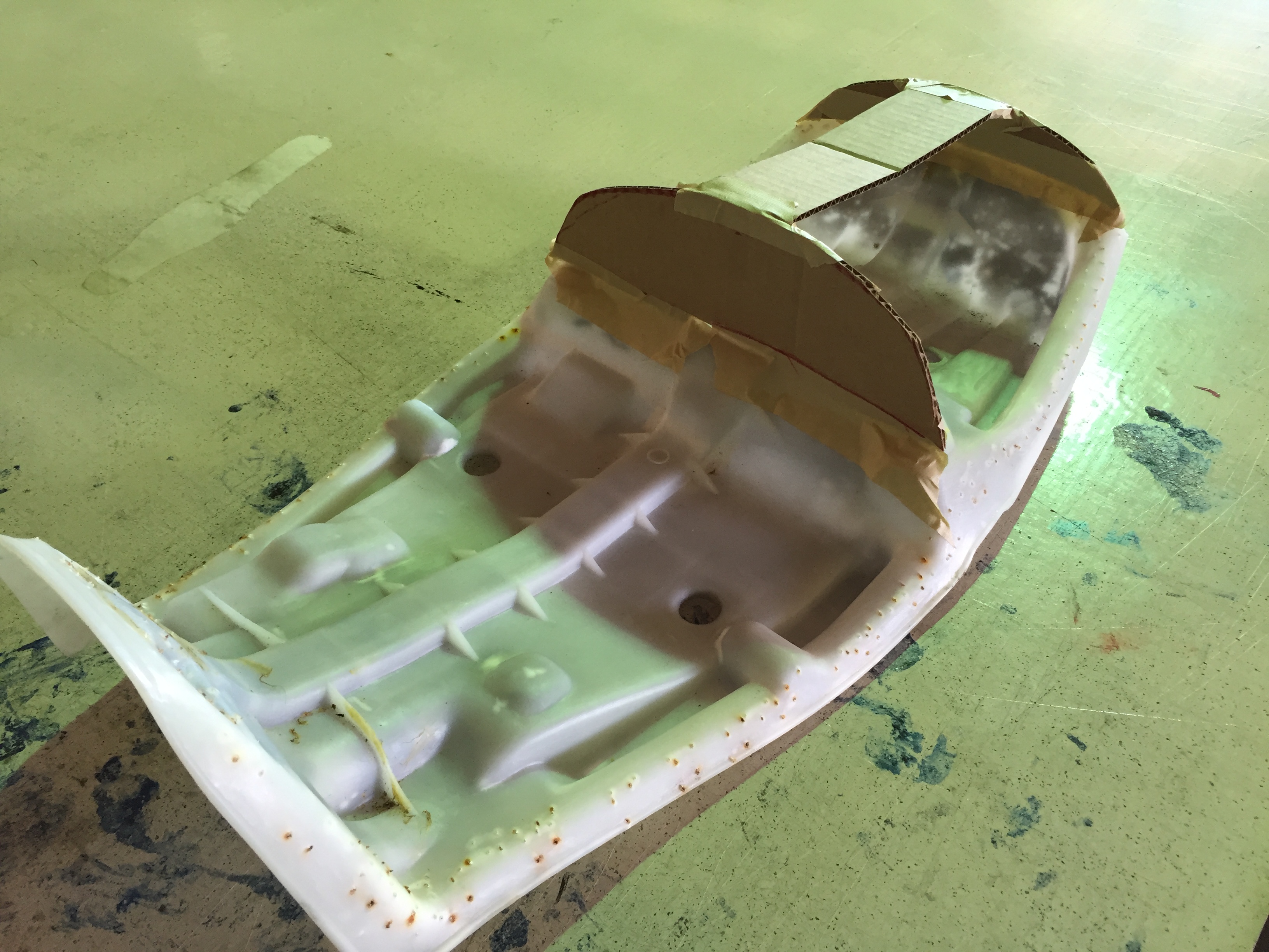

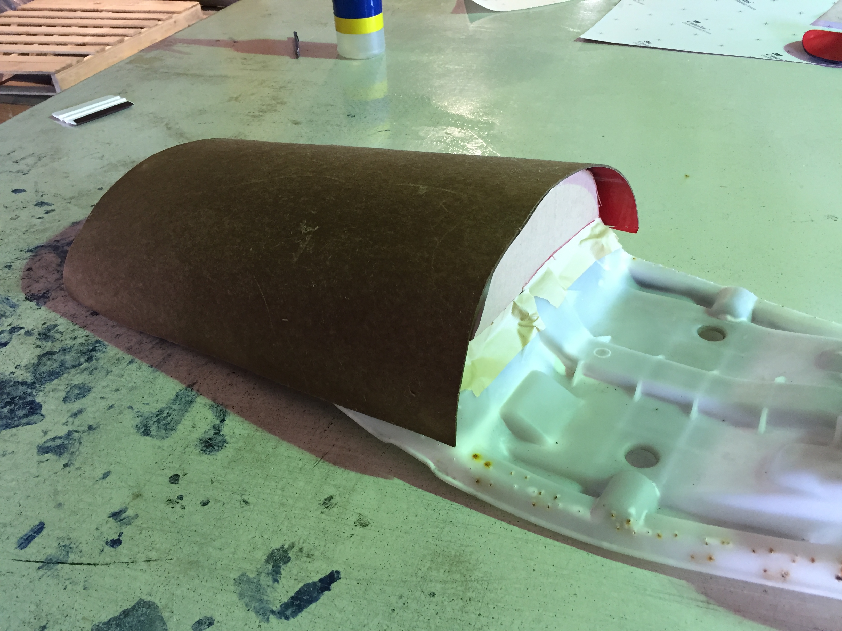

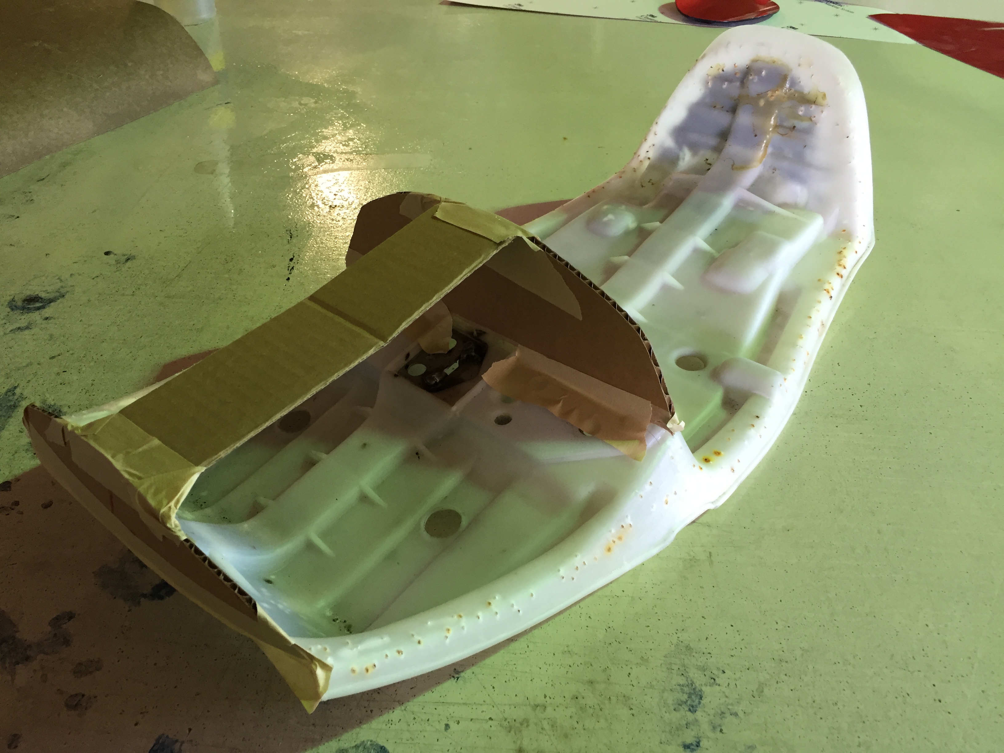

Started the resurrection of my cafe project with a goal of finishing it by the end of the month (at least being able to ride it, as some things will take a while to be made just right). One of those things that will take a bit, the cafe seat using the old Seca II seat pan. Here's the mock up for the abs pieces to be done later

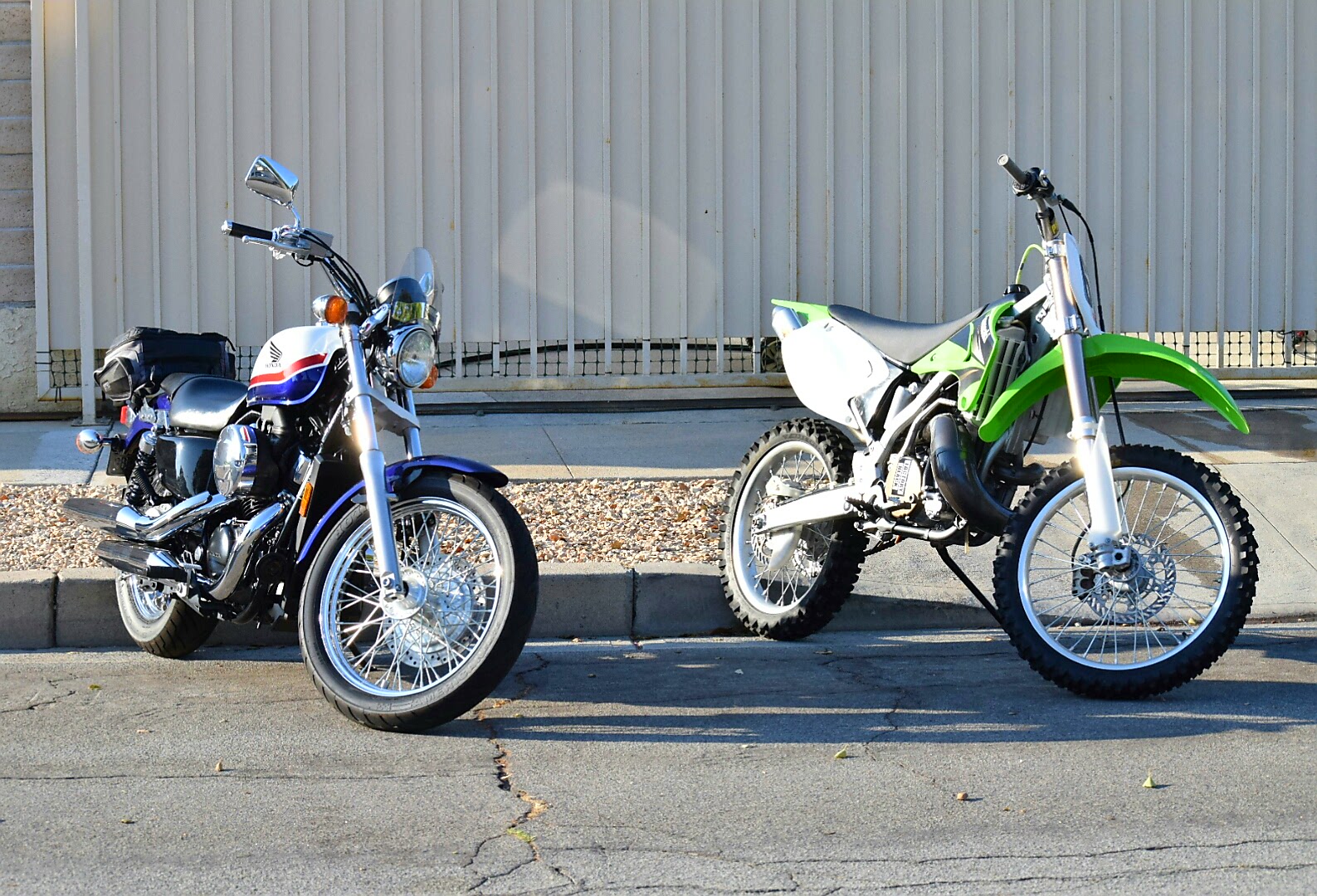

Got my Kawasaki KX250 ready to go riding this weekend it's been a couple of years. Oil change, adjust everything, lube adjusted the chain. Cleaned the gas tank new fuel and new 2 stroke mix. New airfilter. Checked blots bolts bolts, checked out the tires, new spark plug, checked the spokes and locks, washed and plastic wax. She looking good.
I rode it to work and flipped off a guy for tailgating me. He was mad that I passed him GOING THE SPEED LIMIT!
gotta be careful doing that , some people may run you over...

A fiberglass seat pan. Molded fiberglass to my gram, took it off, sanded it and shaped it, put threaded rivers on it then foam and the vinyl.
Ahh , i can see that now after the pics was pop'ed up ... Never knew you could change or makes seats like that
