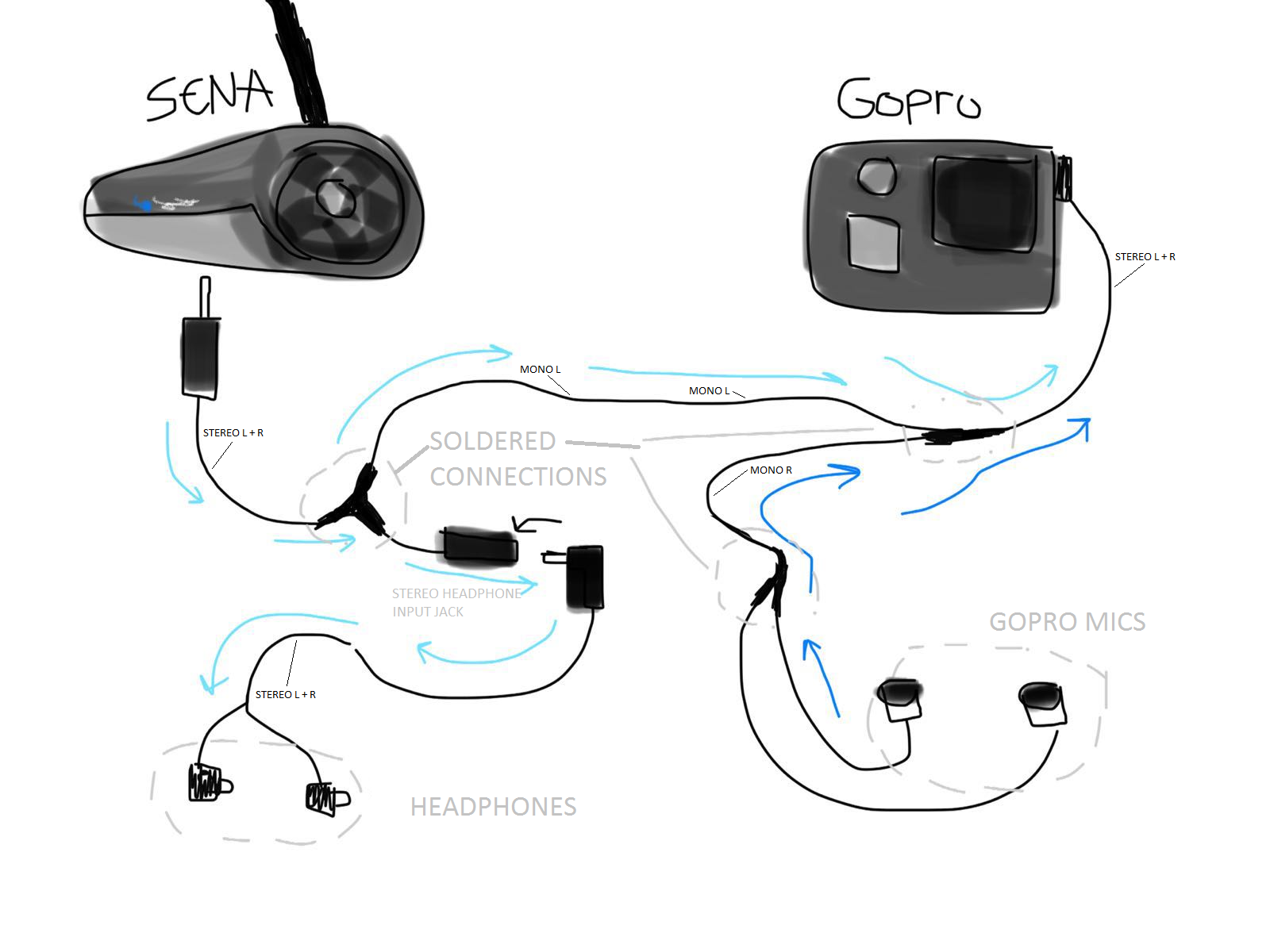

What is up guys, I was wondering if any of you guys wired up your SENA to your GoPro.
I am using normal eletret condensator mics which I feed into the right channel of my GoPro, and feed all of my SENA output to the left channel of my GoPro which means I get other people talking, music, phone calls and the like recorded straight to my video and my voice as well. Afterwards I just import these as 2 mono tracks and mix them how I want (remove music, etc etc). Even the ambient mode gets recorded!

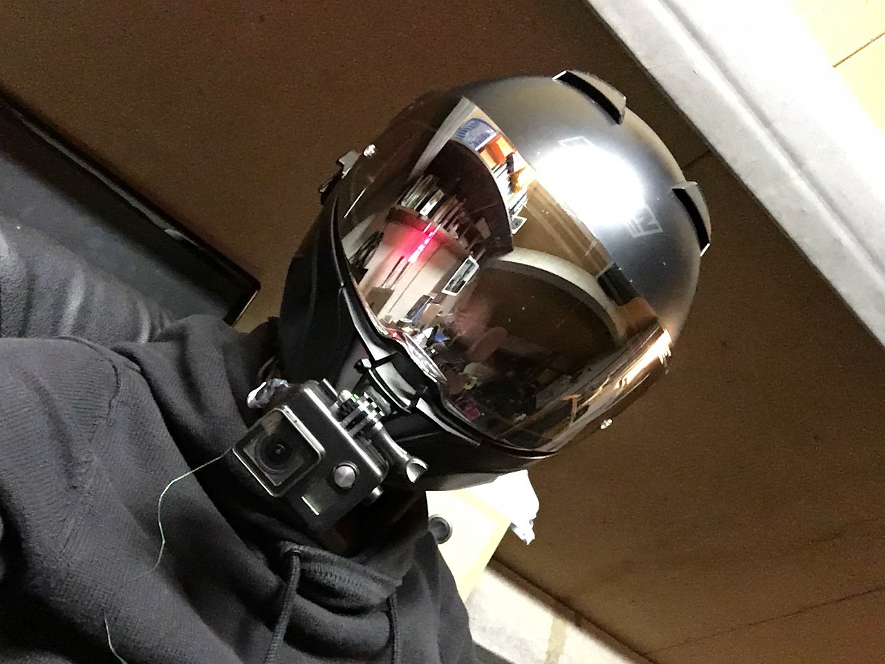

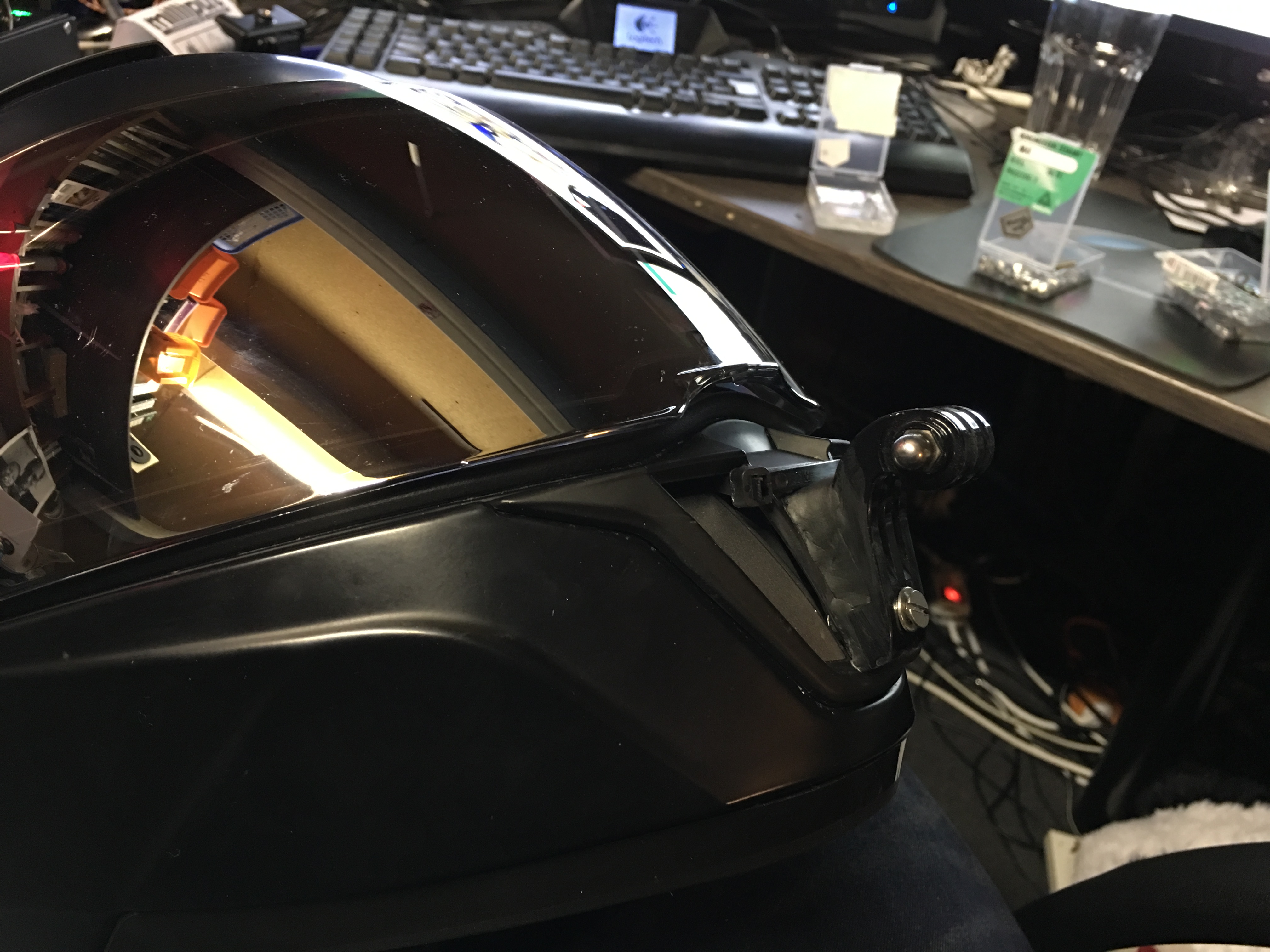

I also chinmounted my camera on a very hard to mount helmet (hehehe...) the screw you are seeing is only through the ventilation part, NOT through the helmt itself.
One of the GoPro mics is very close to the internal speaker. This means I have 2 choices: use the helmet speakers and record all my talking *and* the SENA sound. Or plug in the custom cable I made and some earbuds and record the audio stream from the SENA directly into the GoPro and also my voice through the mics.
Anyone else use a setup like this?
I attached a simple scheme of how I wired it up...The headphone female input jack is hidden inside my helmet and I can hide the plug that I put in the SENA as well.

Even though the soldering is a one time tedious task...I now have a direct feed of all SENA audio I can hear through the headphones (which is crystal clear tight audio) and my mics straight into the GoPro. All I have to do is either: plug in the cable and headphones, or do nothing and the 2nd gopro mic will pickup much of the SENA's output audio because it's next to the helmet speaker.
