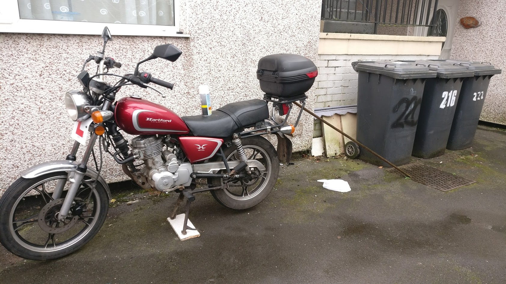

Thought I'd share a quick tip on how I spray my chain by myself.
I have a draw front under the side stand which lifts the front up by an inch or so. Then using and peice of random wood found behind the bins I prop it under the rack and push it onto the front wheel and then wedge the other end on the man hole cover. Then as a spray the chain I can spin the wheel.
I also use the wood when I park on grass.
