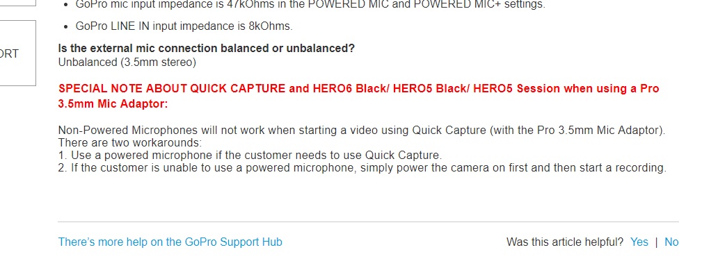

Damn the USB-C connectors, been out on the bike all day recording and come home to find no external audio again. This time however was my own fault as I hadn't pushed in the connector far enough and all I had was camera audio which meant wind noise central! :(
Well it looks like GoPro have now nerfed the Hero 6 Black too and taken away our ability to use Quick Capture/one touch record when using an external mic :-(
