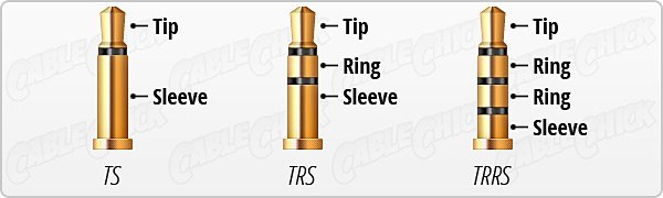

I am not a Drift user, but are you using the correct type of mic? there are a few types:
7,752
7,086
Ok thank you , interesting im not sure that it mentions which type to use in the manual . I’m trying with a TRRS, I’ll investigate
It looks like (but I am not saying it is this as I have not got one) that Drift use a TS 3.5mm jack. Am not sure how this would affect stereo though?

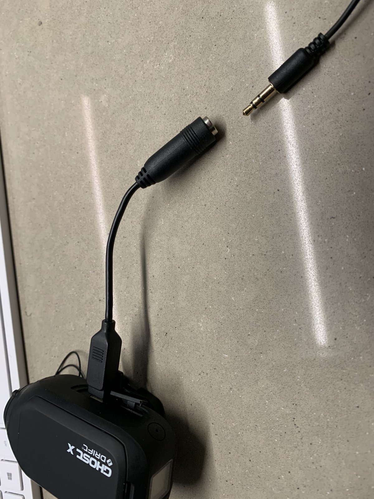

I use the same TRS to TRRS adaptor for my wired GoPro set up so if needed you should be able to use with other cameras as well. Glad you got your issue sorted!
