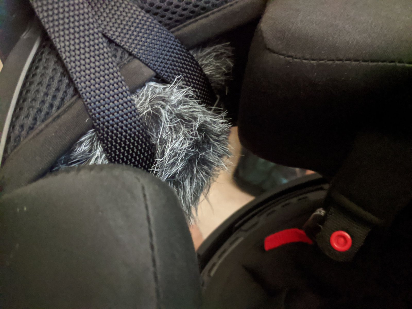

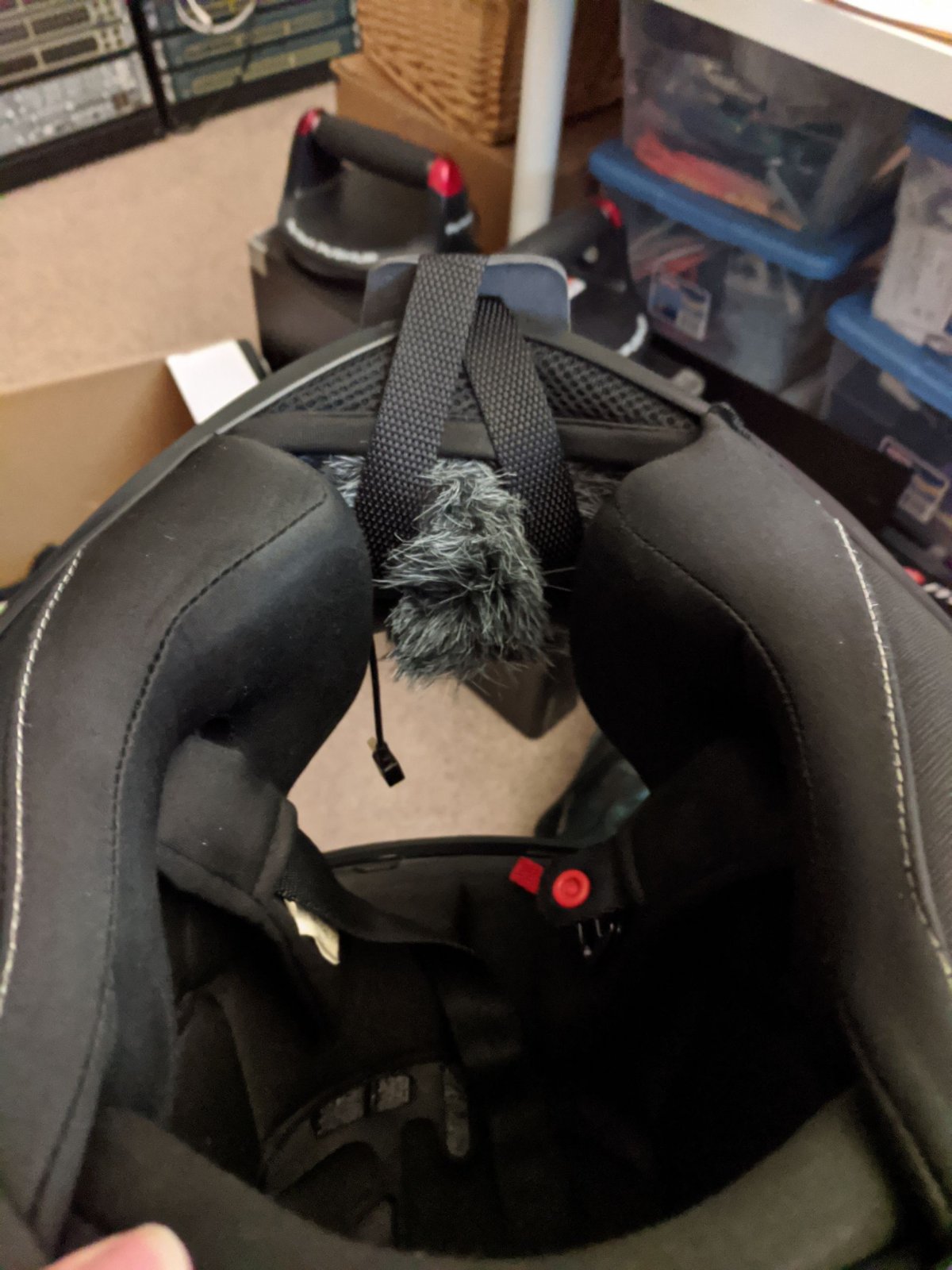

I don't use a manufactured deadcat, I make my own so trim the fur to suit the role :) I also line the chin piece with fur too, especially around the wind deflector on the neck
hmmm hadn't thought about trimming it, maybe I'll give that a try.

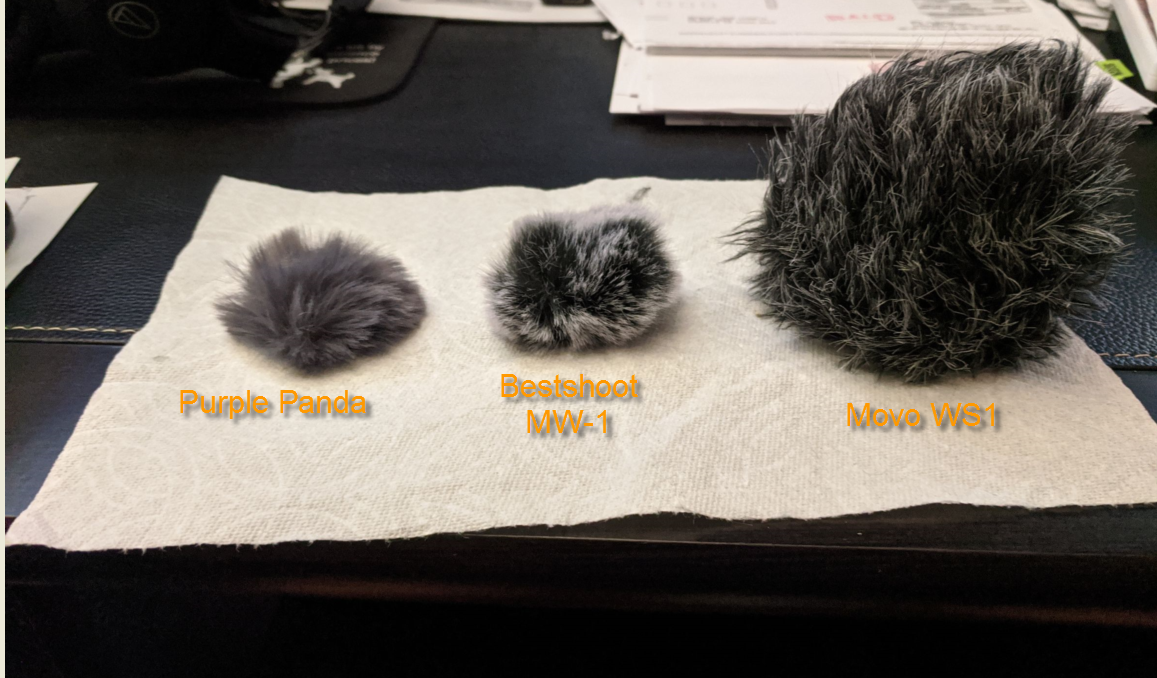

Any how here are a few of the different windscreens I have tried. The standard Purple Panda (aka Panda) is not bad but its a little too small to get the Panda blimp and the Panda mic to fit together at the same time. You can force it but you have a high chance of ripping the Panda deadcat. What I have been using (that seems to work the best so far for me) is the Purple mic, with Panda black blimp windscreen on top of that with the Bestshoot MW-1 windscreen on top of that. (The MW-1 (shown center) is also a good replacement to the Panda dead cat if you were to ever lose are break your Panda deadcat windscreen (shown left). On one of my most recent videos I test the Movo WS1 (shown right), but what a monster though, it looks like a Muppet. I tested the Panda mic, with the panda black blimp on top of that, with the Bestshoot MW-1 on top of that, with the Movo WS1 on top of that! It seemed to do a great job blocking wind noise but my face was buried in muppet fur and my voice sounded like it too! It was not very comfortable so I probably am not going to use the WS1 as a go to in my current helmet (Bilt Force Matte Black.) The Panda microphone and windscreens have been mounted directly inside the front mouth area shown below.
Next setup I want to try is mounting near the ear pad to see if that is any better but not with the WS1, it may look like a reasonable size in the picture but it's way to big in reality. I dry tested it in my office and it gave me a headache. So back to the MW-1, with Panda blimp and Panda mic. Furthermore, I am currently using this mic setup in conjunction with a GoPro Hero 4 Silver.
