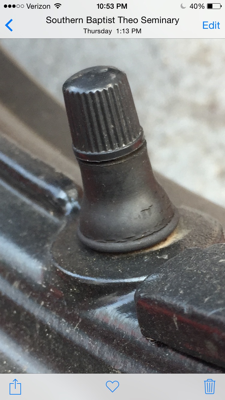

Caught a little potentially deadly problem during a quick visual inspection. Front tire was 4# low, odd for it to deflate that much in a week so I did a visual and found nothing until I went to put the inflator to the valve stem! It wasn't cracked last week but this inspection revealed a crack all the way around the stem and a vertical crack as well. I didn't have time to do anything but put the bike away, pull the front rim and take it to a local shop (already had new shoes for it anyway). $23 later it's ready to go again, the mechanic said he put a little pressure on the stem with his thumb and it broke right off (no valve tool needed to air it down!). Blessed that I saw it!
