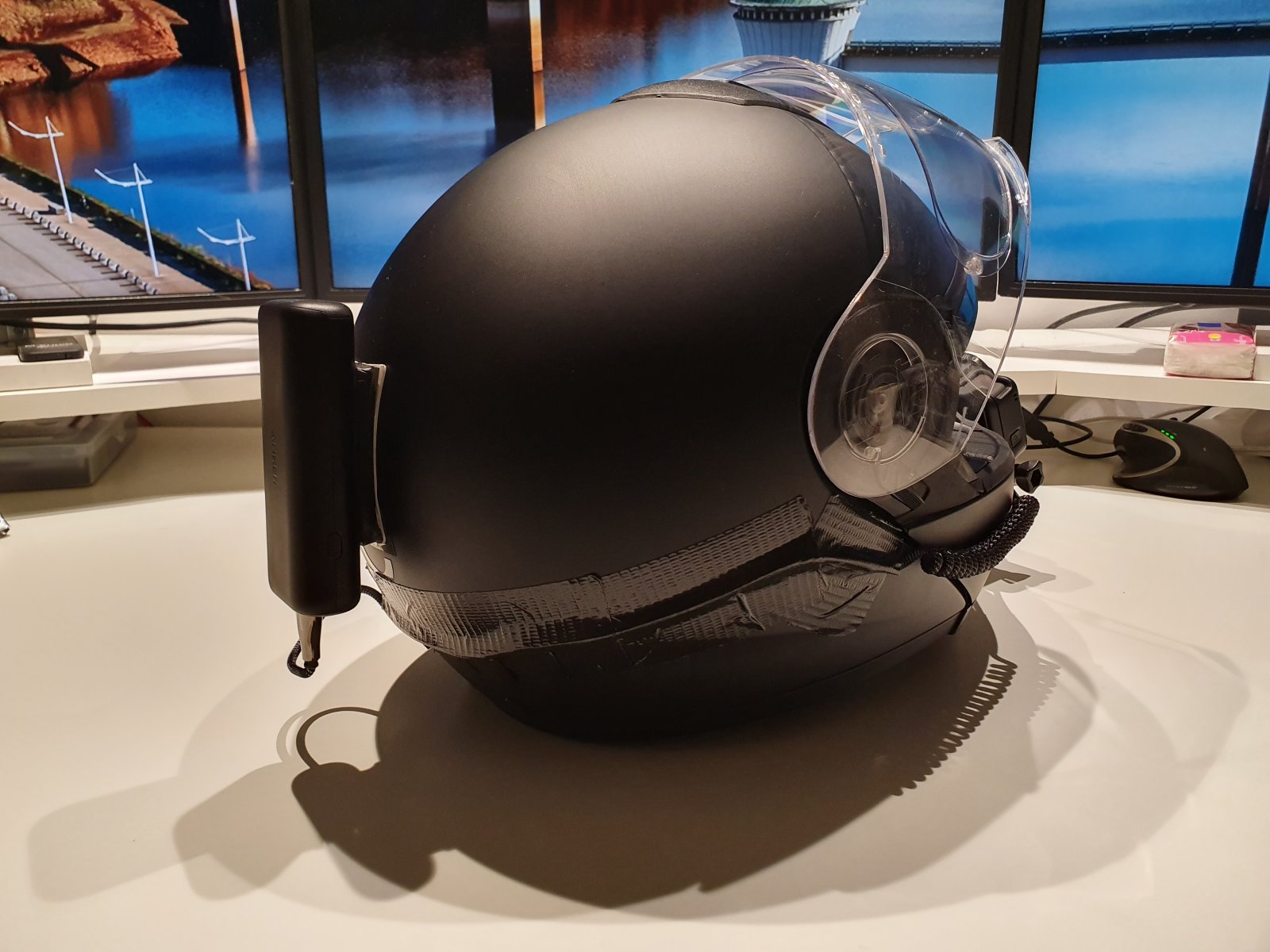

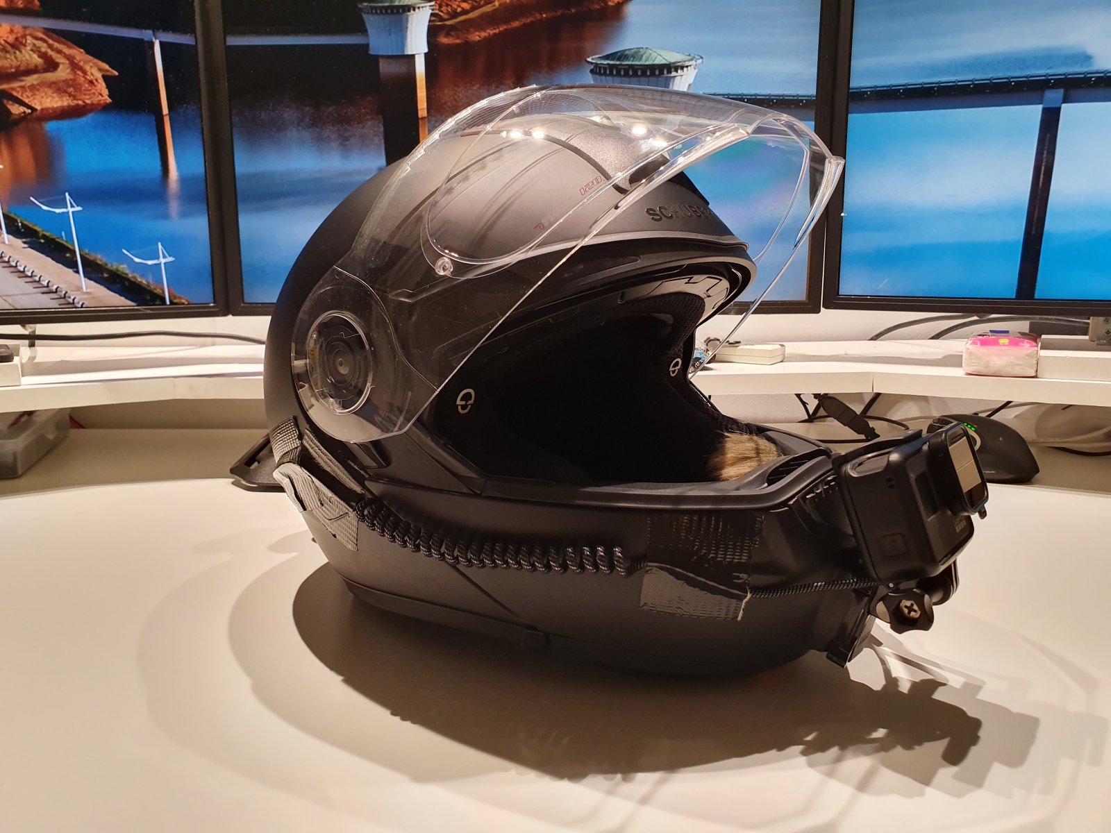

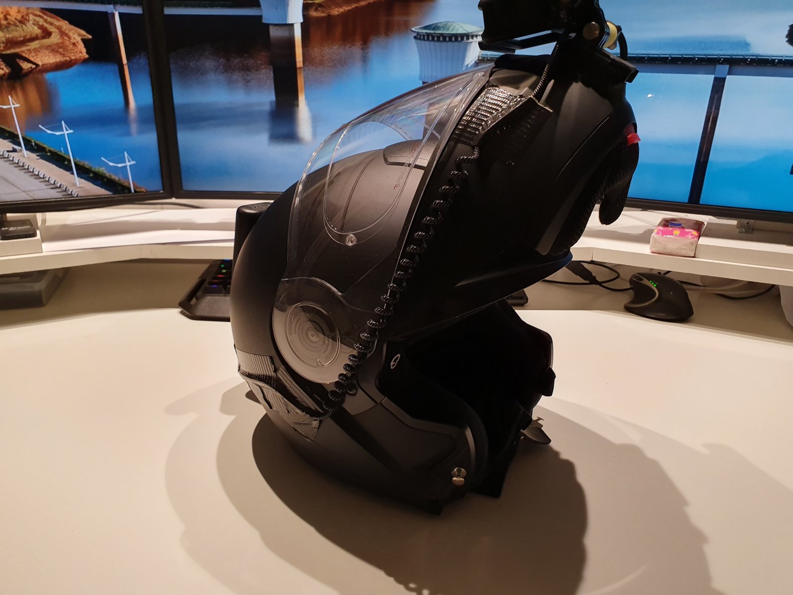

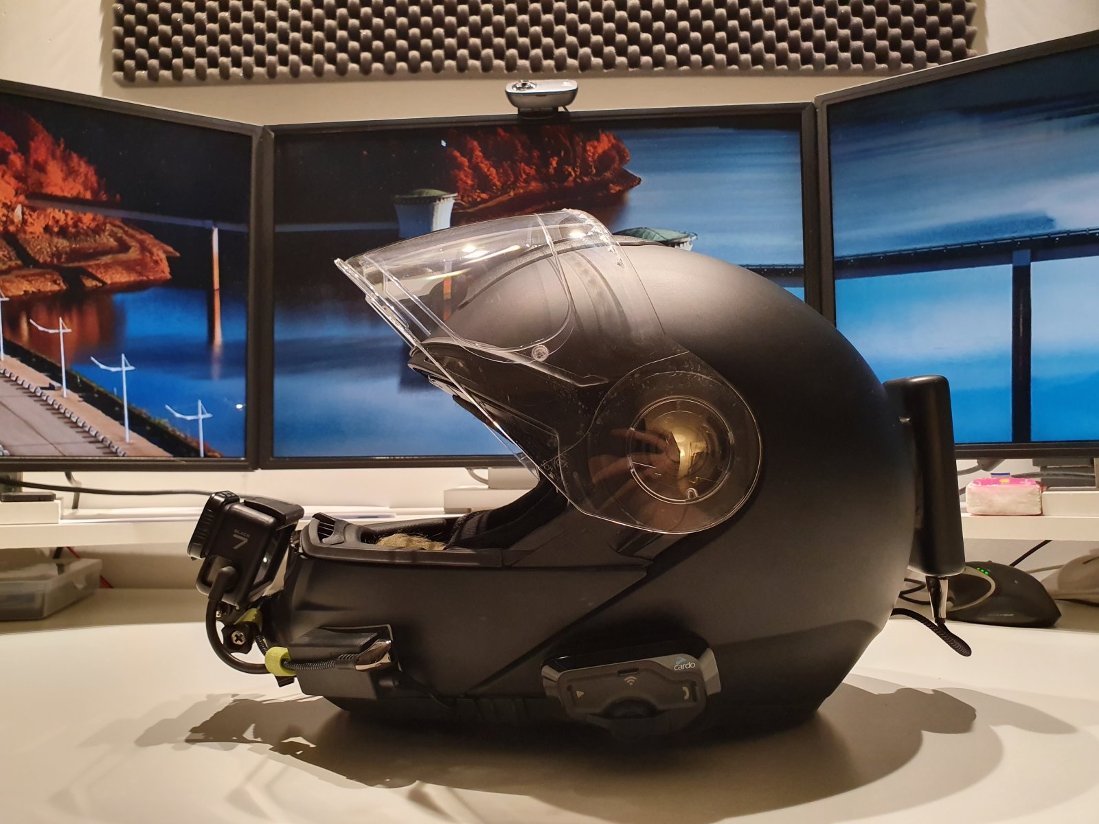

Yeah, so I was building again and this is what I came up with for motovlogging with a modular helmet:
I've made the coiled wire myself, but I still need some wire clips to keep it from flapping at 200km/h.
Weight is OK, balanced, as it should be. The Anker weighs around the same as all the other things :)
Everything is mounted with double sided tape, but I've made my own mounting plates with thermoformed plexiglass and sugru. They stick so good, and the fitment is nearly perfect :)
Seems like you have it sorted out. I would of been tempted to use dual lock (velcro basically) so I could take things off to give them a clean,, charge etc but each to their own. As long as it stays on happy days eh?

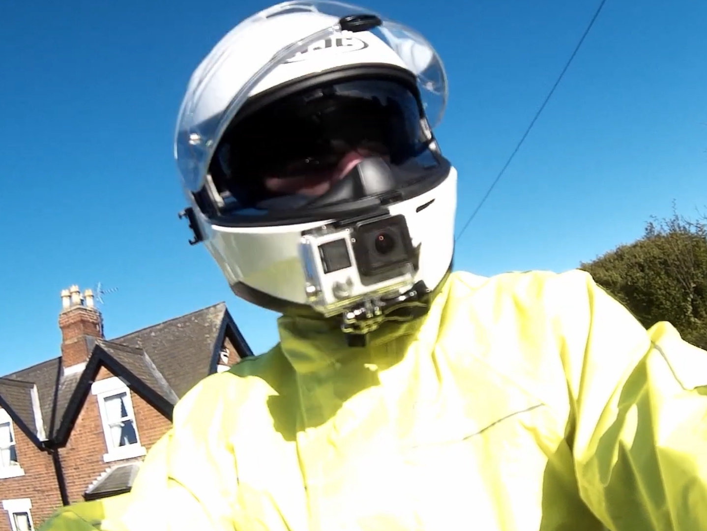

GoPro Hero 4 Black paired with a Sena GP10 and Sena 30K bluetooth on my Shoei RF-1200.
