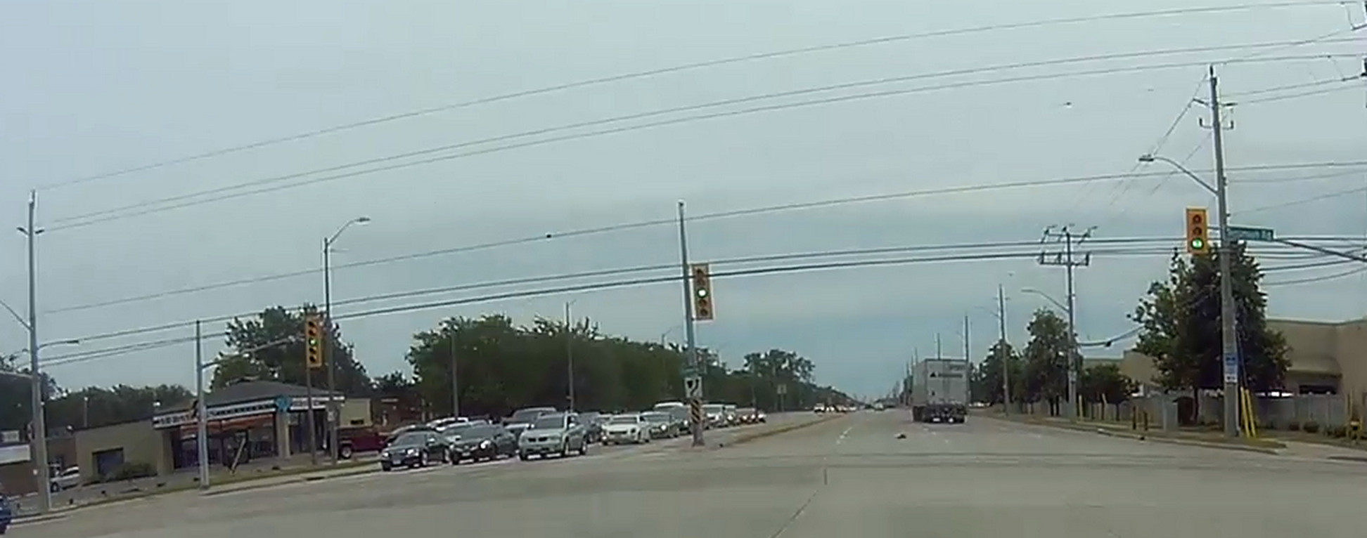

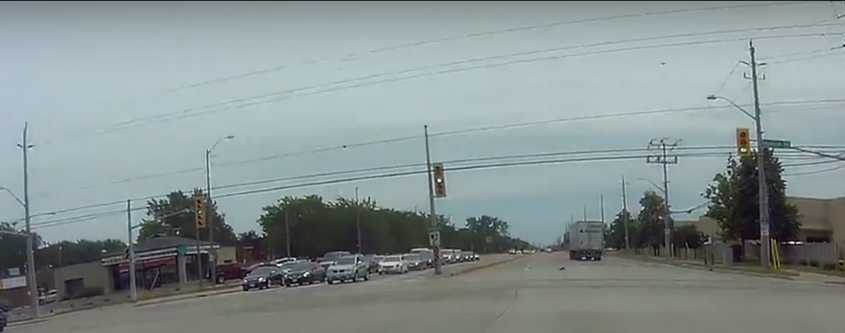

So, I've had some time to go over the videos and found one spot in both where the compression artifacts were apparent.
I'm going to upload the pics, and they are very similar. First one will be the precompressed video and the second will be the high bitrate video
I captured the frame by playing the video in one version at quarter speed and pausing as close as I could catch to the 3:07 mark (a couple frames past it)
I grabbed a screenshot using FastStone Capture, capture windowed area and I captured a section from a specific, identifiable pixel, at the top of the picture (very top of a telephone pole). Capture size was 857 pixels by 338 pixels (bottom center of a car tire).
I then went to the high bitrate video and played at quarter speed. Kept trying frame by frame until I saw the frame that most closely matched and tried to select the exact same pixel at the top of the telephone pole, and ensured that my capture was 857x338
I resized both images to 200% using the FastStone editor.
I've personally noticed that while the compression artifacts are certainly different, it's really hard to say that one is necessarily "better" than the other.
Watching through the video, I still feel that precompressing is a better approach, as while the overall quality will be a bit lower, (IE the best quality frames will be lower quality but the lowest quality frames will be of a higher quality), the resulting effect is that the compression artifacts end up a lot less jarring and noticable due to a smaller change between the best and worst quality.
The higher bitrate video's best looking frames were fantastic, but the worst looking frames were horrid and the effect is that my eyes could really pick out the artifacts better.
The potential quality in the high bitrate video was astounding but when it gets bad, it gets worse. The higher "contrast" between good an bad makes me feel that it's the worse way to go.
That said, I think this is going to be a very very subjective thing, and may even differ based on the content.
Anyway, the images are below, I would suggest saving them both to a folder, so you can use the Windows Photo Viewer (or your mac/linux equivalent) to switch between the two (they are very very close) and see what you think.
Just to show that YouTube is, in fact, the culprit here, I've uploaded (close to) the same frame and size (was less careful really) showing the encoding out of Premiere, both at 28mbit/s and at 12.5 or so (CBR and 2-pass VBR respectively).
I've also attached a screen of the raw footage as the third image.
Visually what I'm seeing is a reduction in Blacks from the top down, or should I say it's being added if the bottom image is your from your raw footage (not tone confused with RAW footage), and the top two have been processed/compressed.

Bottom is the footage straight out of the camera.
It might be hard to judge the entire frame though, it's really just a small portion.
If you check out the video, you can probably pick out where the grab is from, at the 3:07 mark.
Also, and not sure if it's going to make a difference tonally, but the footage right out of the camera is 60fps, and the exported footage is 30fps (I messed up my sequence settings :( )
