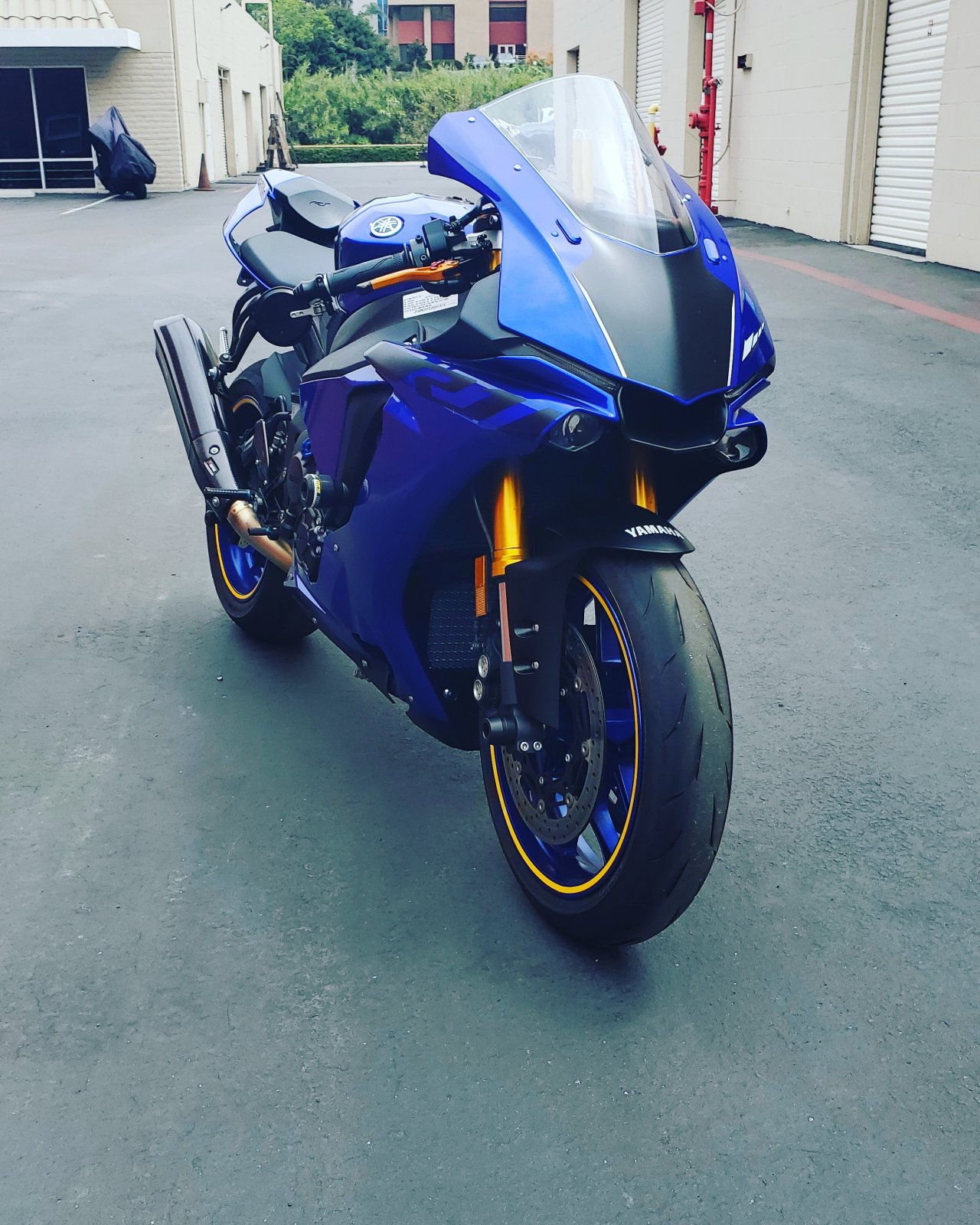

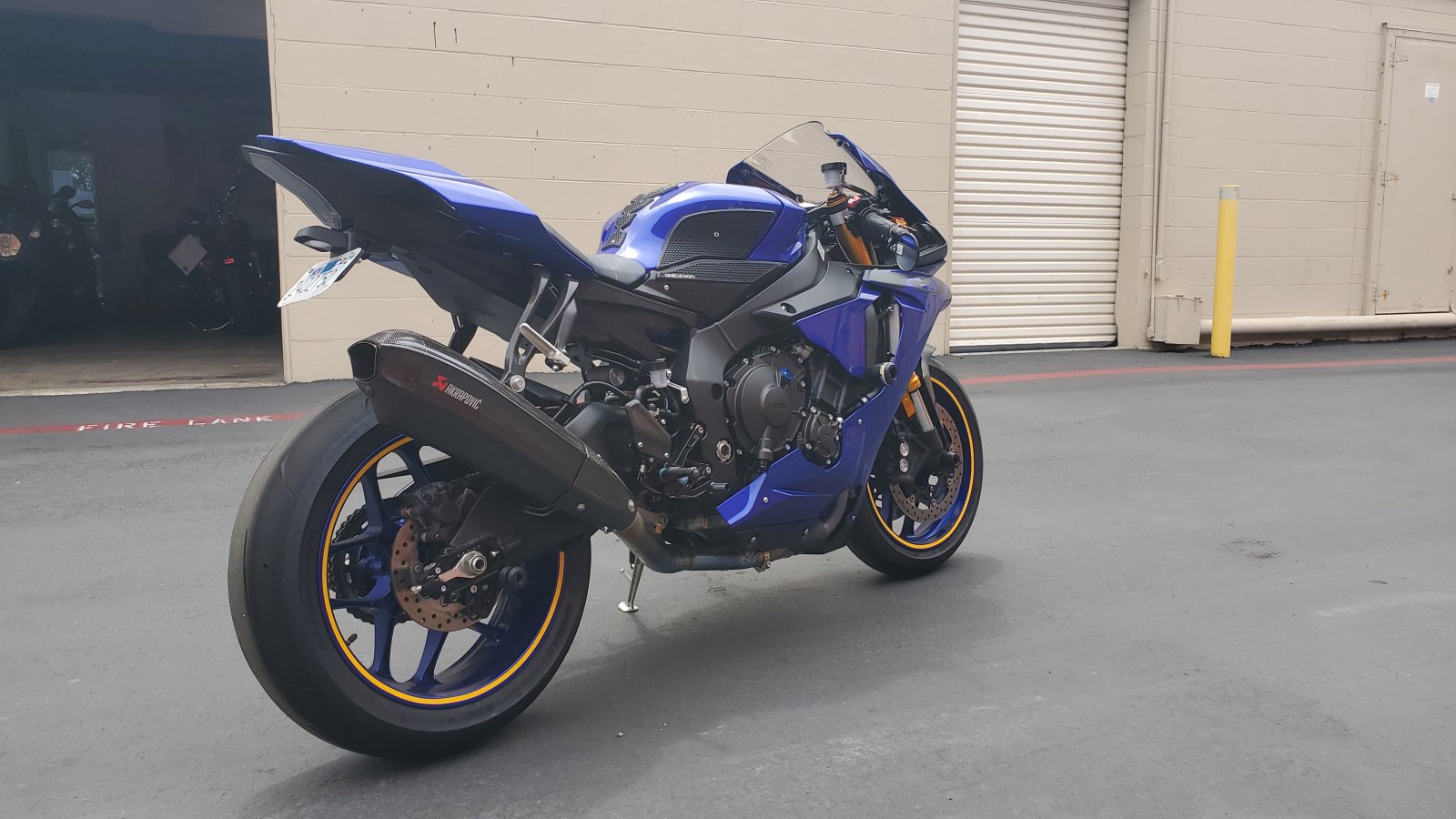

Welp, pulled the trigger today. 2018 R1, 13950 out the door. Full Akra evo carbon exhaust, frame sliders spools axle sliders, mirror delete, tank grips, carbon rear sets, crg levers, team yamaha blue. Seat has slight damage from a strap it seems, fairings on left have some small scratches 2700 miles on the odo.
Congrats mate, that looks beautiful :)
Thanks I cant wait to ride it... getting delivered sometime next week. I'll probably remove the silly wheel stickers, replace the seat... what do you guys think about vinyl wrapping (something classy, nothing outlandish) or should I look into getting the scratches repaired, or just repaint or replace the fairings?
