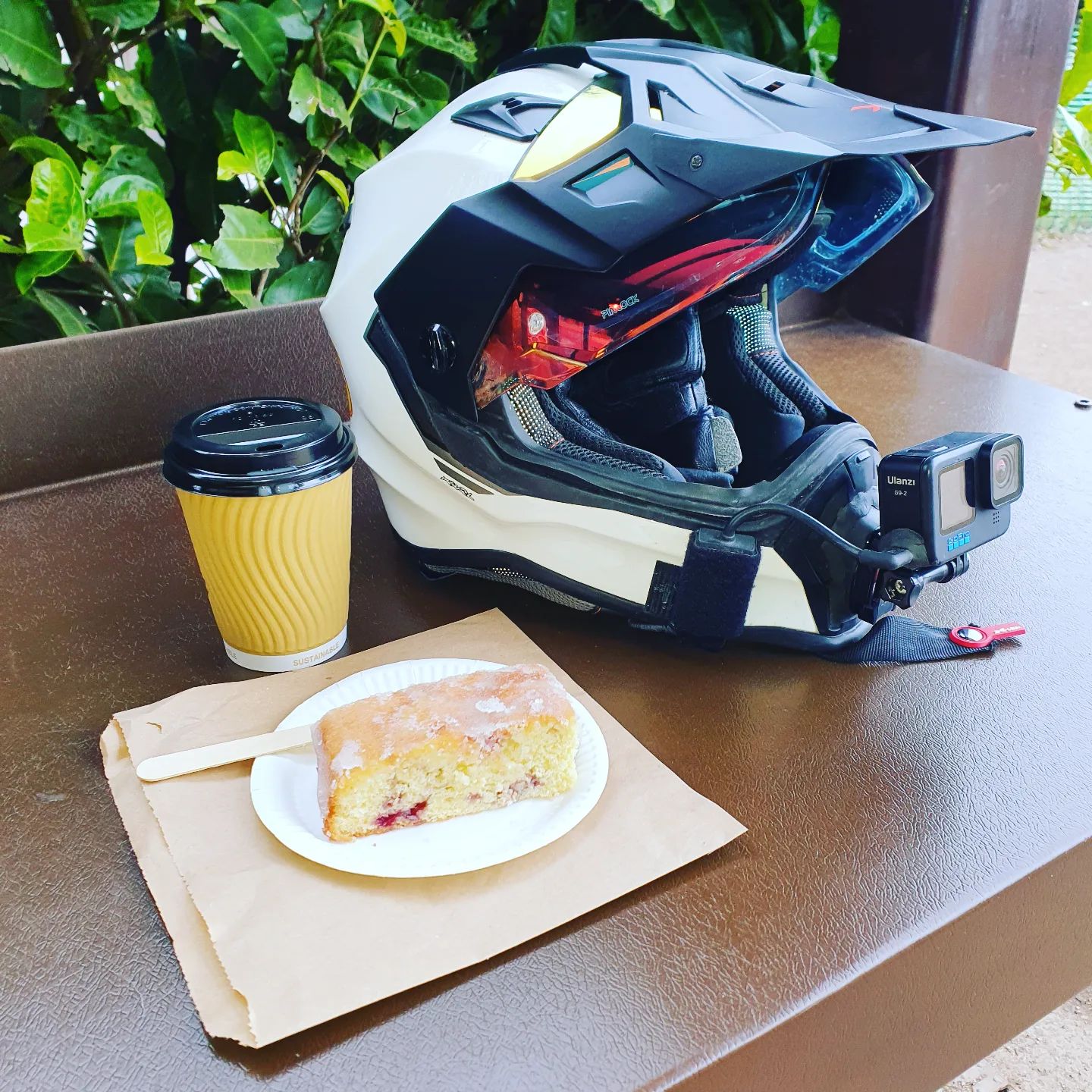

I personally hate the Media Mod, it is a nightmare to change batteries / memory cards when using it. I'd recommend using the microphone adaptor with the Ulanzi (or GoPro) door that gives access to the USB-C port
It is how I have run my helmet setup since starting my channel with a Hero 5, 6, 7, 8, 9 & now 10
