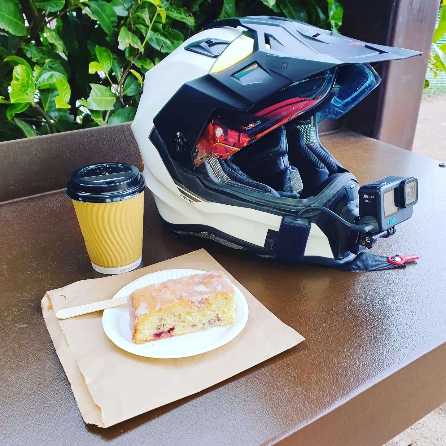

I'm a fan of the Media Mod. I use one for my Hero 10 on my helmet - but heck, the way my helmet cam is mounted, you can't get to the battery without removing it from the mount anyway, so it's only an extra few seconds to remove the Media Mod too. It's sort of a pain, but not too bad - I've done it hundreds of times on the side of the road.
As for water, I've ridden through light to medium rains before with it on, and it never caused an issue [knock on wood]... so I can't guarantee it'll be OK, but in my experience, it hasn't fried a camera - yet.
On days where I don't use up a whole battery, the whole rig comes off my helmet, sits on my desk, and I can download footage and recharge the battery without having to remove anything, which I like.
