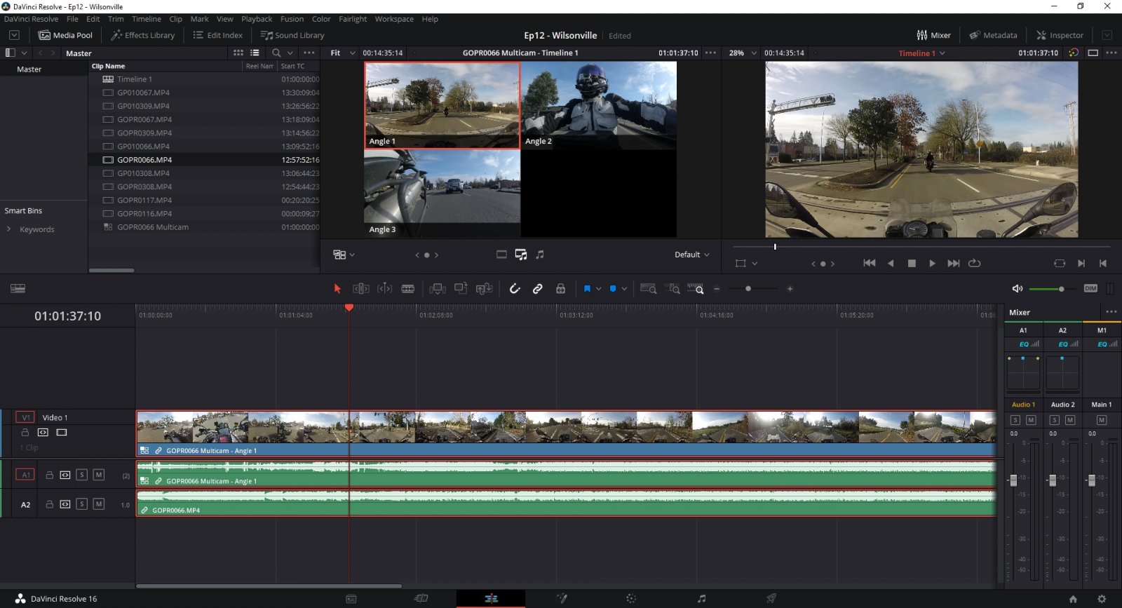

That is actually the problem. I don't want to switch audio, I want both tracks. I drop the multi-cam clip in with the in-helmet mic audio track picked, then drop the audio track for the engine noise in the timeline on a second audio track. Then I select all three tracks, and link them. Then when I go through and make my cuts, it cuts all three tracks so the audio stays in sync between my talking, and the engine noise.
Once the cutting process is done, to switch views I do the multi-cam edit with camera angle switching only, so I don't touch the audio when I do those switches.
Like you see in this picture, I end up with one video track that is multi angle, and 2 audio tracks.

OK. that is what I pictured in my head - linking the multicam with a separate audio track. I don't do that, since I have but one mic. My GoPro Hero 9 ATE 15 mins of riding footage today, which pisses me off (I *think* it's a faulty SD card, could be the cam, I won't know until I swap out the SD card), but the Hero 8 footage caught SOME of my voice but way too much wind and engine noise to be useful. I should run a mic down to under the seat or something for the 8 to pick up engine/exhaust noise. Until I do that, I'll just stick with the 1 multicam clip and no separate audio tracks. (for bike noises anyway)
