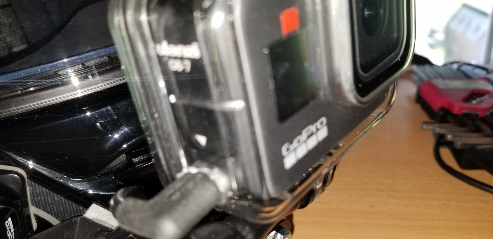

You could make it a bit more water resistant using a modified dive case and a Ulanzi door. Be sure to wrap a bit of tape where the plug passes though the case.
Also, tape over the USB-C port on the brick as well as wrap around the mic plug.
It will not be 100% water proof as the factory door, but it will keep most of it out. Just don't submerge it.
I ran the same design on my Hero4 Silvers and they are still alive and thousands of miles.
Can't do that with the 7 I don't think @R-Rated as there isn't a Ulanzi door for the 5/6/7... but you could use a dive case still! :-)
When I ran a 5/6/7 with the mic adaptor I used Blu-Tac or electrical tape to seal it up a bit better.
HerTwoWheels found out on her recent trip to Florida that riding in the rain with the mic adapter plugged in will fry your GoPro.
Been having intermittent issues with mine this weekend while we have been away. Its rained hard every day. I gave up and removed it from my helmet for some of the rides.
