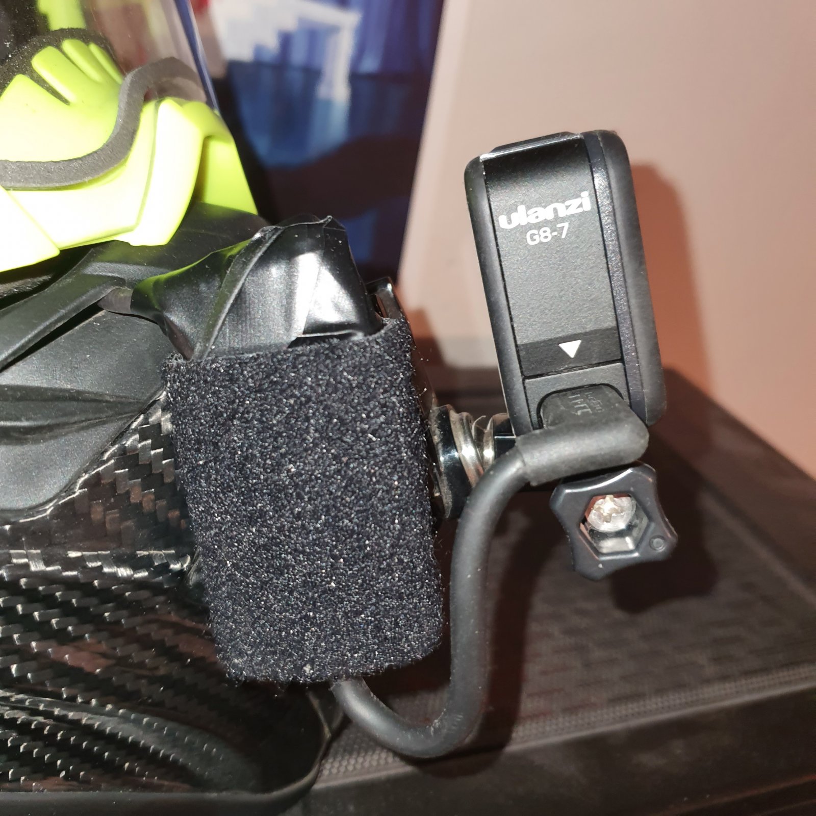

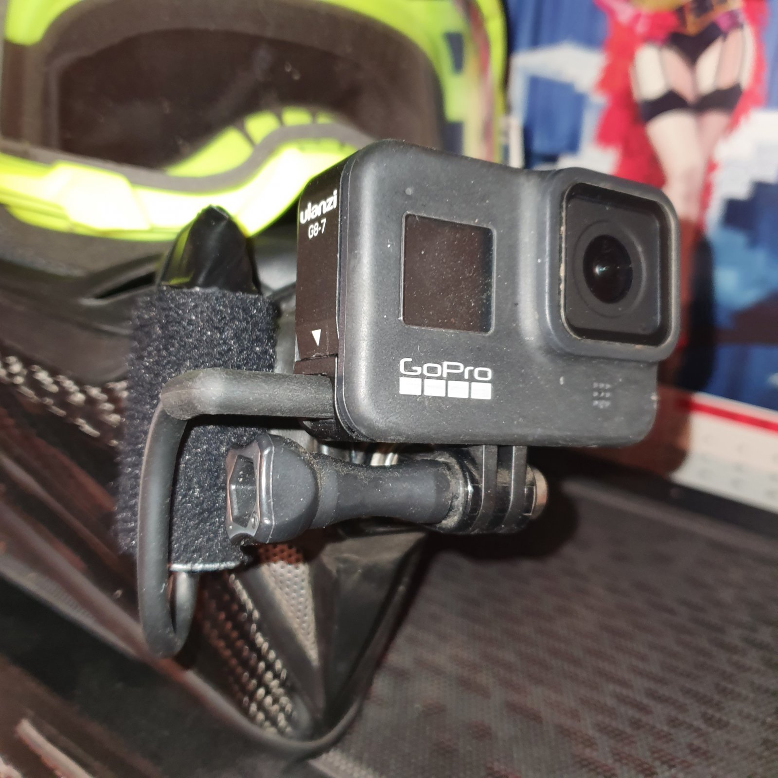

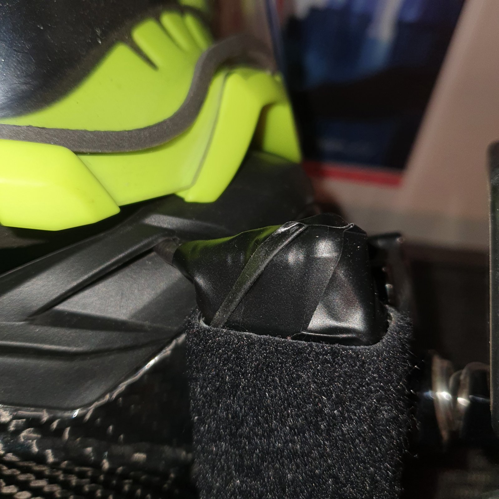

I don't use the Media Mod because of exactly that... and it is a pig to change batteries. For my dirtybike setup, I use a Hero 8 with the GoPro Microphone Adaptor and a Ulanzi GP8-7 door. I also use amalgamating tape to cover the open port on the mic adaptor and to tape around the mic jack to stop water getting in and the jack wobbling about. If it is a really wet day, I'll use blutak around the USB-C port on the Ulanzi door on the GoPro to help stop any water getting in to it.
