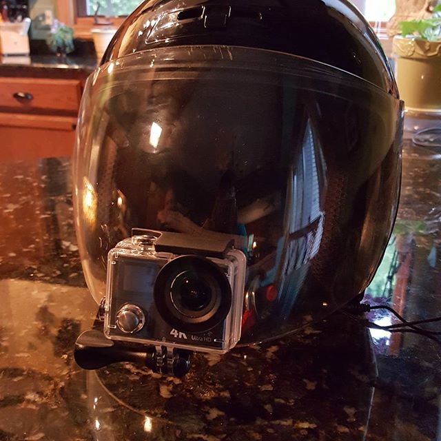

I dont have a chin guard on one of my helmets, so I put cam on my open face visor. No it does not block my view the cam is not in front of my chin but more in front of my mouth. The angle is perfect. I added the mic to the left side and clipping it on to the cheek pad or chin strap. See if that works.
