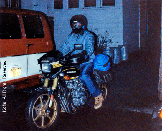

In the 80's, these hand covers were called Hippo Hands. The coldest I've ever ridden was 18 degrees Fahrenheit, when I was living in Brooklyn NY. I prefer not to ride in the cold weather, but sometimes you have no choice. Pic was taken in 1985, on my Kawasaki KZ-1000.
Hippo-hands are still around. I see motor officers use them which makes sense due to needing dexterity to write.
Reactions: Drakhen99
