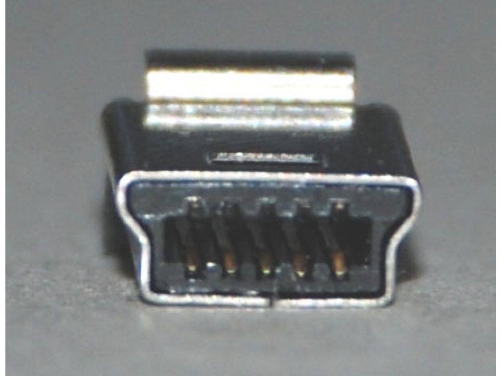

You can also get adapters for any 3.5mm mic for the GoPro, either GoPros own or 3rd party from ebay. If you go with the latter, make sure the cable is for 3, 3+ and 4, not just GoPro, as there is a difference. They had 5pin USBs on the 1 and 2, but 10 pin on the newer ones. You can identify 10pin USBs by the presence of 2 connector plates inside the plug.

VERIFY the pinout mentioned here. I bought two listed as compatible with 3 and 3+ and neither worked. Both were 5-pin. I ended up making my own.
Added a picture, this is how a 10-pin plug looks, the 5-pin plugs will be useless for anything but power and data transfer.
