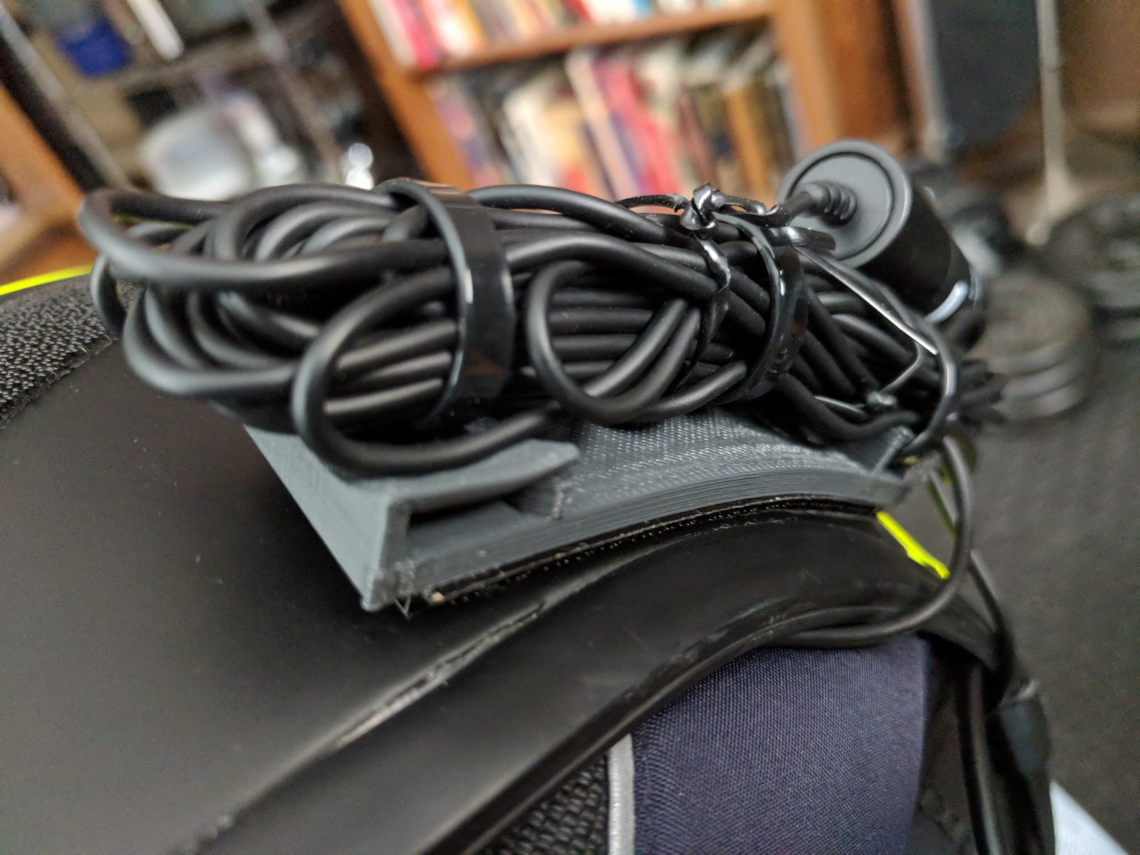

OK, here's what they all were:
A - Sena 20S mic + volume control
B - Sena 20S
C - Movo GM100 + volume control
D - Movo GM100
E - Audio-Technica ATR-3350 + volume control
F - Audio-Technica ATR-3350
