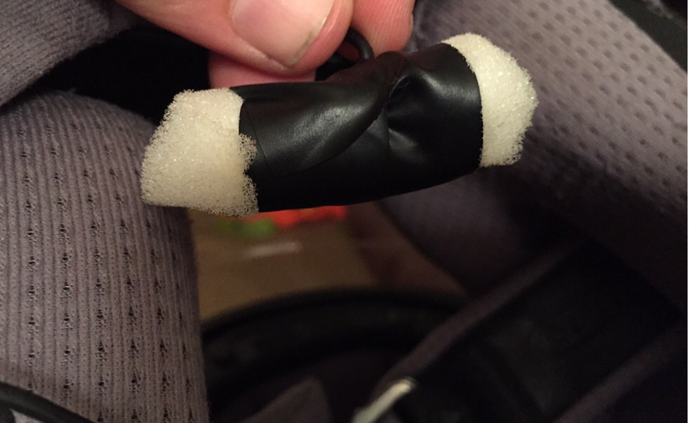

I have an AS100 with a Sony ECMCS3. I took the lapel clip off (yep, just snapped it off like a Boss!) and took a 1"x2" piece of foam (stole that from the wife's crafting supplies), wrapped it with a couple loops of electrical tape, added a piece of velcro to it and the other side to right in front of my lips in the helmet! looks like crap but does pretty good for me! Here's the amazon link to the $20 mic (got mine from amazon warehouse deals for $12 as an open box) http://amzn.to/1DQqEx2
You can check my videos to see how the sound and wind noise is for you. But here's a picture...ain't pretty but neither is the bike or myself..fits right in ;)
