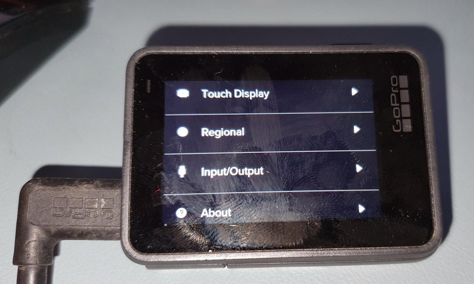

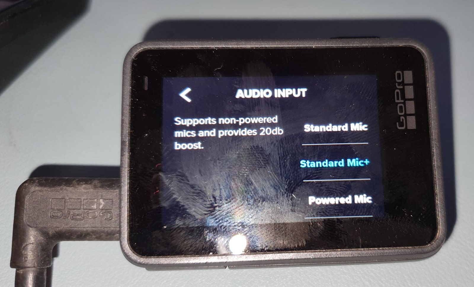

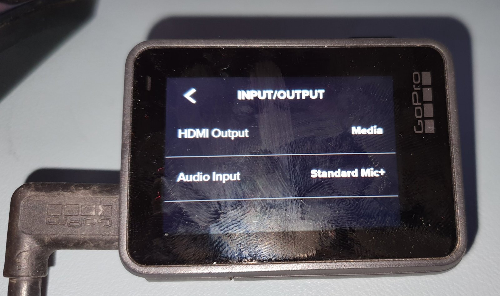

Check your camera settings too:
Yes I the official GoPro adaptor that my purple panda is plugged into. The purple panda came with the adapter for a 3.5mm socket which is what I’m using. When it comes to the GoPro itself I have the setting as standard mic. Should it be in standard mic+? What’s the difference?
Also, where do you put the mic in your helmet? I have mine towards where my lips are at the bottom of the visor. Is there a better spot for it?
Ht, I've found my audio to not work well on standard mic and works better on mic+ which seems backwards to me, but you may find it helps.
