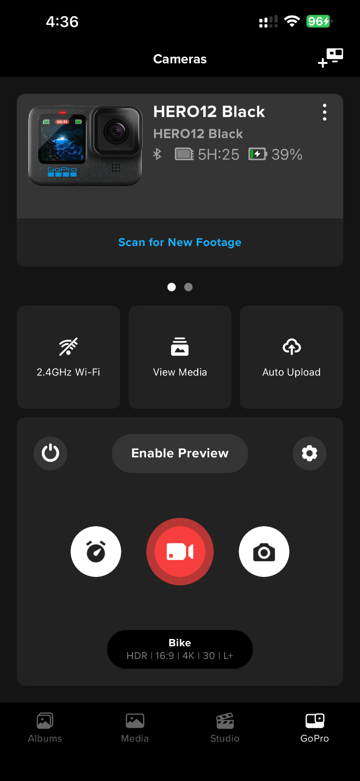

Well, If you see the pictures, and watch the clock on the top left, you will see that it drops the charge even when on a power source. I understand that the BT connection to my phone is turned on in these pics, but for the duration between the screenshots, I had turned it off.
Anyways, I reached out to the seller and he will take it back. Processing a return now.
