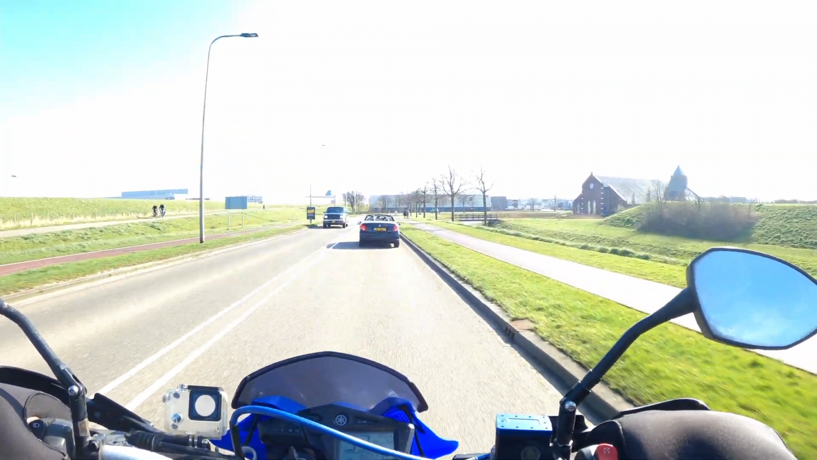

As i keep having troubles with overexposure, even after changing practically every setting possible...
I am thinking off going the road of GoPro ND Filters.
Ofcourse it is important to understand which ND Filter needs to be used at which moment, but that isn't the most difficult part.
Does anyone here uses ND Filters on their GoPro's?
Of have used?
At this moment I'm looking at this ND filter set .
But i'm open to suggestions.
Anything to help improve the quality, so that when it actually works, I can also use the footage :rolleyes:

If your over exposure is because of how the camera is metering the scene, and not hitting the shutter speed limit, a ND won't help, the camera will just open the shutter longer to compensate to get the scene exposed the same.
When you say over exposure, what do you mean? The full frame over exposed or blown out bright spots?
I think the ev comp is really the only setting that will effect this, and I really doubt you are at a point the GP can't physically make the shutter speed any shorter.

Everything is overblown. The sky is white, the distance is white etc etc.
Upping the shutterspeed from 120 to max did improve it quite a bit, but still some overexposure from the sky etc.
If the image is blown out too bright I'd maybe adjust the EV comp or ISO though. I run EV at -0.5 with ISO min 100 / Max 800 and it keeps everything pretty clean on video with or without ND filters.
Iso is in the exact same setting.
EV I think aswell, but i will have to check that out.

Meifesto I left you a comment on your video that you're talking about yesterday since i never noticed this thread, I'll repeat it here:
I just keep my settings on auto.
Also, since I don't know if Meify's allowed to post his own link or screen shot for illustration, I will :p
From his last video:

Another thing I'd be interested in is what your white balance is set at Meifesto. The sky and sidewalk, basically everything the sun is reflecting on is super blown out. Nd filters may help that some, but I think it's a little extreme to get a lot of correction from them.
4K, 30fps
Wide
Shutter; was 240 (changed to auto to test).
EV Comp; -0.5 (was 0.0 so changed now to test)
White Balance: Auto
Iso Min: 100
Iso Max: 800
Sharpnes: Medium
Color: GoPro

Shutter set will cause your problem. Test with it on auto. As you have noted in your last post. I think you will see a big change. If you are set on manually setting shutter, you need to set it when you start recording. In bright sun, you could need a very fast shutter. But you can only find the right shutter, shot to shot. I think auto shutter will solve your problem.

Recorded Saturday with most settings back to auto.
Kept these the same;
EV Comp; -0.5
Iso Min: 100
Iso Max: 800
Sharpnes: Medium
And it seemed a whole lot better.
(Newest video on the channel).
So, with auto shutter en white balance etc he seems to keep it nice and watchable.
If I ever intend to limit the shutterspeed, I will have to invest in ND filters, but i can move that to later this year now.
Helps to spread the financial costs a bit :)
(still need to fix mirror, windscreen and rear light)

I’m a bit late to the discussion here, but I tend to leave pretty much all exposure Settings on Auto except for the ISO max. Which i smash down as low as possible. On a sunny day, 100. On an overcast day 200 and when it’s grotty, maybe 400 if i can get away with it.
Messing with the Shutter speed is a fools errand because as soon as that’s fixed, the camera will monkey about with the ISO to keep your exposure good. Which means lots of noise and loss of sharpness as soon as it gets a tiny bit dark, say in the trees.
When you leave the Shutter on Auto, but get the ISO locked down (and without ND filters, 100 iso is plenty in daylight) then it’s the Shutter speed that gets changed to keep exposure in the zone. And then the worst that can happen is you get a bit of motion blur as your shutter speed begins to approach your framerate. It’s also possible that it might get a bit dark in tunnels etc. but you can push the gain in post, which is essentially all the camera does with high ISO, so you’ve lost nothing there!!
