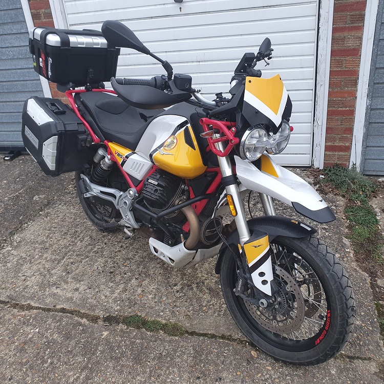

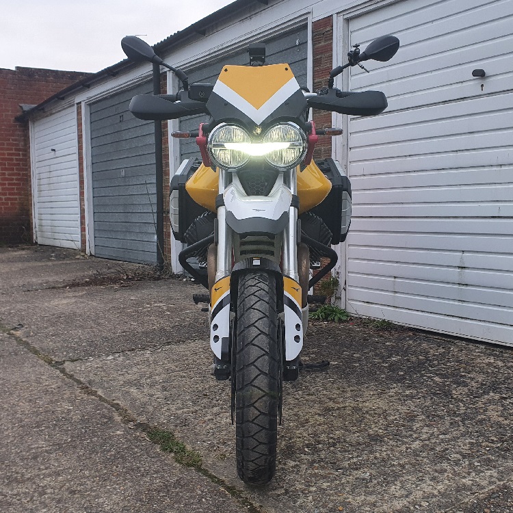

Front Cowl for my Moto Guzzi V85 TT
I have been struggling with wind noise and buffeting on my V85TT so have made a front cowl to replace the OEM screen out of an MX front number board! :-)
I also attempted to vinyl wrap it, which looks ok from afar, but less so up close. I'll redo that at some point as I am also not too keen on the design I put together.
Will be testing it in an upcoming video! :-)

Looks great in the pics! Did you use the mounting hardware from your OEM windscreen?

Yup, I drilled 4 holes in the plastic cowl and mounted it to the screen mounts. I used a heatgun to reshape the cowl a bit too after cutting out the circular bits for the lights :)
