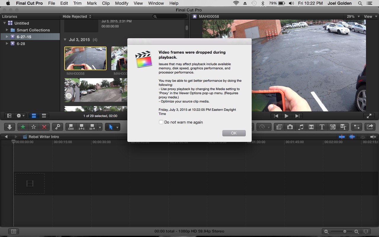

guys, I keep getting this pop up after importing and trying to preview a clip. What import settings should I have and what other settings did I mess up cause it worked last night.
a lot of searching and I came up with: click the don't show again box and adjust the drop down menu in the upper right corner to better performance (not better quality)... good to go now!
That also only affects the playback from the preview, when you export you won't have any droppes frames.
I'm on a mid 2010 MacBook Pro 13"....upgraded the ram to 8gb, that helped quite a bit too. Still new to this whole editing thing.
I've got a late 2013 13" retina, the entry level one. Quite often the preview drops frames but the output is fine, despite sounding like a jet is going to take off when rendering multi cam multi clip vids :)
