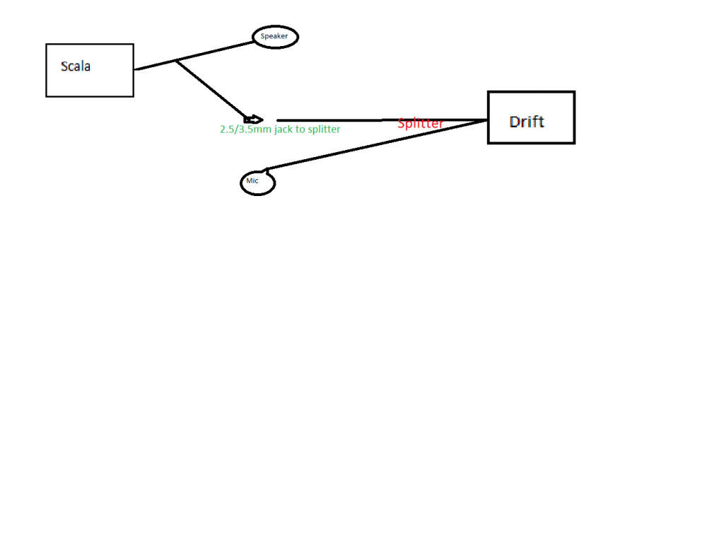

Ok, so I want my scala speaker output to feed directly into my drift microphone input while still having the mic pick up my voice. I tried to directly splice wires from one speaker to the microphone, but in the drift recording, the speaker output was very loud (distorted even), and the microphone was extremely quiet (ie my voice was recorded, but much quieter than usual). I figure that the powered output of the speaker is overpowering the normally unpowered drift mic.
So I figure I need a resistor of some sort to restrict the speaker output. ie scala-->speaker-->resistor-->drift mic<--drift
I dont want to know about placing a second drift mic next to the scala speaker, I want to know if what I suggest can be done.

if my junior levels of electronics (im a lighting guy :\) are anywhere near correct then i would say you would need to completely separate the two signals and rewire them together. the cheapest and easiest way to do this i believe (once again lighting tech not audio/speaker tech :\ ) would be to use an audio splitter. i havnt personally used a scala before only seen them on other peoples helmets so i dont know the connections and plugs bases but you could split the scala speaker cable to a 2.5 or a 3.5 jack depending on the drift you have and then use a splitter like.
http://www.amazon.com/Belkin-Speaker-an ... e+splitter
these generally split the input/output in such a way that the two signals are equal. it could also be easier to reverse this and put the splitter into the scala. i dont know how the scala plugs though. but once again i hope this works and if someone could tell me how wrong i am (if :]) that would be awesome!
goodluck man
what you have drawn is exactly what i tried first, but the sound level coming from your "2.5/3.5mm jack to splitter" note and the mic are vastly different, so all the drift hears is music/chatter from the scala and a tiny faint voice from the mic. I need to somehow balance the sound level.
