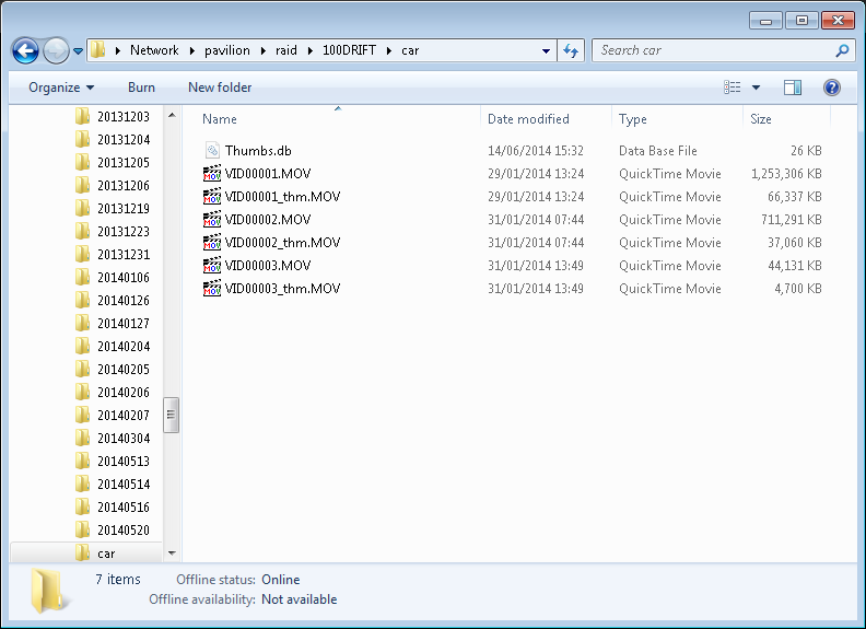

have the same problem!
and i always get 2 files? one good file and the other pixelated as hell...
is that normal?
is that normal?
This is a complete guess with zero research, but I think the 2nd low quality file is the one that is played back on the little screen on the camera itself when you preview a video. The _thm bit makes me think of thumbnail.
is that normal?
Like this?
The low-res thm file is streamed to your phone when you play back footage over WiFi. It serves no other purpose and you can delete them if you don't use the phone apps.
