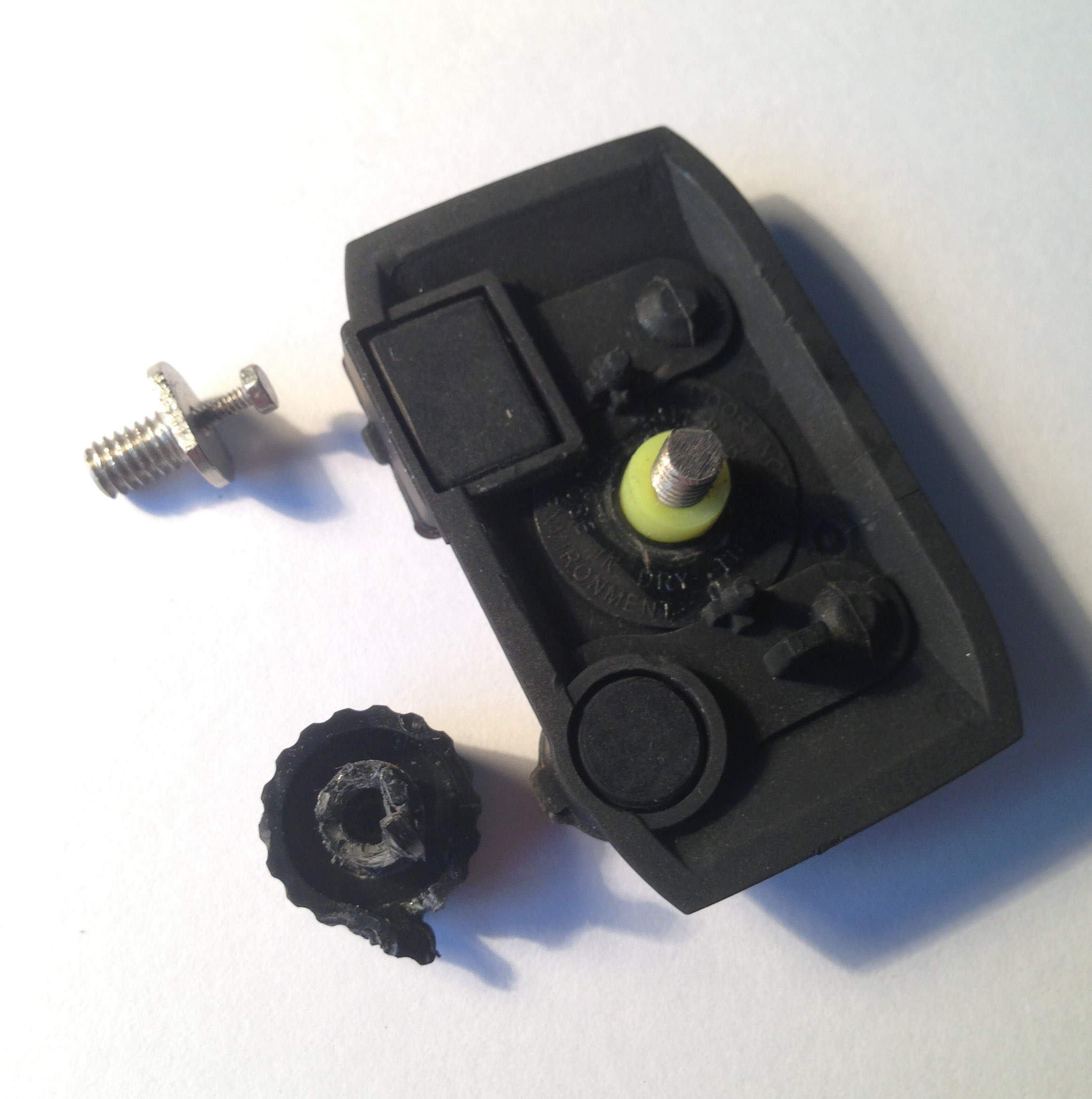

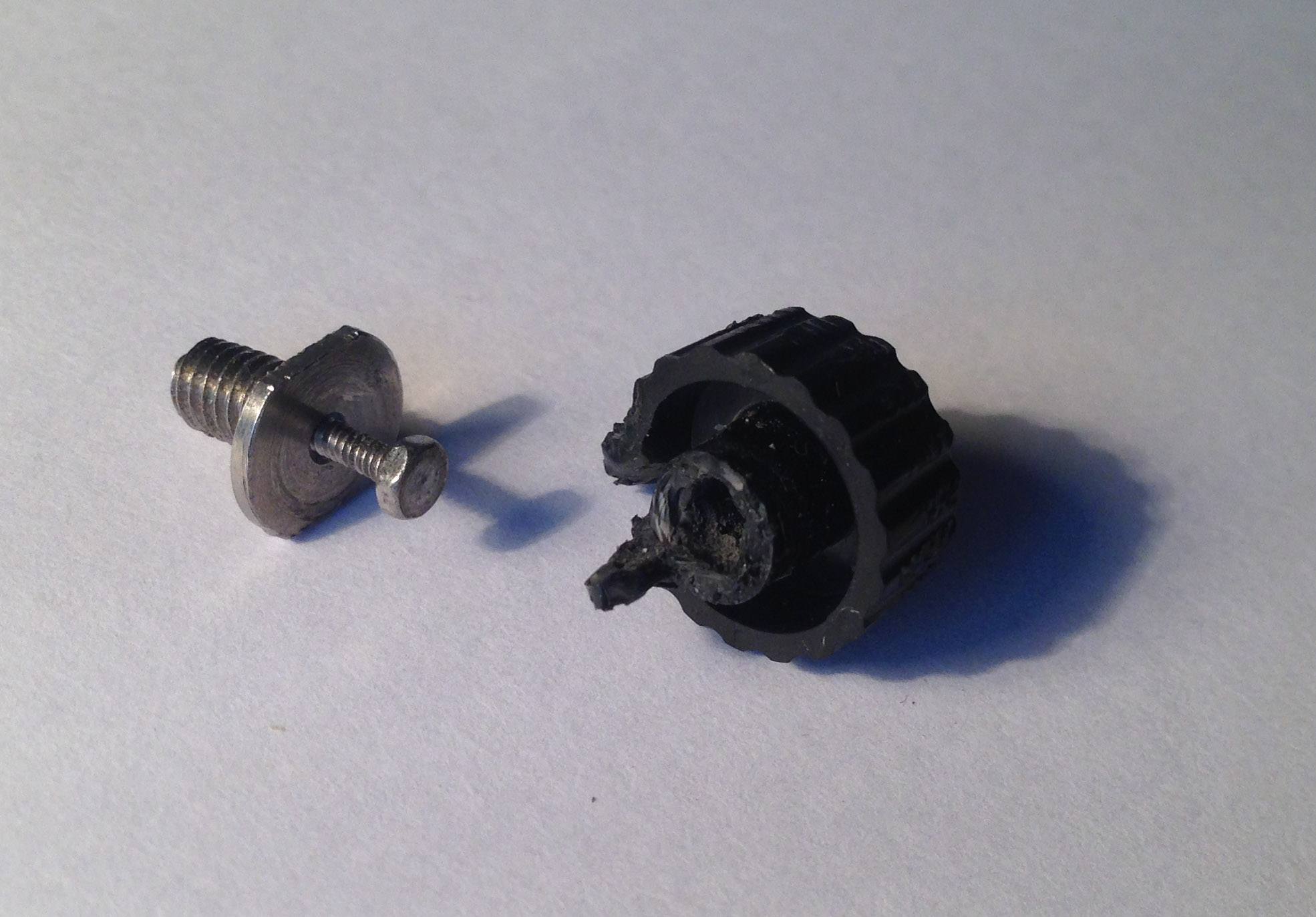

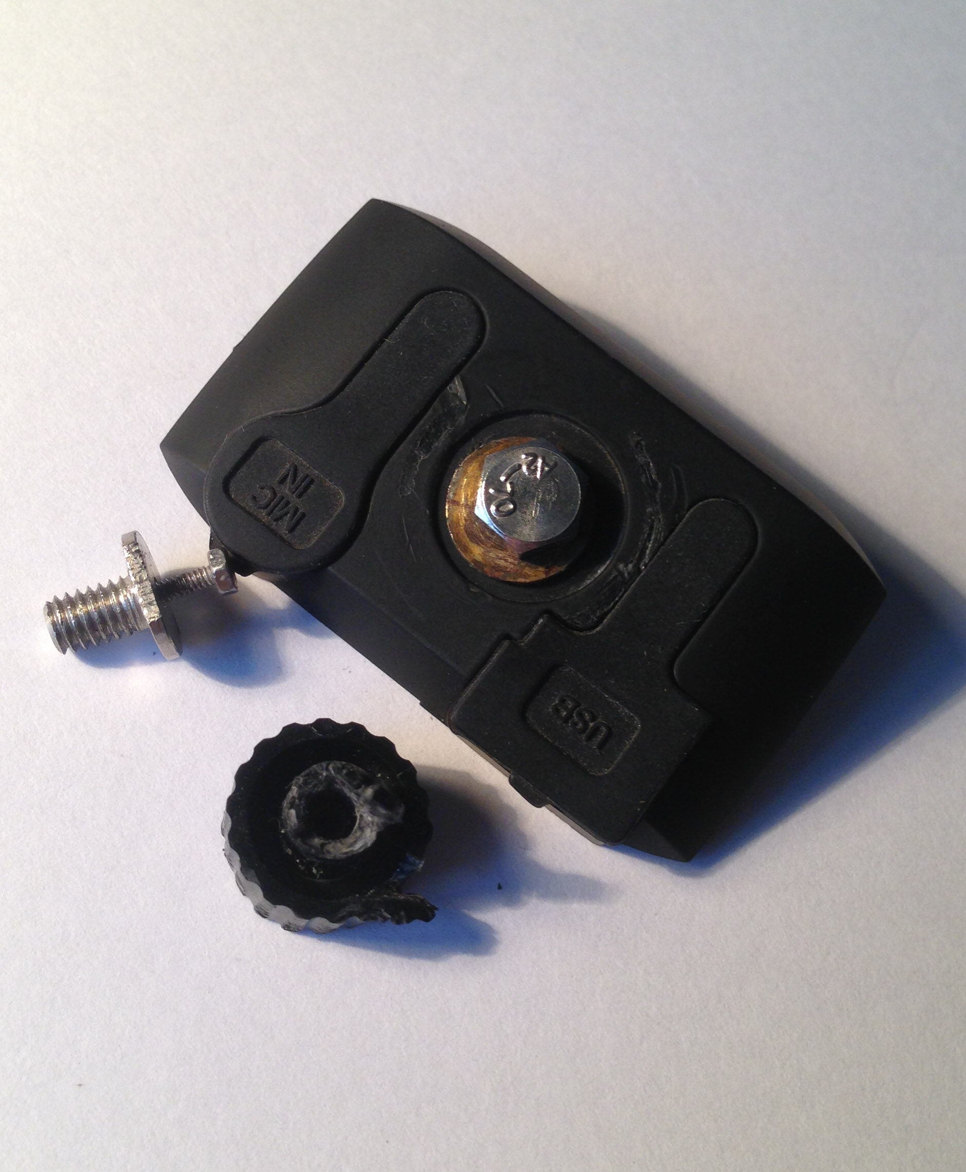

Right.... Drilled another 4 slow revs or so.... Bloody knurl section is only held on by another couple mm of plastic... The central shaft is still there, got the cover off .. YAY!!! And the main bolt out of the camera chassis YAY!! ....Pinching the rest of shaft off with pliers .. Hmmm
o_Oo_Oo_O .... :mad: .... Ok now I'm mad!! ... No.... MAD !!!!!!!!
... Sheer fucking brilliance!! NOT .... The central flat head ... Is indeed a tiny bolt hex head .... The 3/16 Allen key ... Which fit snugly down the shaft ... Which is MEANT to be the grip shaft .... Is visibly bigger then the bolt head .... So ... It quickly wore through the loose fitting corners of the shaft and just spun!!!
I'll go to a mates workshop next couple days and get him to put the vernier calipre on the bolt hex head.... But on a scale kinda thing.... A 7/32 head in a 1/4 hex hole ....
Some fucking monkey in a production shop ran out of larger head bolts (with same small thread diameter) and just used 'next best thing' ????????

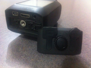

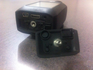

Hey Janxy, are you talking about this back:
View attachment 759 View attachment 760
If so, then there appears to be two possible reasons why your knob spins (Porno Exorcist anybody?).
Either the black knob on the outside of the hatch has come unstuck from the bolt, or the nut has become unstuck from the door that holds the battery in.
Easy answer, send it back to Drift. But, if you don't mind getting your hands dirty...
Break the knob off with some pliers so you get to the other end of the bolt. Then undo it. If that works, yay. If not:
Its the nut that's loose in the door. Send it back to Drift.

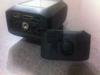

I just removed the factory bolt and plastic nut and replaced it with a basic bolt and spacer. I will shoot a video and post it later this week for you all to see how I solved the dreadful GHOST S issue with the rear cover.

I am struggling to edit my video in iMovie 'cos the bloody thing would not show preview of clips. Instead of showing the content, it just shows the black screen with audio. So, I decided to upload photos and show you guys what I did with the rear cover. So far, so good. Sent these to Drift and looking for replacement cover.
