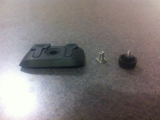

Just played around with my back, and found this:
The knob screws directly into the back of the bolt. So if your knob is spinning it means this thread is stripped (unlikely), the small bolt in the knob is spinning, or (as before) the nut is spinning in the battery door.
Not sure how this helps.

Ok ... After levering up the edge of the hatch with a tweezers blade.... The sleeve/bolt of the thing with the flat sides that you pictured above ... Is NOT rotating if I lower the hatch and turn the knob ... Can you confirm if that sleeve rotates with turning or not?
Haven't tried doing it with hatch wedged up though.... Gonna have to dig my mini pliers out of the shed in a sec ... Wedged up I can't turn the know with just fingers... Too much tension on it....
Which is another reason I'm puzzled about possible stripped thread.... Amount of pressure I have on it now 'should' pull the inner screw out of the sleeve if it were stripped.....
Pin-hole. That's it. As soon as I typed it I knew it was wrong but didn't know what the correct thing was.
The thing with the flat sides does rotate with the knob.
Ok .. Cheers.... Mine does not .... At all ... Currently ... So ....it's potentially cross threaded/jammed ? ... And the inner screw OR the plastic head is free spinning .... Money is on the plastic head still ....

Hmmm ... Ok .. The central 'button' of the knob .. Is just that , a button/cover ... Could not get enough pressure on it to lever it out but Drilled into it and it's only a couple mm thick .... Inside that is a hex channel/hub that goes down to a smooth flat metal end of the bolt .... :mad:
I can easily see now that the head is not turning as I rotate the knob outer.... So it's that bit slipping .. The pain in the arse now and the problem ... Is how to secure the smooth head into the plastic knob OR get something to physically rotate the bolt? ...
The access shaft is so small and narrow I doubt I'd ever get enough pressure onto the head to turn it....
But if I drop some glue or epoxy in there ... And it DOES NOT bond to the head.... Then I have a blocked access shaft!!
Why..... WHY didn't they just use a hex head mini bolt to snugly fit into the friggin shaft hole?? ...
I'm gonna have to go to Drift HQ and crack some heads together!!! ... Oh yes I could send the camera there and they fix it..... Or some such... But it's the stupid FUCKING design that's shitting me!!! .... Fucken CAD geeks!!
