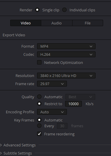

I would use a higher bit rate. 10000kbps is pretty low. I've also found h265 gives a smaller file for the same quality/bitrate , YT recommends 44000-56000 bitrate for 2160, but I tend to go higher than their recommendations.
This is how it is when i open the project.
And it looks the same as when i rendered it.

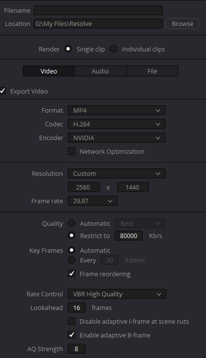

With that resolution, try changing the Quality restriction to something like 80,000.
I am using the Studio version of Resolve, so I have the "Encoder" option too, but this is what my settings looked like before switching to H.265. I found an appreciable difference up to about 80k in the Quality restriction - after that, I couldn't tell. I also render at 1440 res instead of 4k - I mean, I'm shooting at 1080, so it's already scaling up anyway.
