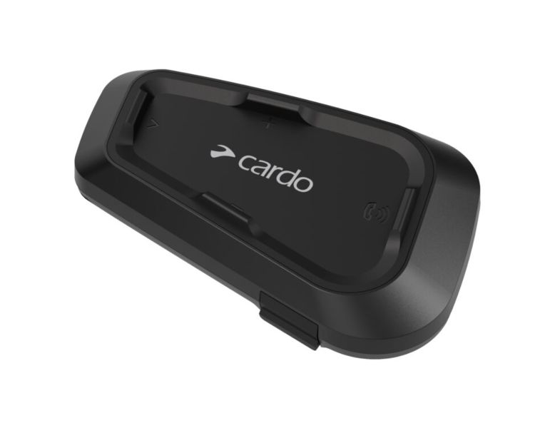

So I picked up a Cardo 2 wire headset. Just the basic one called "spirit HD". I need it in order to access options on my bike like on screen GPS etc. I don't really need it for communication with other riders, although the option is there should I need it.
What I really would like to do is use the headset mic which I've installed in the helmet, to record onto my Hero 7 Black using bluetooth.

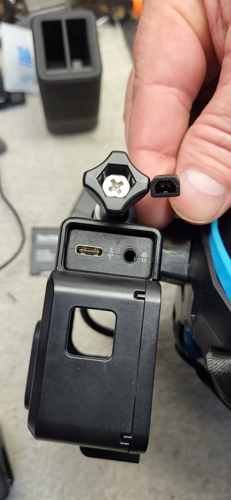

The mic that came with the headset has a 2 prong plug that connects to the headset, so it will not fit directly into my Ulanzi mic adapter without some sort of adapter, which I have been unable to find anywhere.
I tried using the gopro app to connect to device but it just says "you need to be connected to the gopro app to connect compatible devices" Even though I am already connected to the app. Thats as far as it lets me go. No options to do anything else either on the camera or in the app.

Thanks. I guess that's how it needs to be done. I watched the video and it's done using adaptors that I can get from amazon. However, as I watch I see it's an excessive amount of wiring on the helmet and results in sub-par audio quality compared to a direct mic. It is also using audio signal meant for tiny headphones and not for recording audio, so it is seriously underpowered. It just doesn't seem worthwhile. This idea is plausible if you really want to record the audio chat of your buddies while out on a group ride, but since I don't really need to do that, Now I'm leaning more toward simply having a second mic inside the helmet.

Update: I have 2 mics now set up in the helmet with minimal wiring all tucked under nice. Far less cords and cables than the other way. Looks neat and tidy, has the best audio and seems to be working properly. I guess you can't bluetooth to a gopro. The only thing you can do is bluetooth to their app on your phone, where they want you to pay them to upload your footage. I'm doing just fine without that thanks!

1) Crazy cable work with a Y-cable and stereo to mono splitter. Has the best audio.
2) Two mics in the helmet. Redneck method, wouldn't recommend.
3) Sena 10C Pro or 10C Evo.
If you just want to record your spoken words without the sound YOU hear from the intercom, try combining a Cardo Spirit HD with a Insta360 One X2. I've done it, works. Sometimes it's a nightmare to connect or pair, which is why I've ditched it again. Sometimes they connected automatically, sometimes I had to repair them. It happened a few times that I was standing in the driveway, full sunshine, faffying with the X2 for over 5 minutes to finally get it connected. That and the fact that you cannot use QuickCapture during riding. They always need to be connected before recording.

Audio quality will always be superior if you take the signal directly instead of recording it from a tiny, tinny speaker into another probably low quality lavalier mic.
