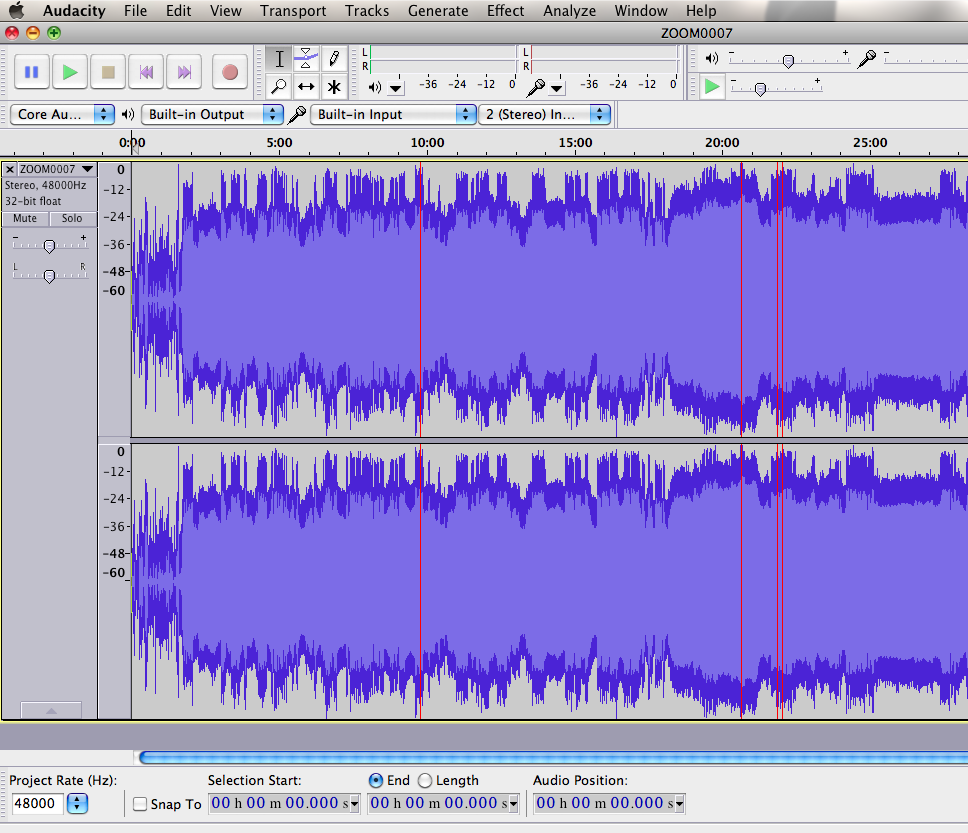

The first screenshot is the raw audio track from my Zoom H1 connected to a lav mic. (Red lines highlight where clipping is occurring)

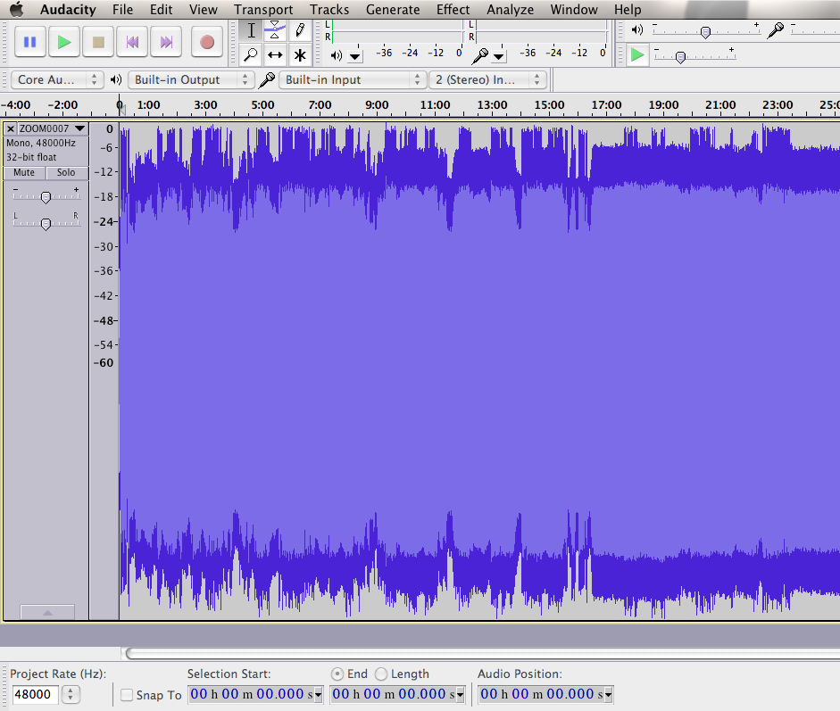

The final processed audio track (no red lines means no clipping), the peaks approaching 0db are while I'm talking. The background noise of the engine sits at around -10db. The aim is to get your voice waveforms approaching 0db to make sure it doesn't sound quiet.
Hope that helps, I'm by no means an expert, but I've learnt most of this from watching podcasting audio tutorials on YouTube since a motovlog is pretty much a podcast but just on two wheels!
