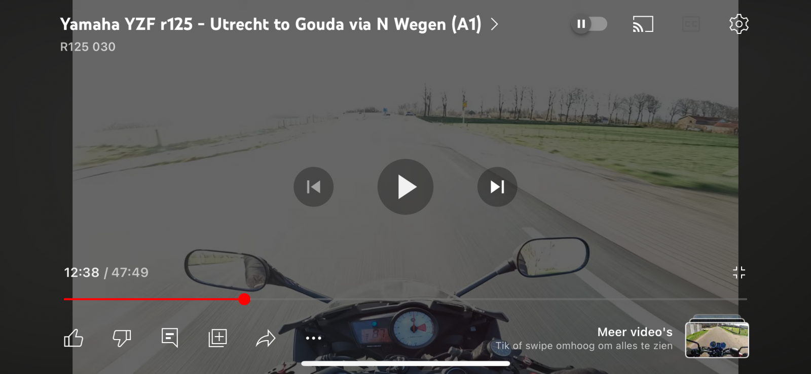

Hello, does anyone know how to fix this next time i record? I think its simple but i have no experience (gopro 10). Thanks!

Hi, without knowing what settings you are using, it is a little tricky... but you could put the camera back to factory settings or go with the setting I use (which are pretty much stock...
BitRate = High
Shutter = Auto
EV Comp = 0
White Balance = Auto
Iso Min = 100
Iso Max = 1600
Sharpness = Medium
Colour = Vibrant
And then adjust to get the full look you want.
I had my Hero 8 Black do that suddenly out of nowhere. It shot fine in the shade and when the sun hit it, it washed out.
I had changed nothing before shooting and wondered if it was something in the environment that caused the camera to glitch. I have not been back to that place and have not had it happen again.

Yeah, it definitely looks to me like an EV Comp setting issue. Unless you've got fixed shutter speed or ISO, that is.
If you just exited a tunnel or overpass, that'll happen as the GoPro adjusts its sensitivity, and should go away within a second or so.
I agree with @HippoDrone - reset to factory, or at least check your ProTune settings as he suggested.
