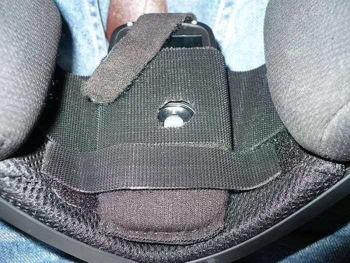

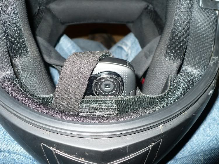

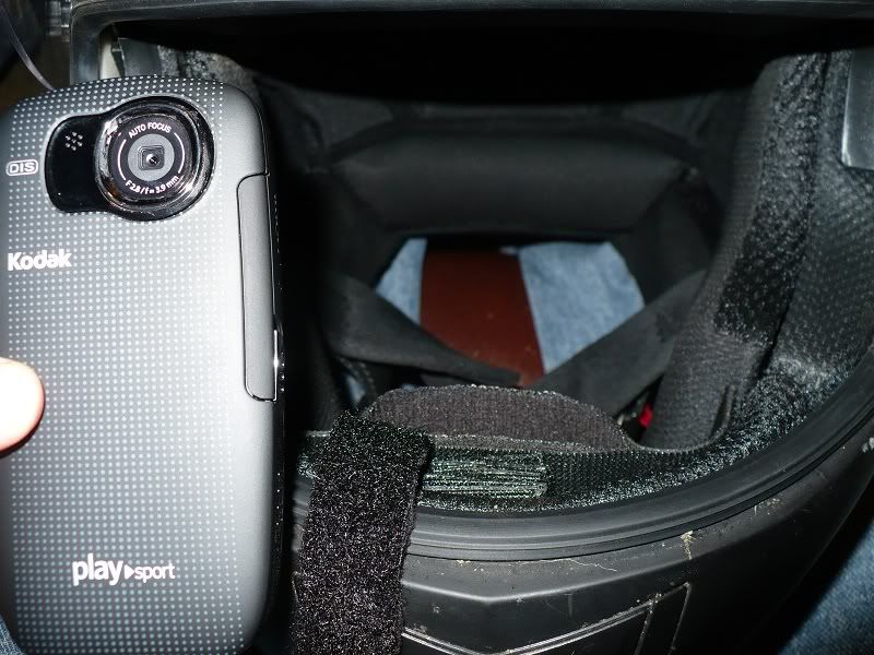

Here is a copy & paste from another post where I showed my camera mount for my playsport which is pretty similar to your bloggie.
Here are a few pics. My main goal in mounting it was keeping the camera unmodified and I didn't want any velcro on the camera itself.
I took a childs black dress sock and cut off the leg cuff and stitched the bottom closed. Wrapped it with velcro and cut a hole for the record button. Stacked some velcro stuck together for the correct angle and made a little strap that goes over the top to hold it in the pocket.
