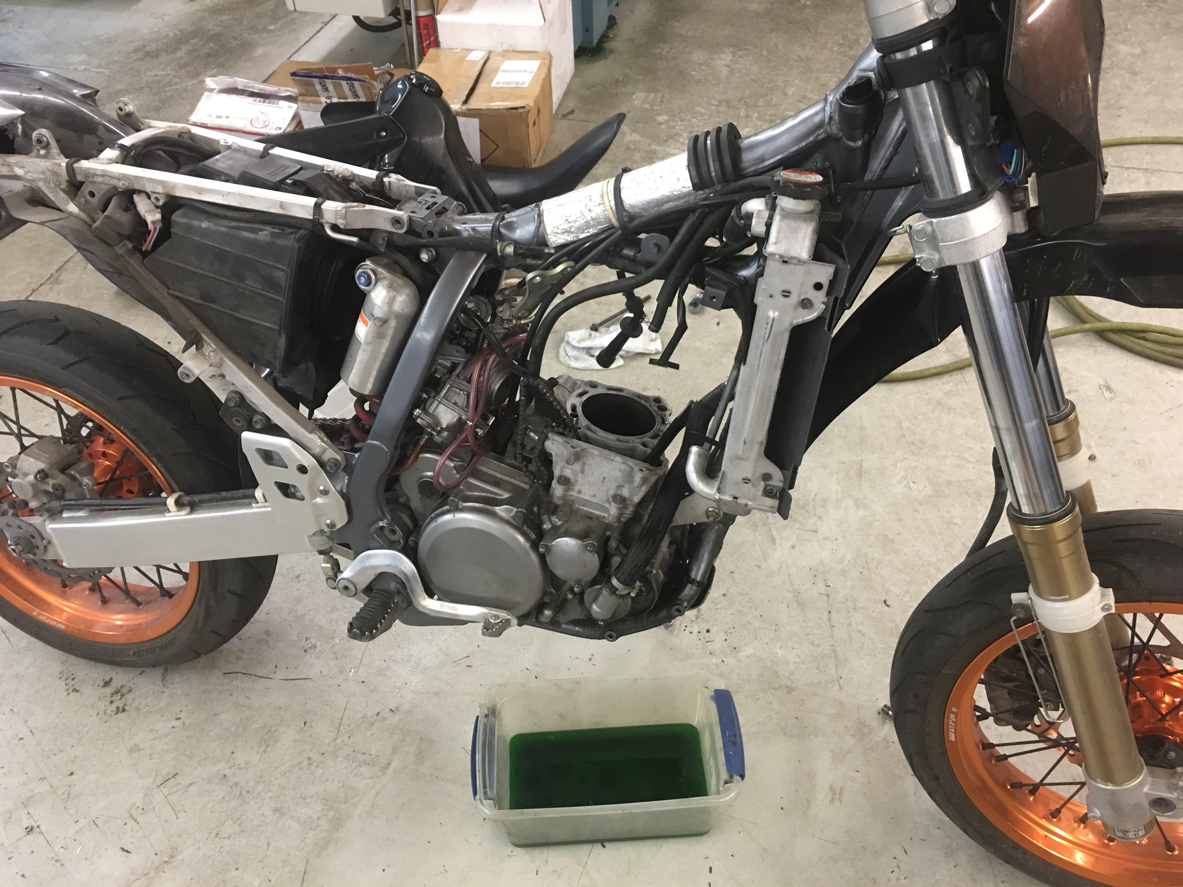

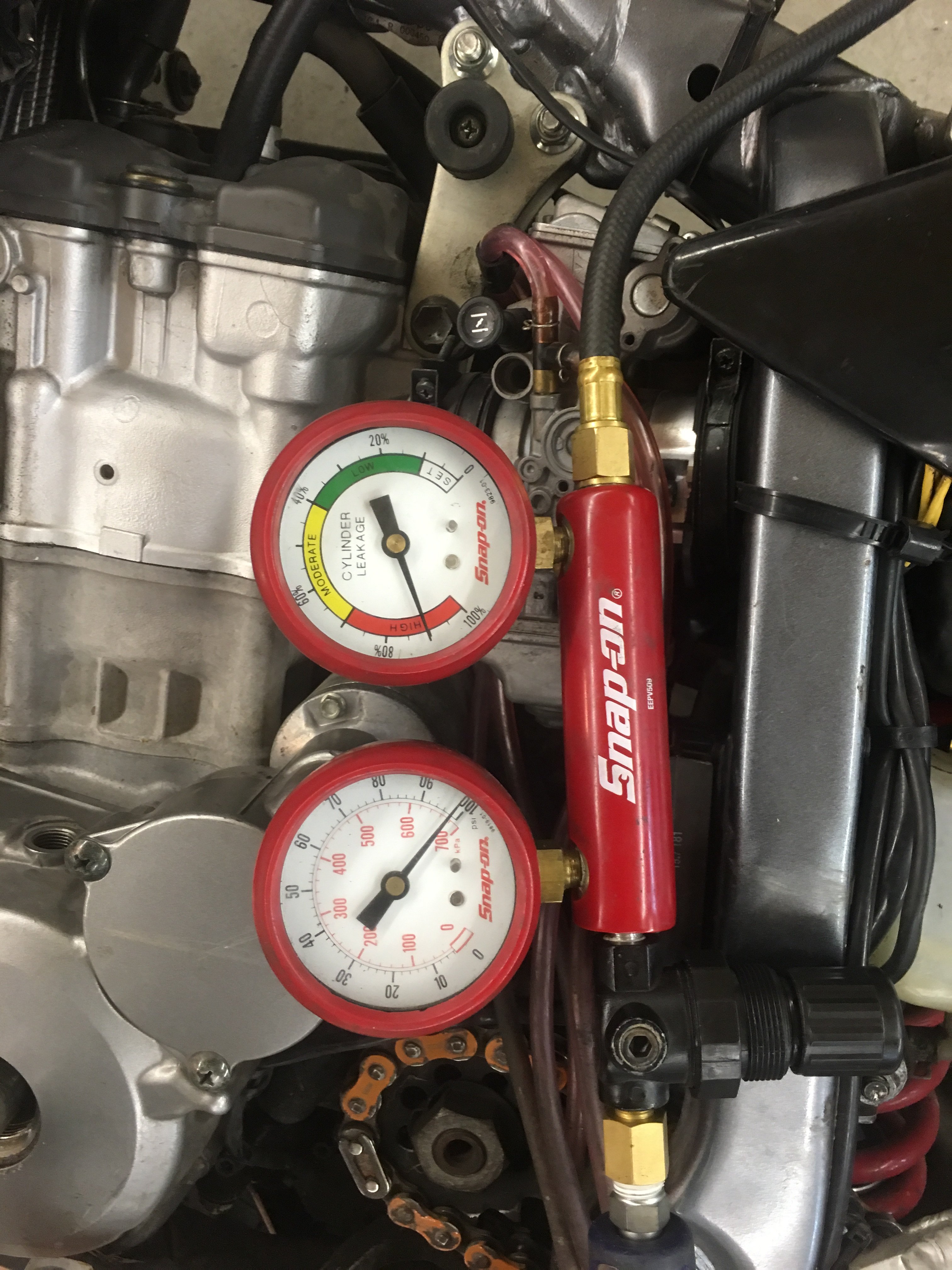

  • So last night my bike wouldn't start after I slid down a hill climb. Did a leak down and lost 90% so pulled the head. Looks like I'm forced into putting my big bore on
Web cams already ordered with a custom grind along with +1 valves better spring kit and my head will be ported and new seats and guides in 2 weeks.

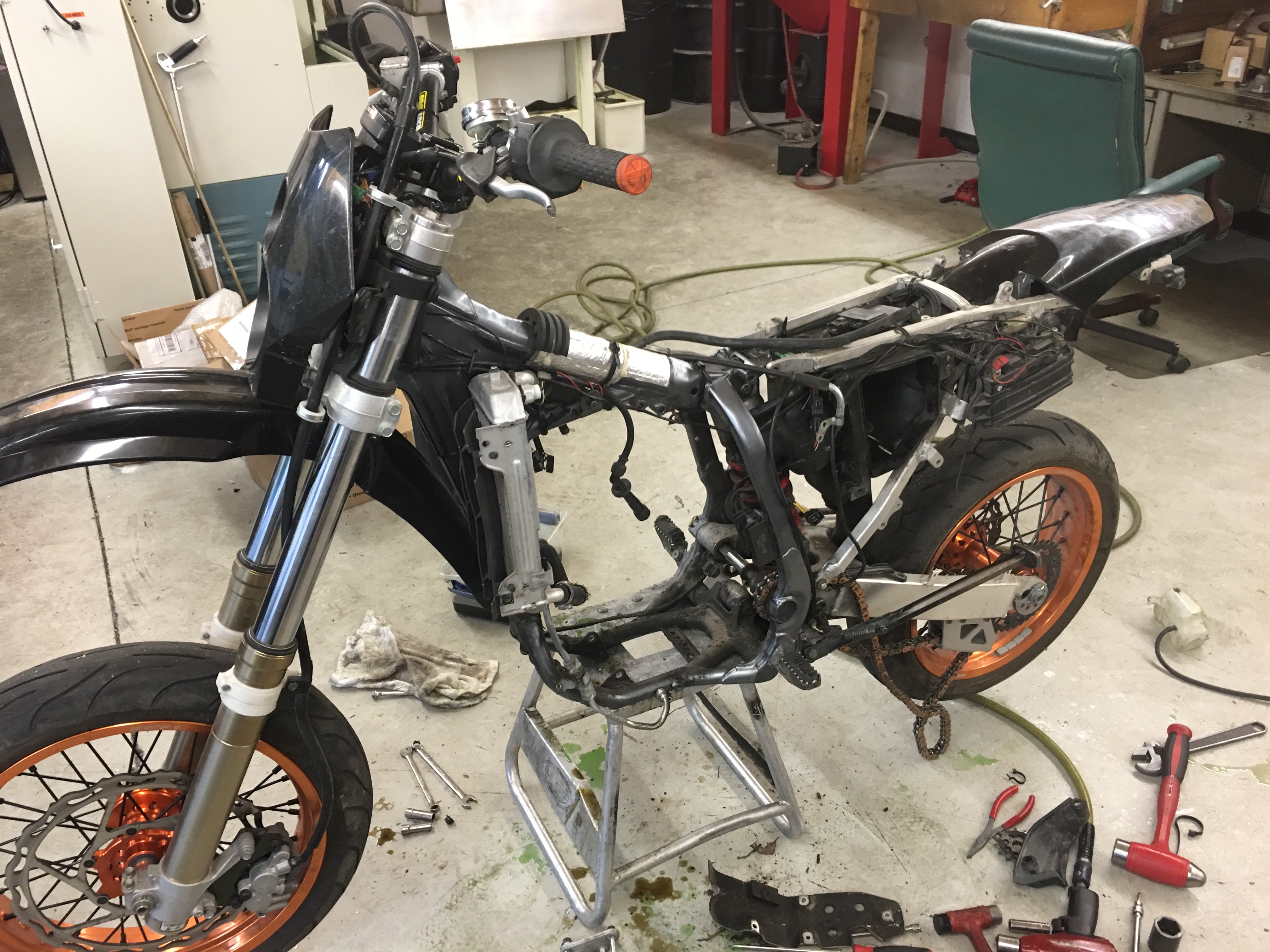

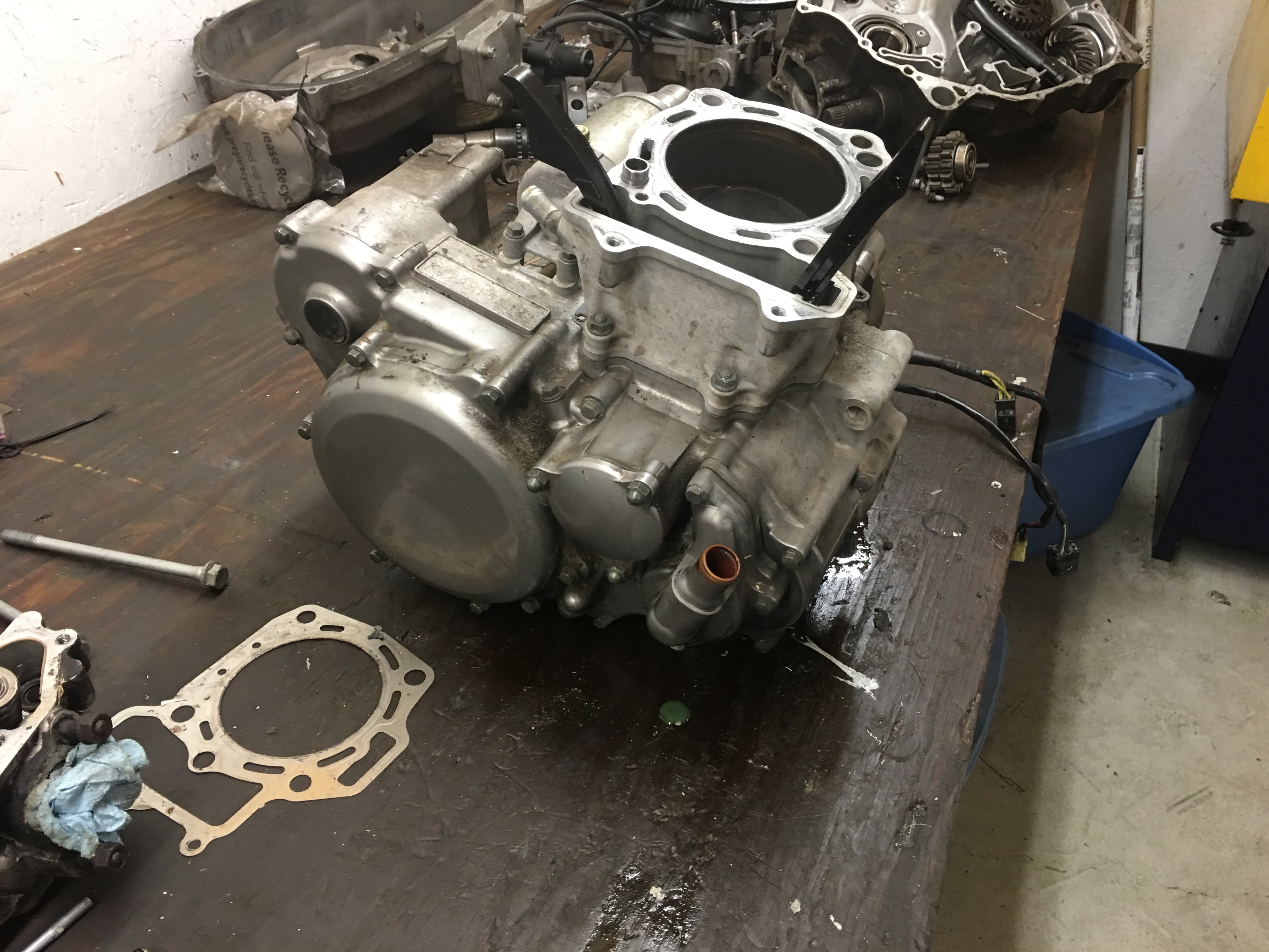

So I pulled apart the drz today in some free time I had at the shop.

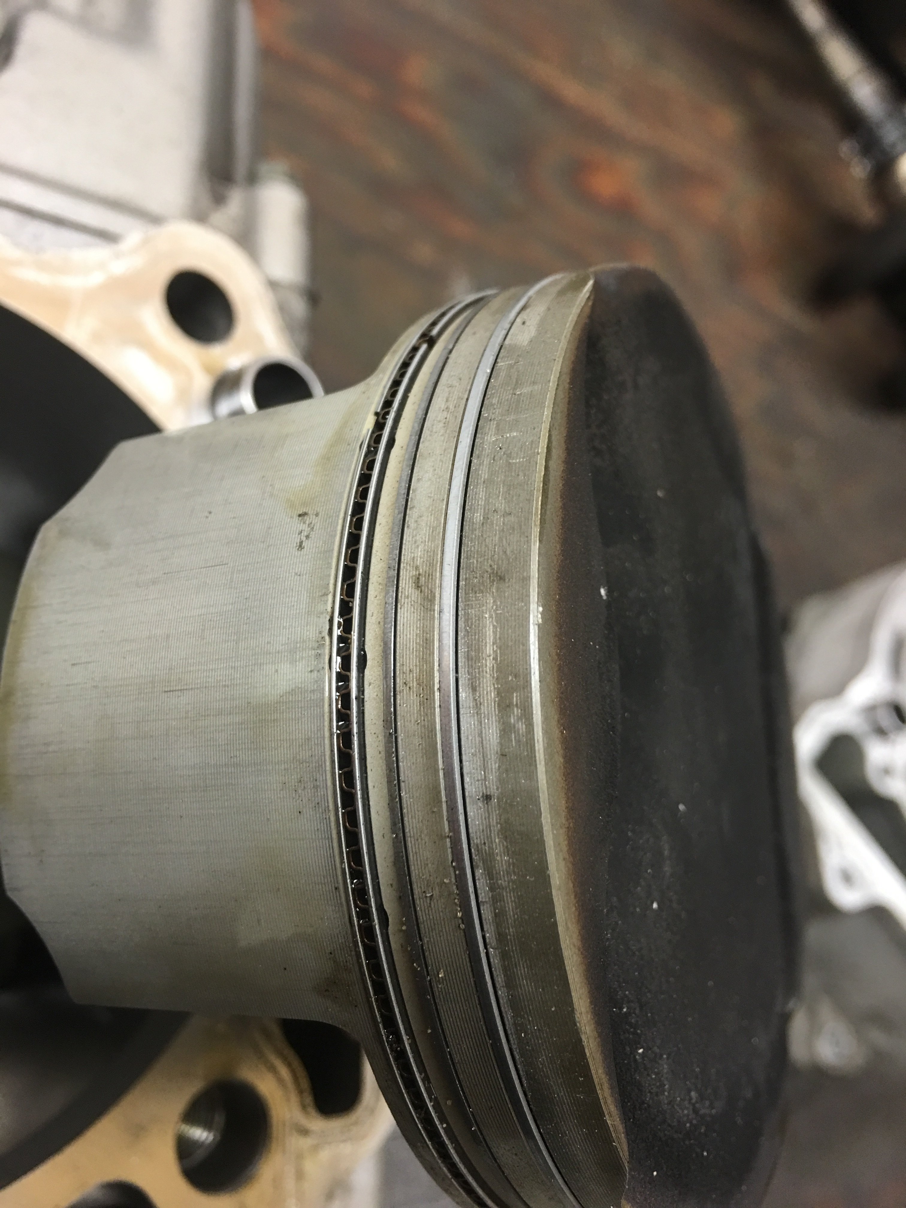

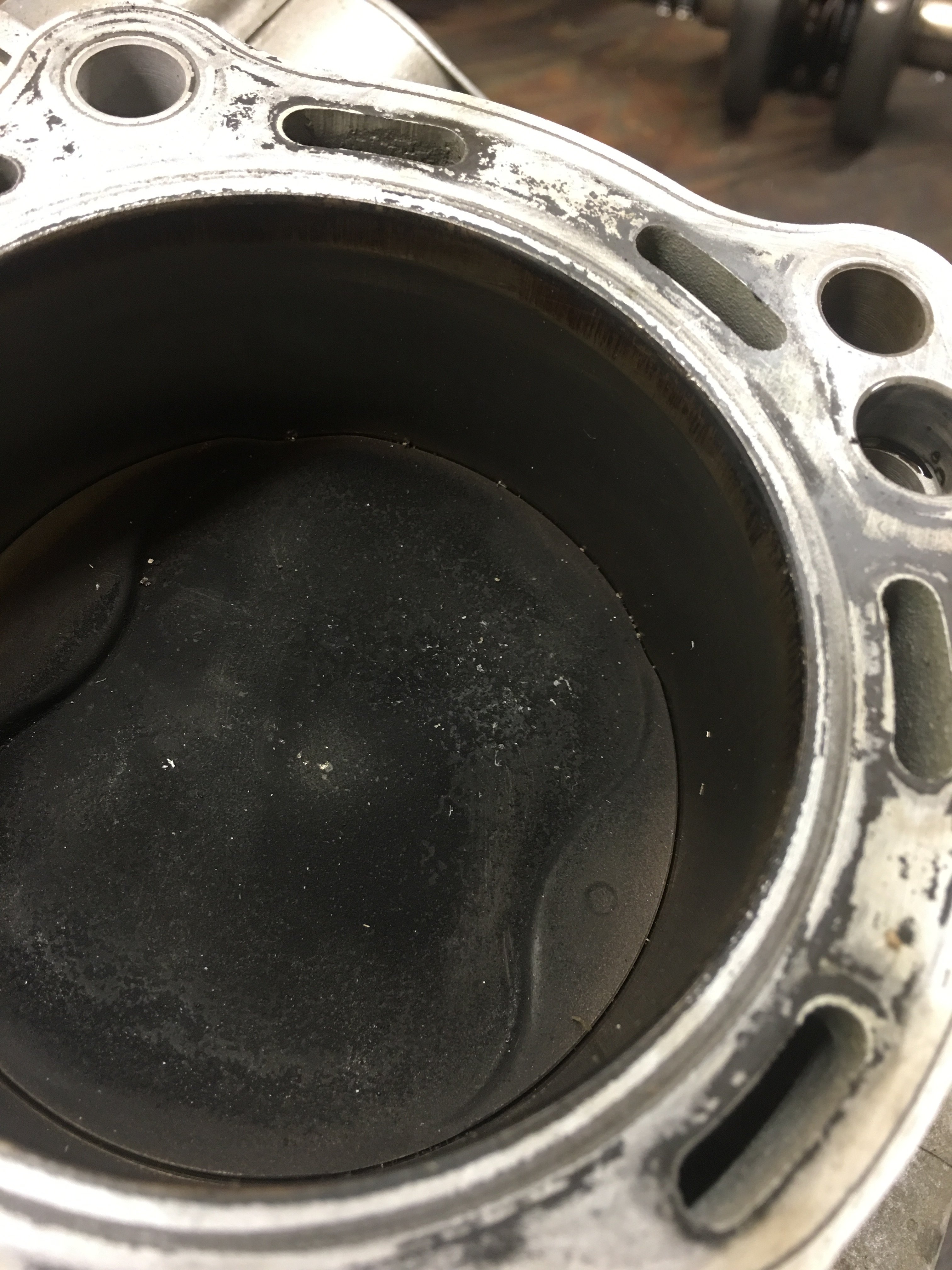

So I found my rings are stuck from the sand coming threw my engine. I would have had to diamond hone my cylinder and replate it.
Some of the sand I saw on top of the piston.

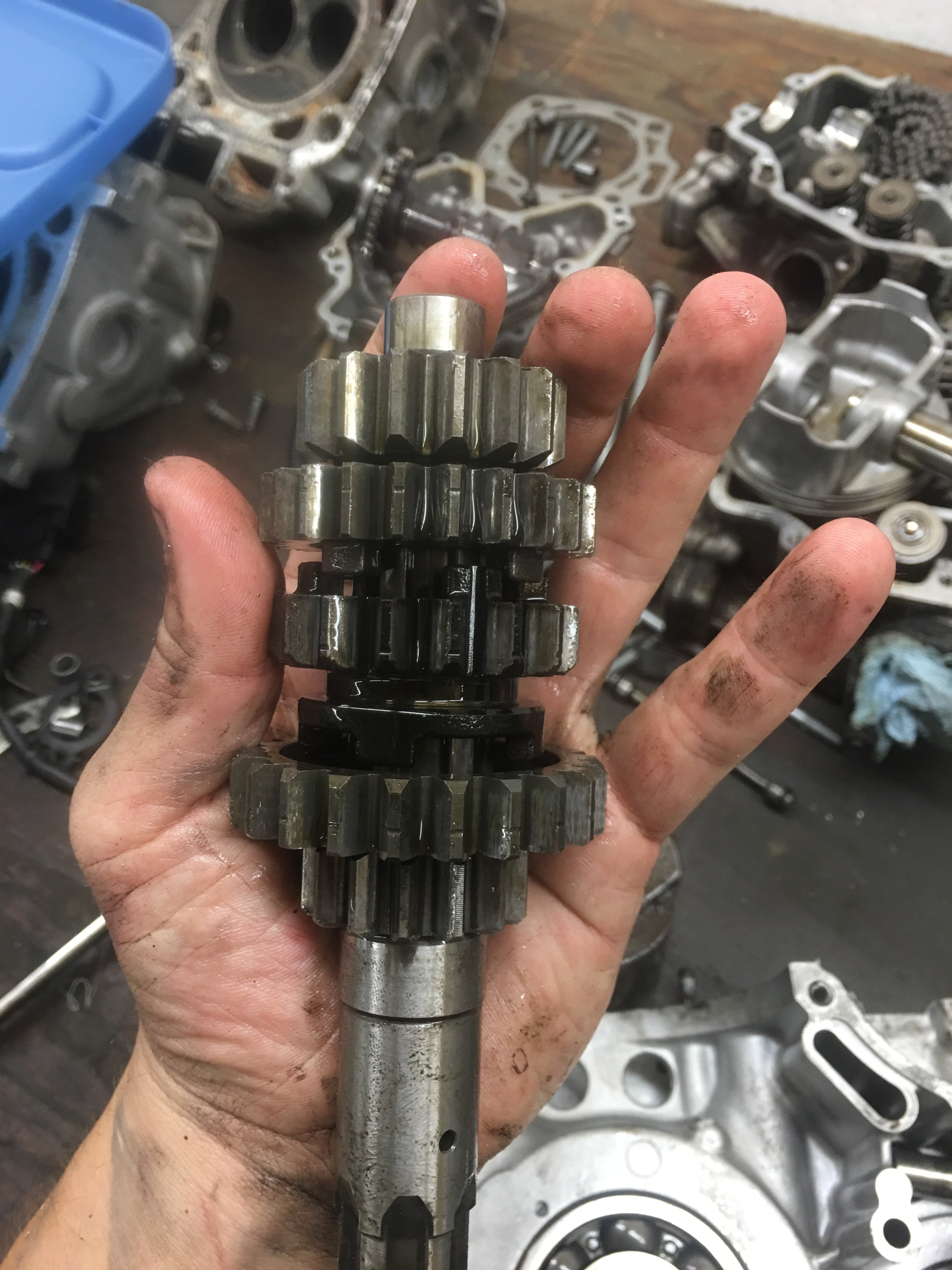

everything on the inside looked fine. I went threw the whole motor and nothing was worn or broken. I'm sending my trans off to get isotropic treatment done for better shifting and longer life.

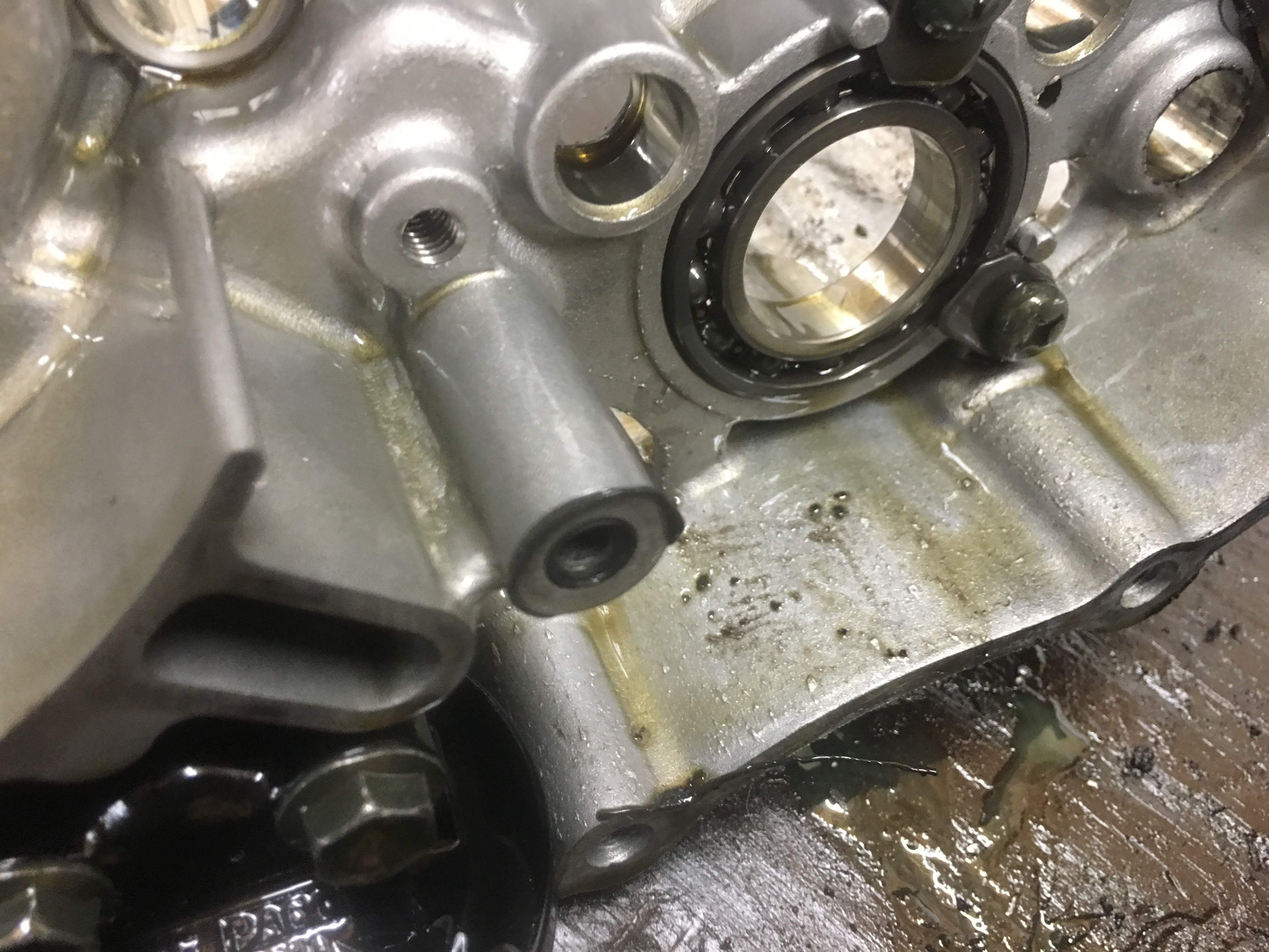

Also found some sand at the bottom of the case when I split it apart.
So as of now I'm going with a 480 kit that I have had for about a year. It's a +5.5mm piston and +4 mm crank. I have a set of web cams custom ground coming along with ferrea +1mm valves and ferrea Spring kit. I'm also getting my carb bored from a 39mm to a 43mm. The head work is gonna be done at the shop with new valve guides and seats made from moldstar 90. This material is very very good at removing the heat from the valve. It's a very good material to make seats out of. It will be hand ported in the shop by my friend who has done over 10k heads for small motor high performance builds. I'm hoping to make 60hp or even a little more. This should be one of the highest hp drz.
