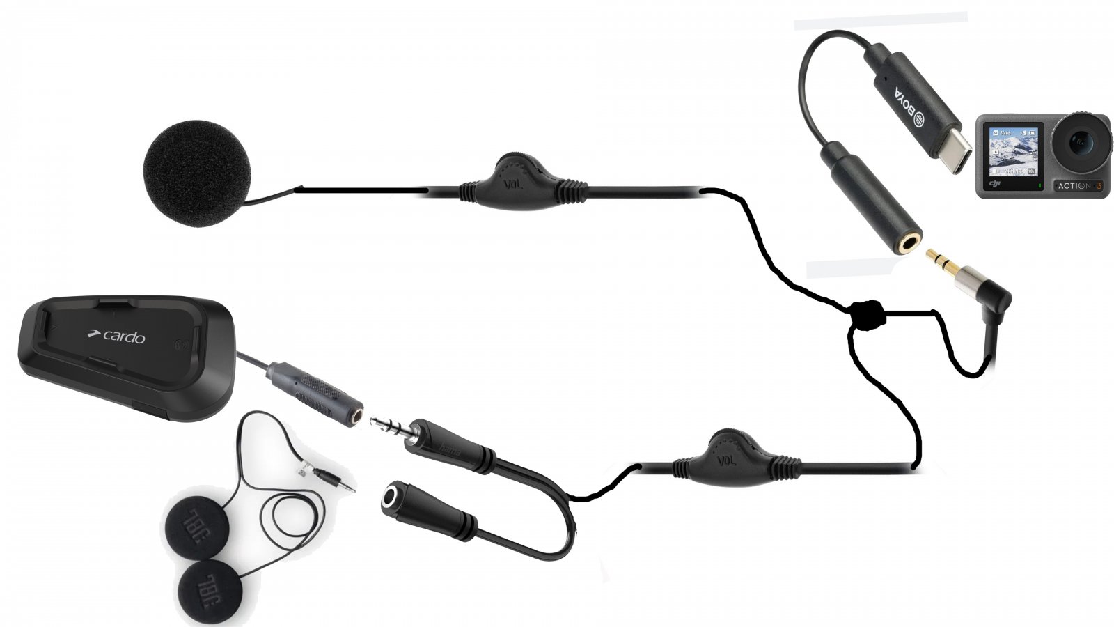

It's not the best way. Here is a diagram of how I do it. Insert any intercom for the Cardo.
Stereo splitter from the Cardo headset out. One to your speakers, one into a dual audio inline volume regulator. Why? Because the Cardo level is way higher than the mic level. For the Osmo Action 3 the mic level also needs reducing.
In order to have your voice and the intercom audio on two different channels, you WOULD need a stereo to mono splitter cable, but why make it complicated? Just snip the correct wires inside the inline volume regulator. Job done.
The good thing about seperate channels is: you can adjust the volume levels seperately and you can cut out the intercom audio if you don't want to have it in the video.
Of course you can go the two mics route, but you asked for the best way. And when talking about "best" I mean best lossless audio quality.
Thanks mate, So do I need to be handy with a soldering iron to do this? Or is it all plug and play?
You can go the plug and play route, but it can get very tight if you are planning to dump all the cables inside the helmet. Hence why I've soldered my stuff. You could even reduce the number of connectors by splitting the headphone cable instead of using a splitter, but I wanted to be able to revert everything back to normal.
At the moment only the male end of the volume regulator is peaking out at the front of my helmet. TRS to USB C adapter then goes into the OA3.
