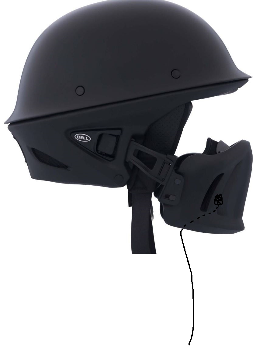

you might need to experement a fair bit, a fair few people have them right up against the cheak pad on the left or right, but depends on your helmet style, also chin curtains n other things can affect it. i have allways found that they help. chin vents can creat a lot of wind noise. dead cats/foamys also can help.
I have a half helmet, so no chin bar or cheek pads - this is probably the #1 reason I want tmagness to chime in - dude rides without a helmet and still has phenomenal audio.

I should really consider something like that. I HATE full face helmets!
I do too! My first couple of years of riding were with a full-face, but I could never find one that fit right - they always gave me a hot spot on my forehead after 5-30 minutes of wearing it. My half helmet is now 8 years old and is the only one I've found that fits me and doesn't give me hot spots (except for the aforementioned headache with the GoPro hanging off the side and the strap not tight enough - oops!).
I keep looking for other half helmets, 3/4, or modular helmets that fit, but have yet to find any. "Long Oval" is my head shape... I say I have the head of an Alien LOL.
