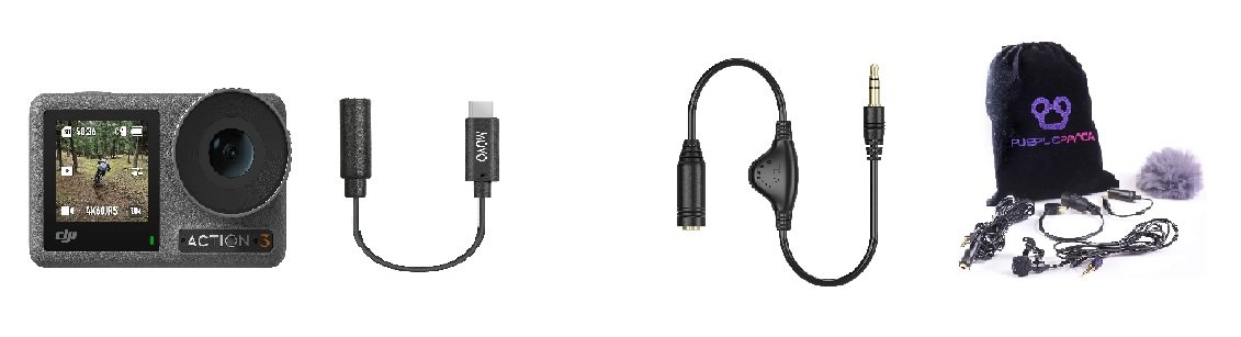

I am far from an experienced user but I use an action 3 with a purple panda and the audio is on point. The audio gain on the camera is set to 0 or -3 if you don't care too much about exhaust notes. I have a dead cat on the mic, and position it just in front of the cheek pad. The big trick to get rid of wind noise is to add a cable with volume adjustment and set it at 50%.
