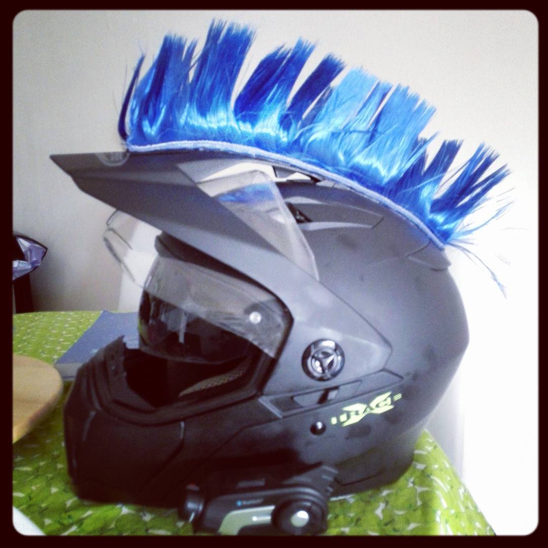

for almost 3 years I've been using Sena 10C as my main camera
The biggest benefit from it, I get a good sound quality from the built in headset.
I've transferred my setup in 3 helmets so far.

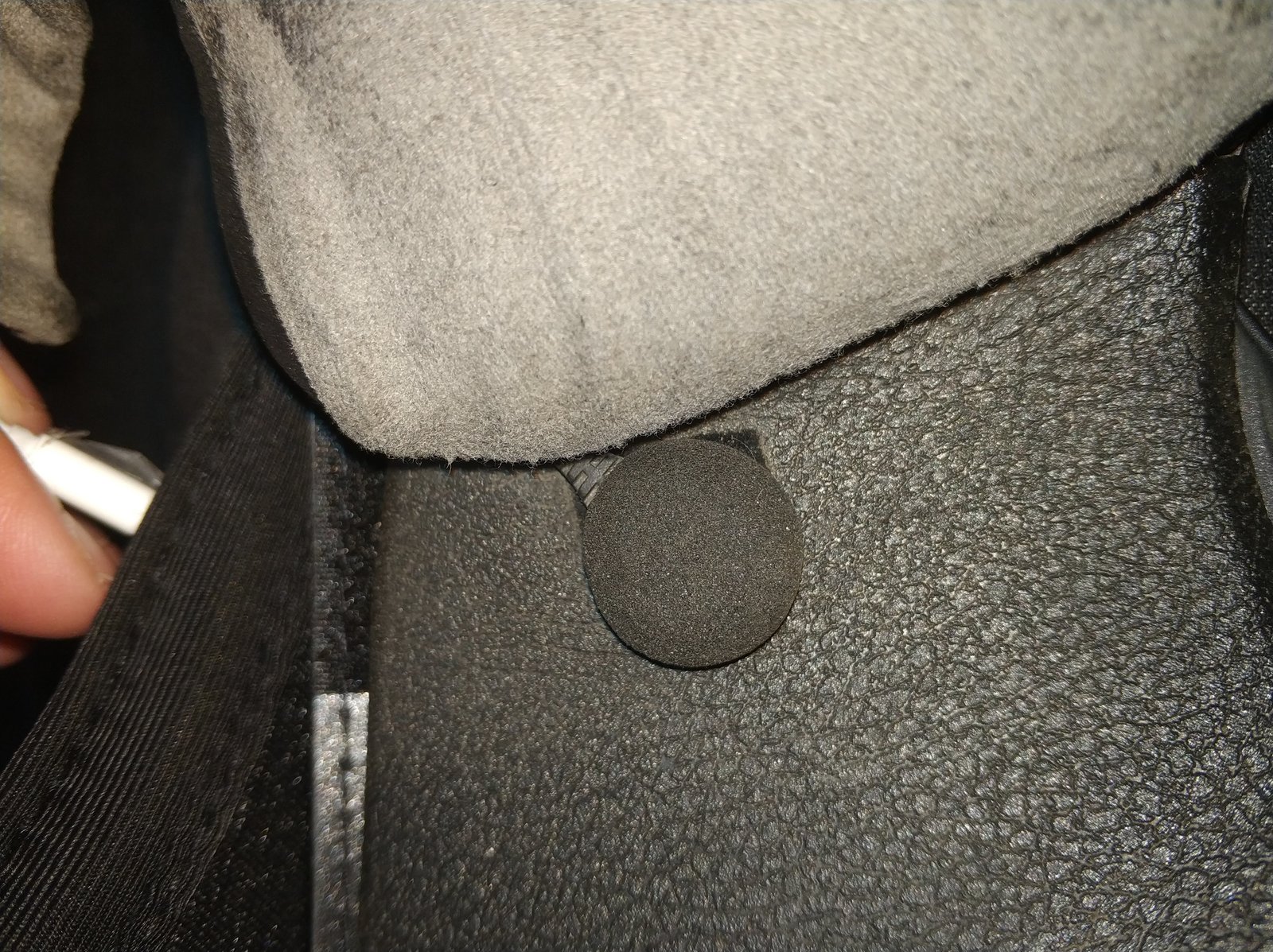

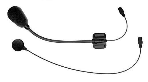

The Sena headset comes with 2 microphones, a wired one, and a stiff boom mic.
For all this time, I've been using the wired microphone (the bottom one)
placed it near my cheek pad with the stock sponge for wind blocking.

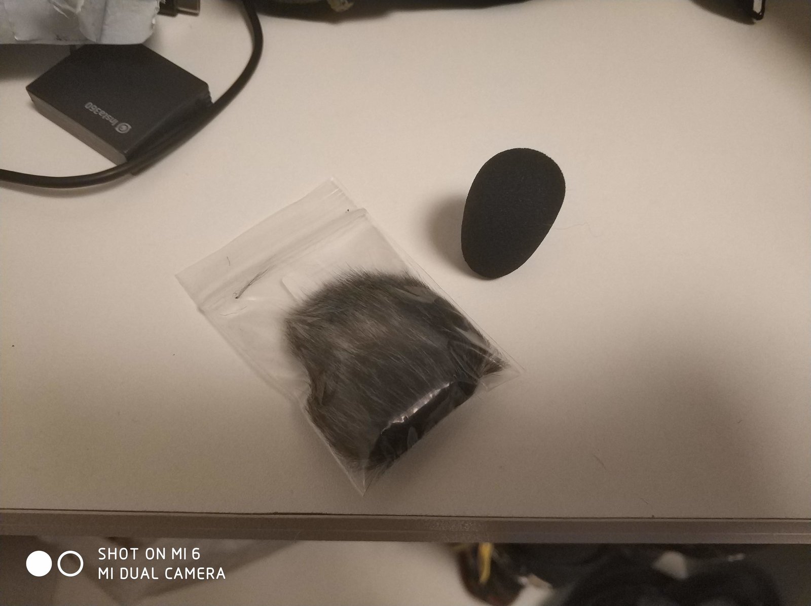

One day, the wired mic died on me.
Bummer, but I still have the boom mic that I've never used.
Swapped it.

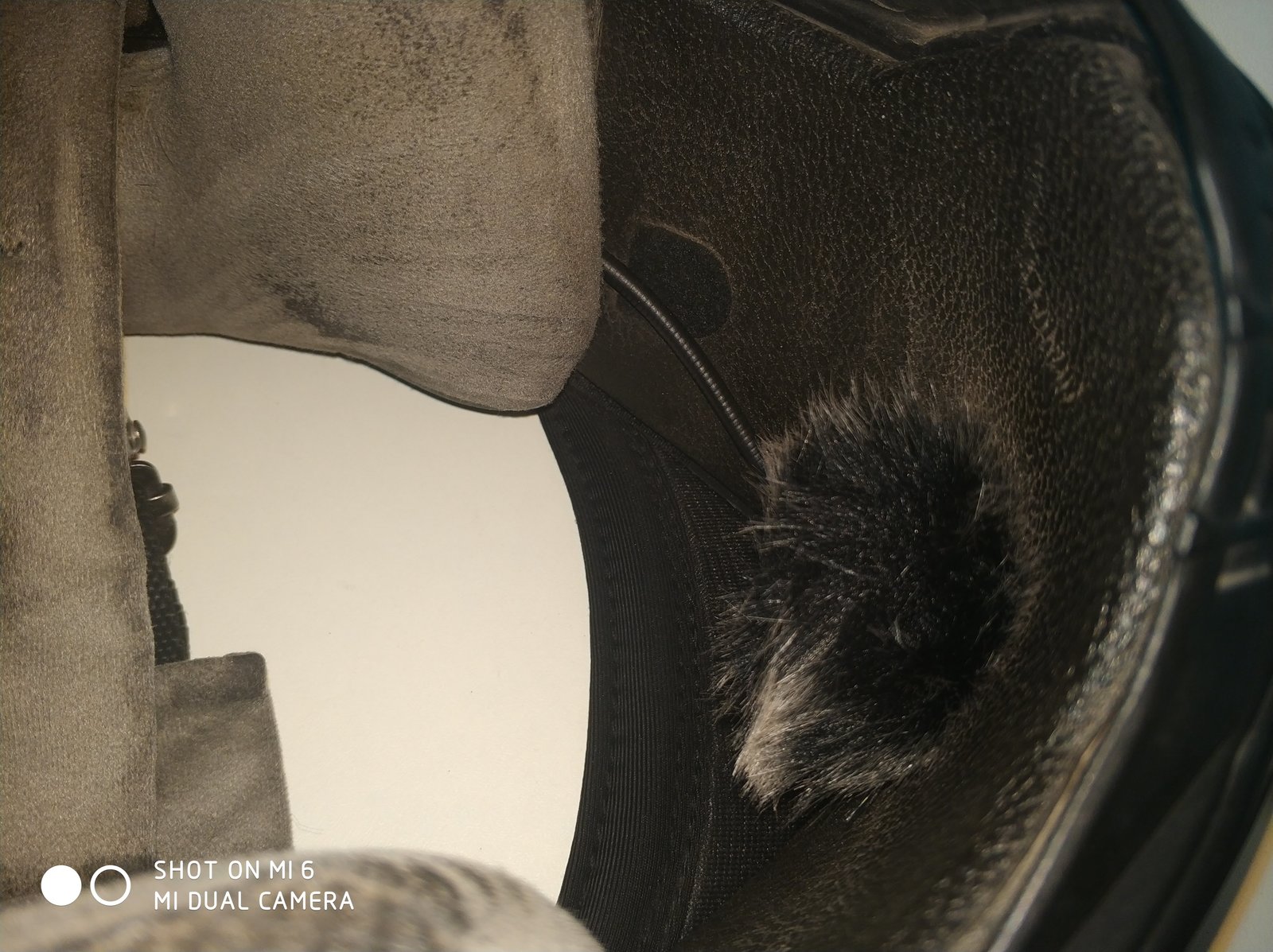

and bought a dead cat wind muffler from Ebay to replace the stock sponge cover.
https://www.ebay.com/itm/152210544638

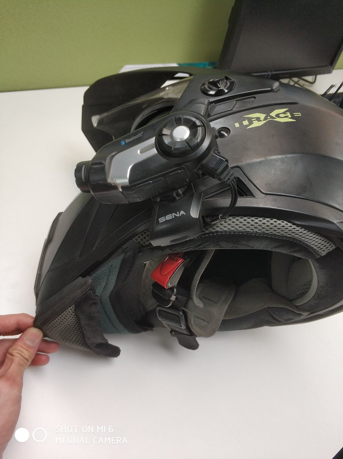

I've moved the microphone from near my cheek pads, to as far as I can from me.

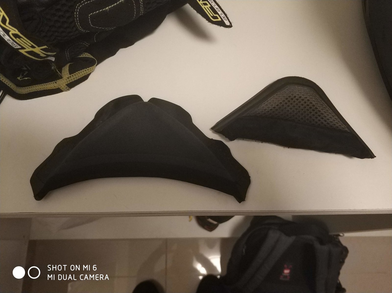

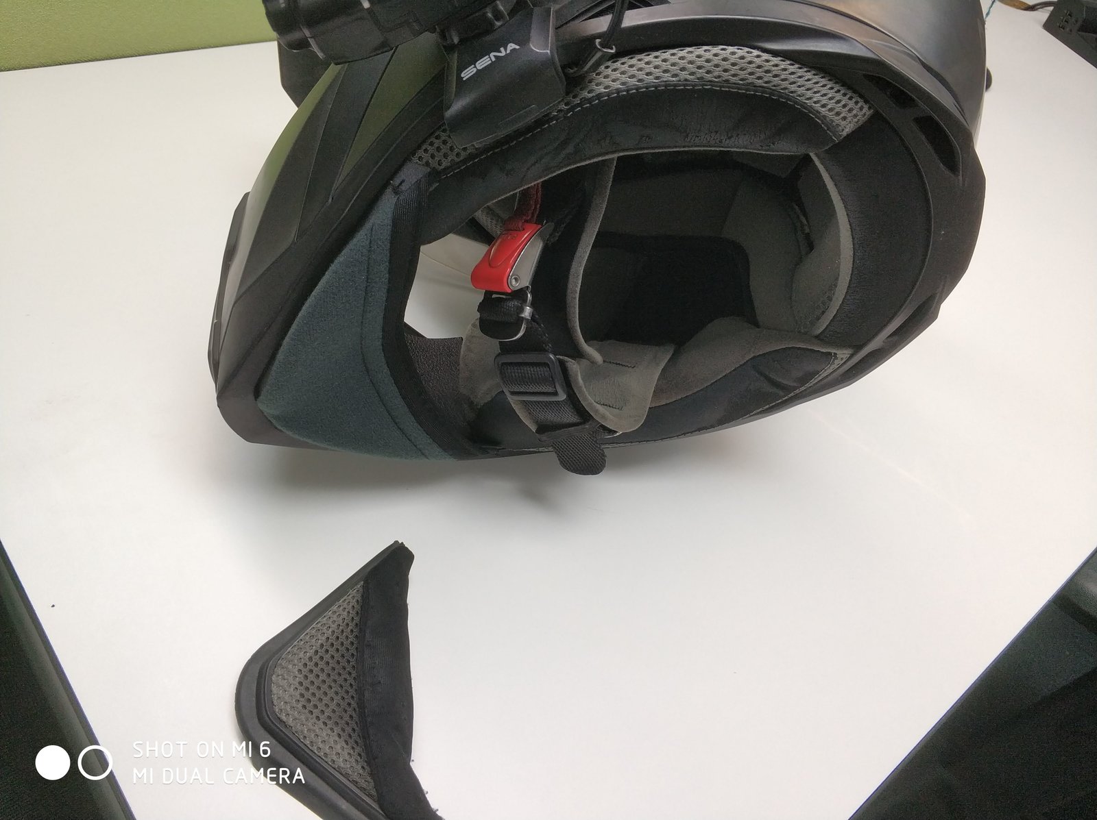

I've also changed the bottom wind deflector of the helmet to a longer and less perforated one
And now, after all of this changes. time to put it to the test!
And now, I need to know what you think
Do you have any idea on how to make it even better?
