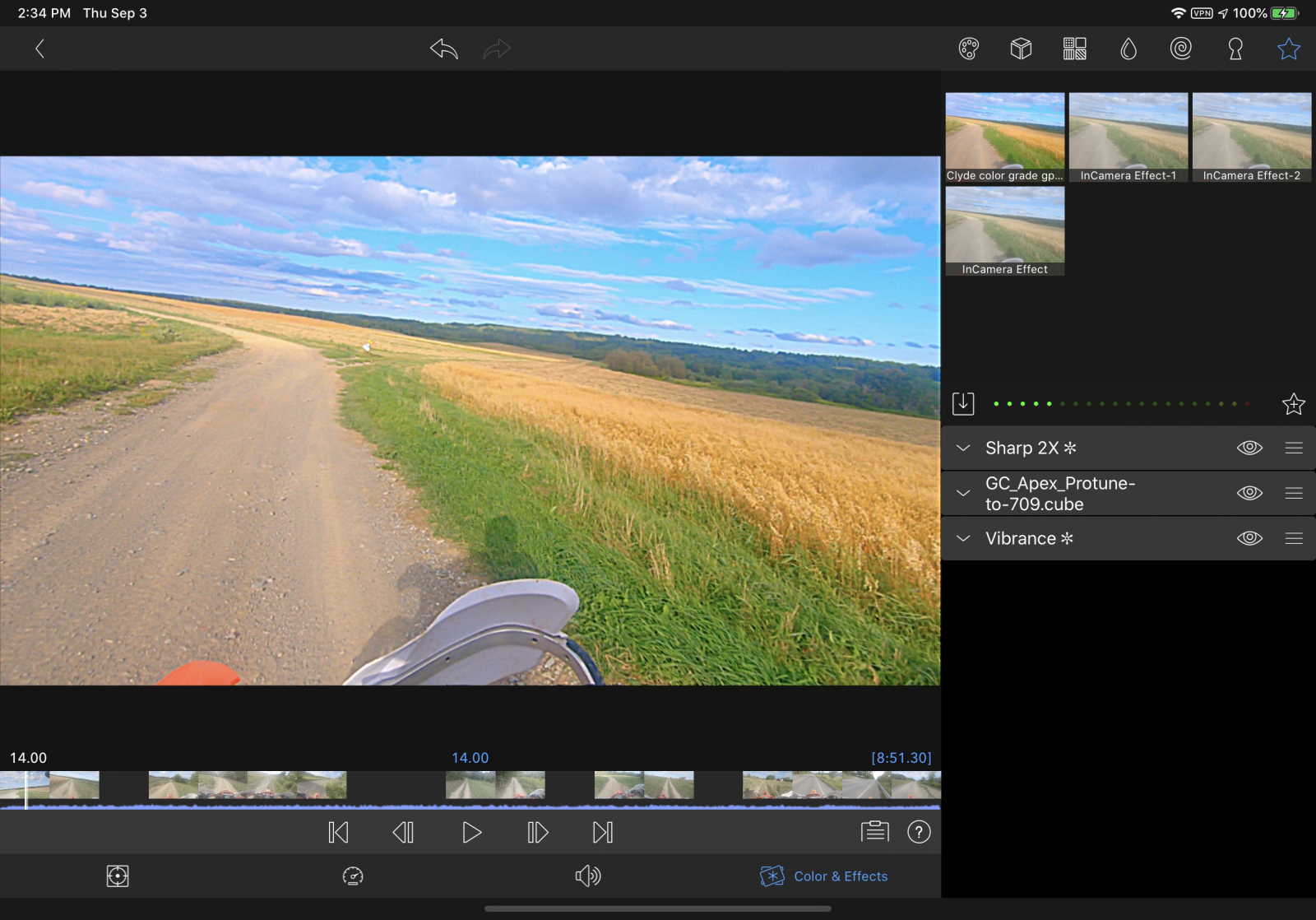

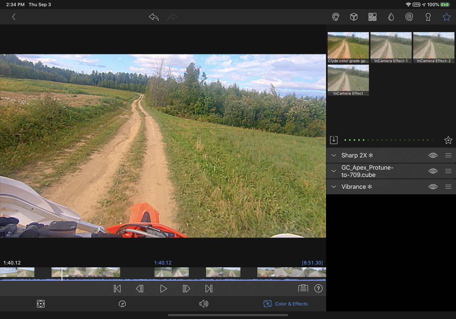

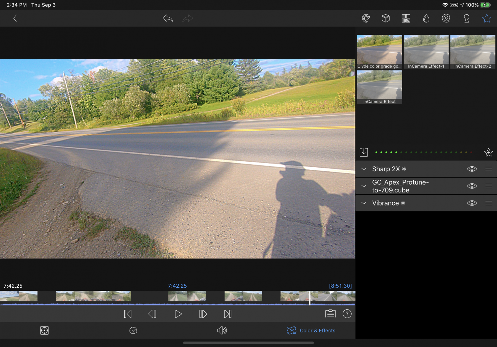

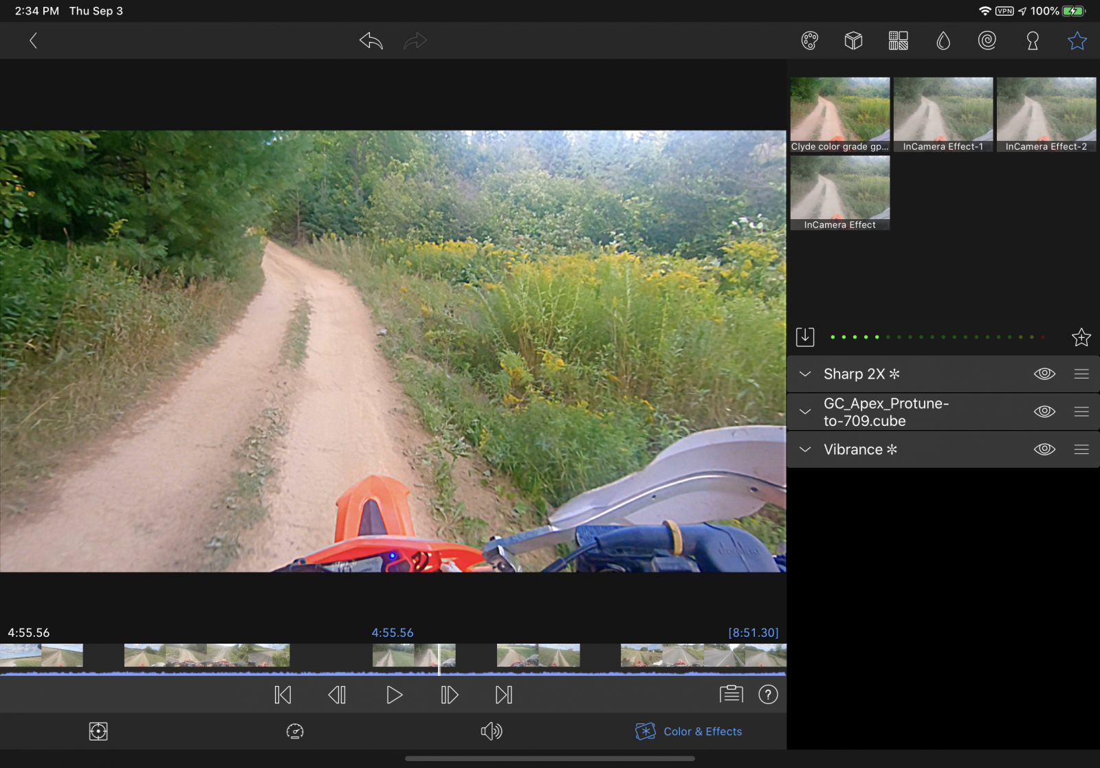

Ok I’d love to hear everyone’s thoughts on the colors on these stills from the video after grading. Too much or too little and overall thoughts?

I am too new and too lazy :cool: to do it myself when there is an auto feature. I think your stills look good though.
