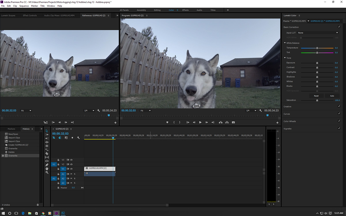

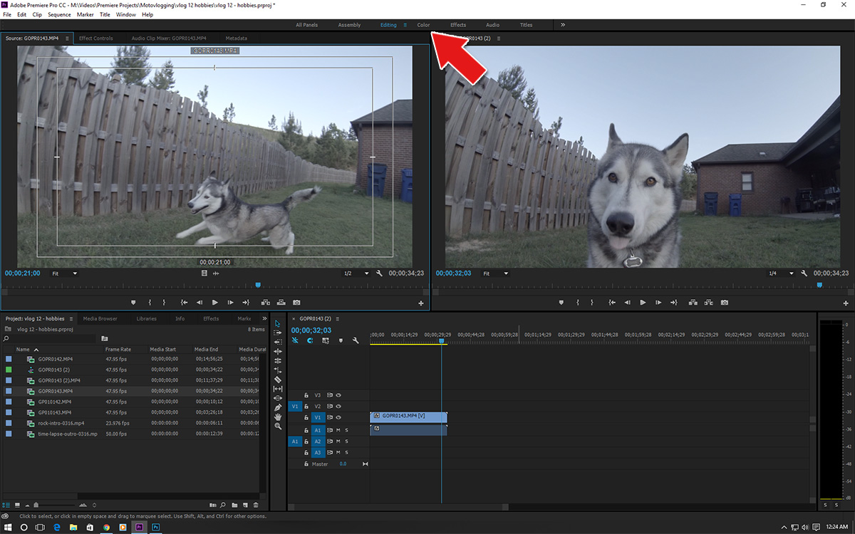

When you fits open your project and put some footage on the timeline, you'll have a window similar to this:
When you are ready to do your color grading (I suggest doing this as final touch up as it hogs processing rendering the color correcting in real time), click the "Color" workspace at the top of the window. This launches the color correction workspace and the default Lumetri Tools plugin.

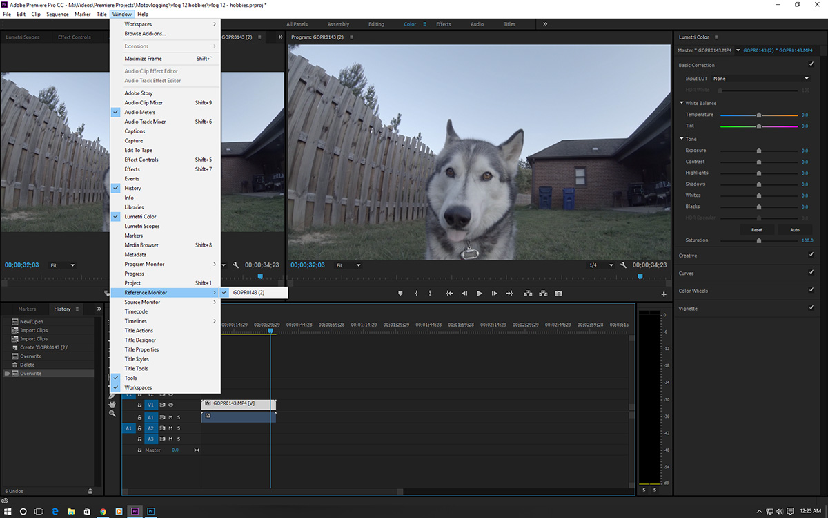

That will give you a workspace that looks more like this:
You can do some tweaking to the workspace to allow it to better suit your needs. For instance, you can add a reference window which has an independent timeline that you can use to match color between shots.
Or move your scopes and such to a different window to make viewing them easier ...

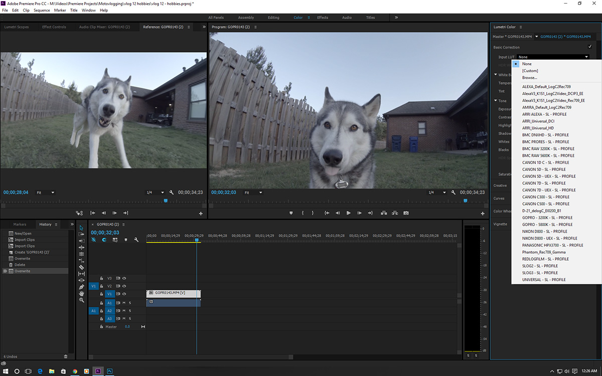

Okay, so you have your workspace adjusted. Let's look at the Lumetri Tools interface.

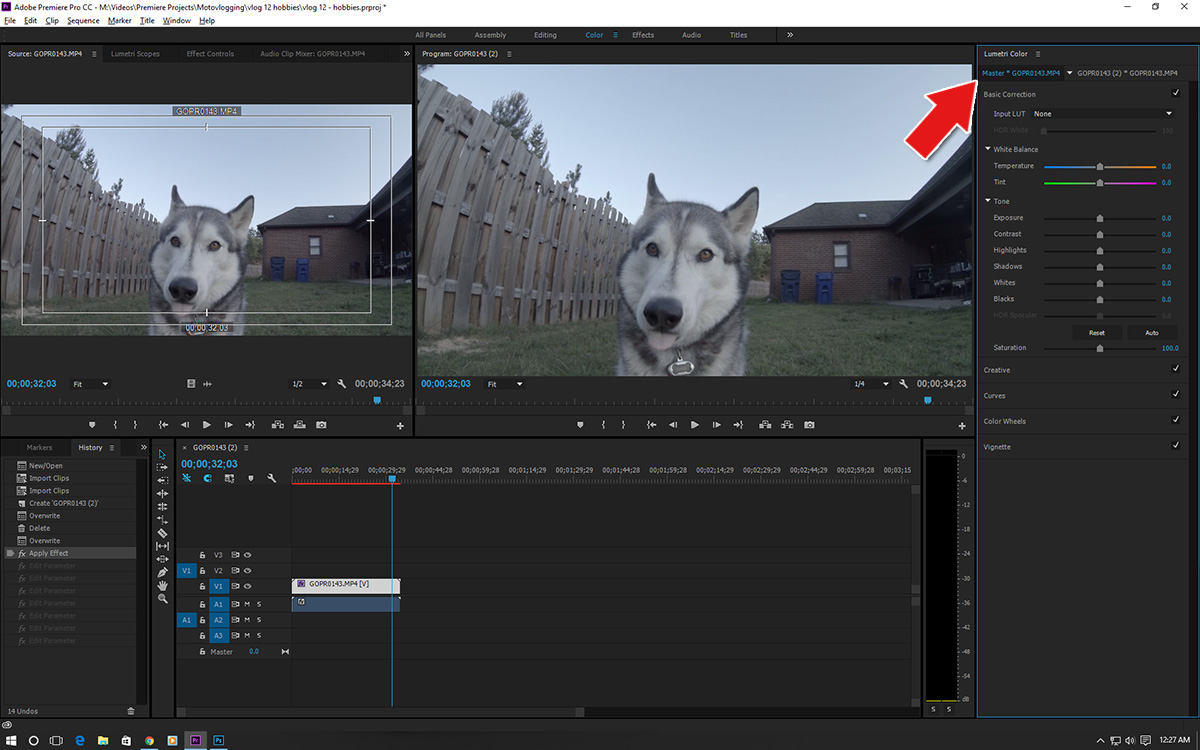

On the right side of the window you have the Lumetri Color toolset. This includes five independent sections that you can use to adjust the image. You can use just one or all five. I tend to use a mix of many.
But before we start moving sliders around, take a look at the top of the tools area ...
Make note that you can select to edit the entire master clip of the footage that you've got selected, or just the specific clip that's selected. This can save you time, as if you have several clips from a larger video on your timeline, you can adjust them all at once. Or, even more useful, you can apply base correction to your entire clip and then add adjustment to individual clips on top of that to tweak it just where you need that extra bump.
So, one of the first things that you see is a pulldown menu in the Basic Correction area. This allows you to quickly apply presets to your footage. Or, you can also import presets that you've saved or downloaded. We're not going to use this in this tutorial, but I'll show you how to save your preset at the end.

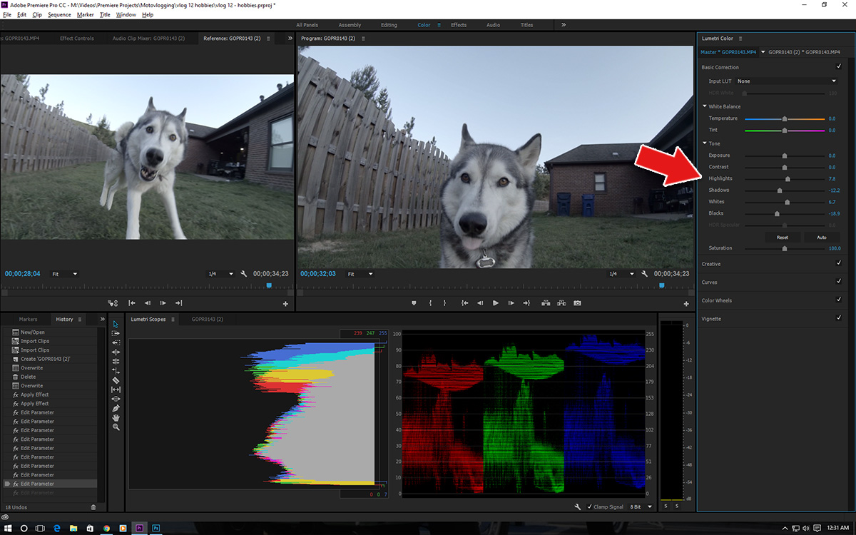

Look just below that pulldown and you'll see the basic image adjustment that will begin to transform your flat Protune image into something that pops.
I like to begin with adjusting the shadows, highlights, whites and blacks. These adjustments work similarly to the "Shadow/Highlight" and "Levels" filters you find in Photoshop.
Highlights Makes the brightest parts of your image brighter or darker. I usually bump this up while watching my histogram until I get a pure white in the image.
Whites works siilarly, but targets the pure whites in the image. This will effectively crush the whites when raised, changing the near pure white pixels to pure white. I bump up this value as well to add a little contrast.
Shadows is the opposite of highlight, affecting dark areas. Blacks is the opposite of whites, affecting the black values. I lower both of these to add depth to the image.

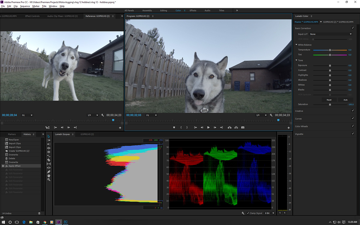

With these adjustments made you'll begin to see much more contrast in your image and the histogram in your scope area will now show a true black and white value (bottom and top, respectively). Colors, however, will still be a bit dull.
Next, I begin adjusting the exposure, contrast and saturation in the basic settings area. Just make small adjustments and try turning the effect off and back on using the check box to the upper right, comparing the images, until you like the result. For saturation here I usually keep the adjustment less that +15% because we'll adjust the main saturation value in another area.

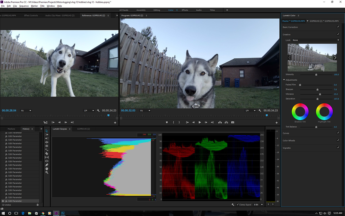

Next, we'll move to the "Creative" section.
In this area I usually sharpen the image a touch and bump up the vibrance and saturation again. Vibrance is a bit like saturation but attempts to bump up the colors that are muted more than those that are already vibrant. It's kind of like fake HDR. At low values it's not as noticeable as saturation, but effective. The saturation value here works the same as the once we adjusted earlier, but I just tweak it here as well so I can easily balance the saturation with the vibrance setting.
In this area you'll also see a dropdown with presets you can use. When you have a preset selected, the "Intensity" slider changes the amount of the effect that's use and can be blended with the original footage by going below 100%.
You'll also find specific tint adjustments for the darker and lighter areas of your shot. If your shot is properly exposed and lit well, these shouldn't come in to play.

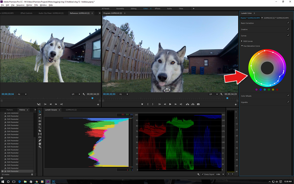

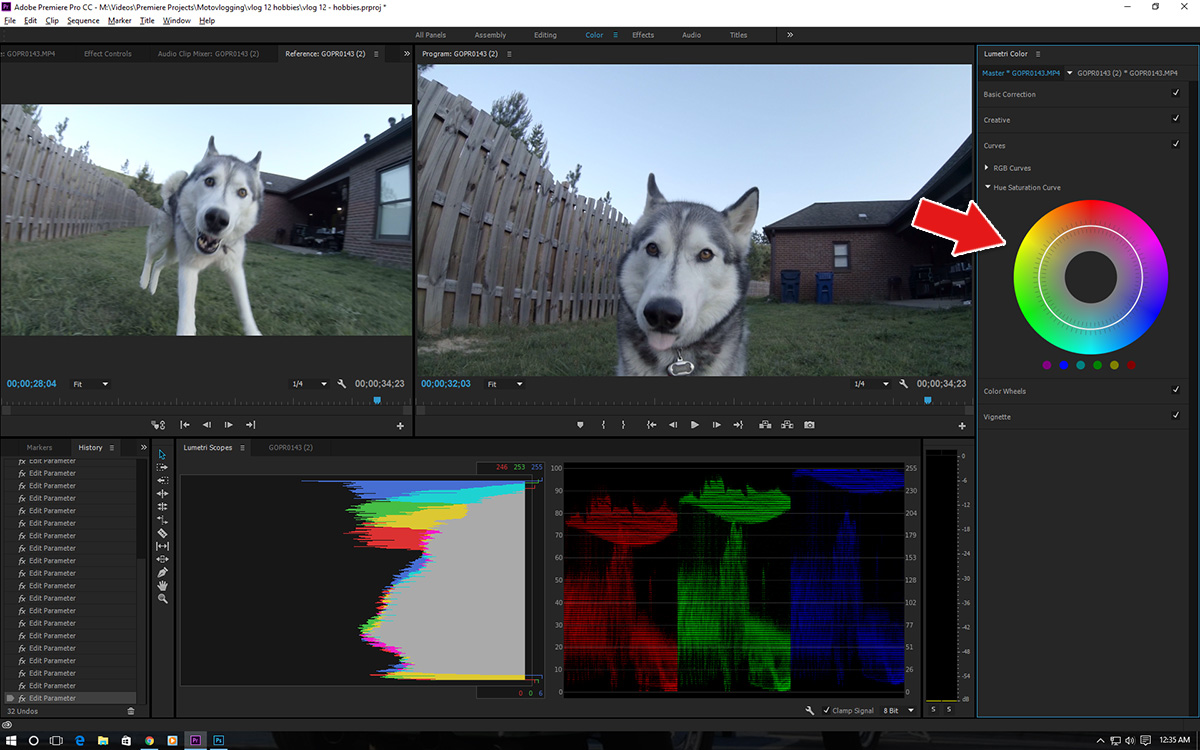

Next, lets open the "Curves" workspace. Here you will find the tools that will really make the colors in your shot come to life.
There is an option for standard RGB curve adjustment like you find in Photoshop, but I prefer the Hue Saturation curve adjustments as they are simpler to learn and apply.
The white line in the circle represents the intensity of all RGB values. So, making the entire circle bigger, you can add intensity to all colors in the shot, just like a standard saturation change. However, for some reason I like this effect more than the saturation slider in the previous area. I don't know why, but I do.

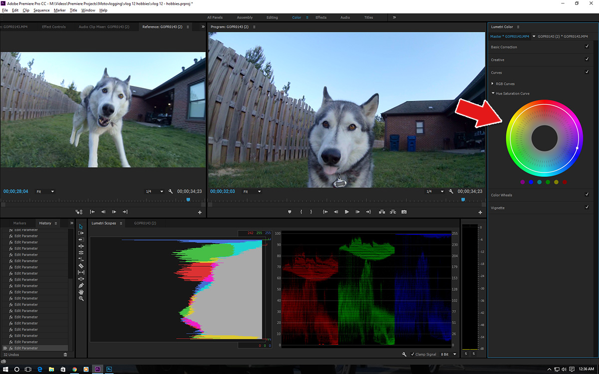

After you up the saturation for everything, you can add bezier points and curves around the circle to tweak specific color ranges by clicking the colored dots below the circle. Then, drag the dots to increase or decrease saturation of each color as you with. Moving the line toward the center decreases saturation and outward increases it.

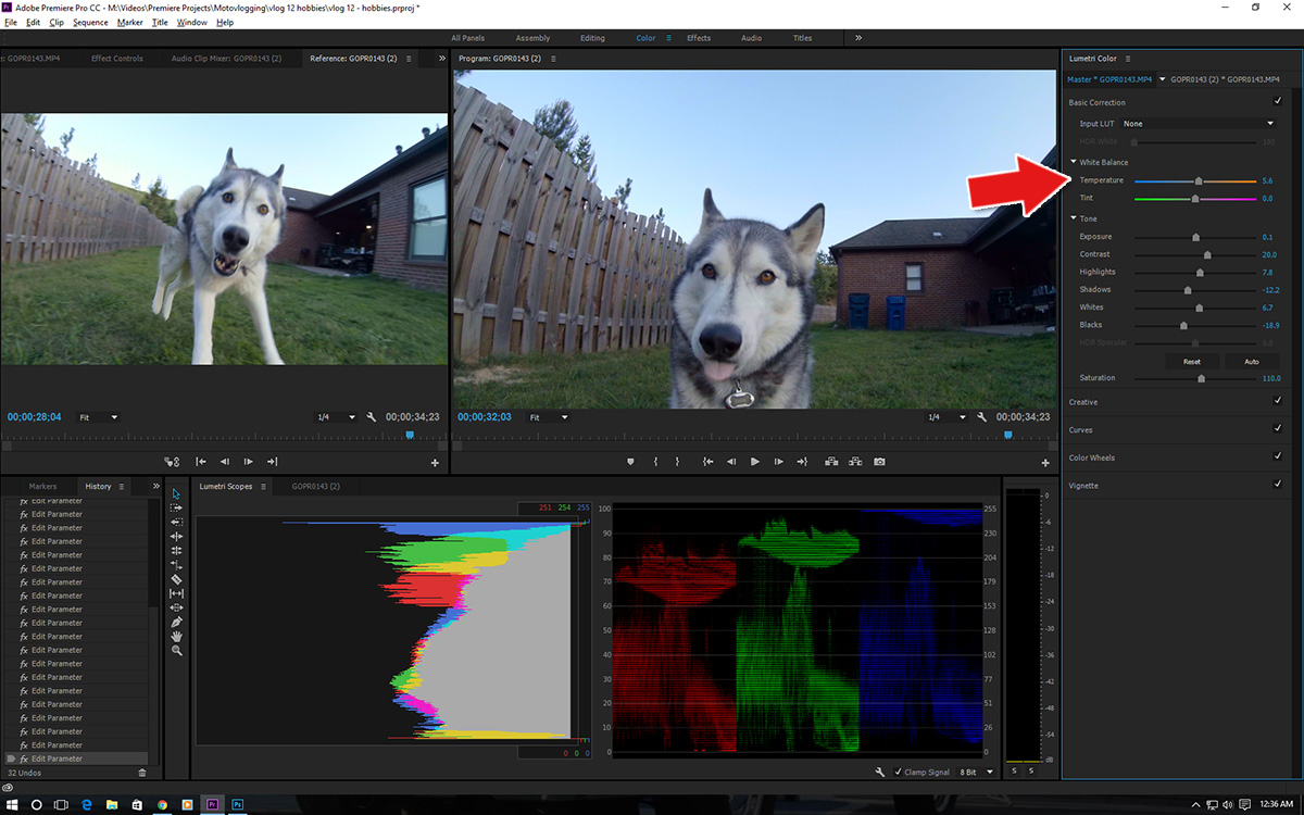

Now, at this point you might be seeing an overall color shift in your image to either the warmer or cooler sizes of the color spectrum. After all, we've only been adjusting the intensity and lightness/darkness of the footage so far, not altering it.
It's a good time to revisit the Basic Settings are to tweak the color balance and tint as needed to get a proper white balance on the footage.
You can also revisit any of the previous settings as you wish. Tweak anything that's needed to get the image to look the way you want.

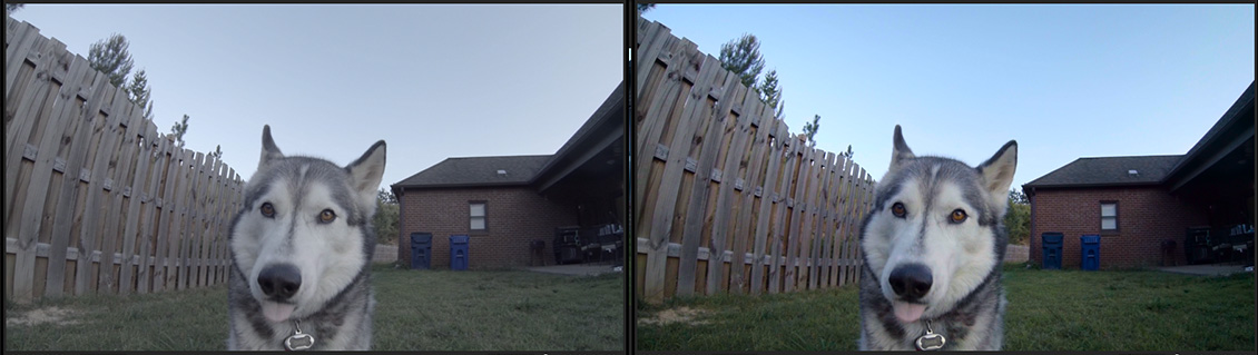

And that's basically it. The image is adjusted.
Here is the comparison ...

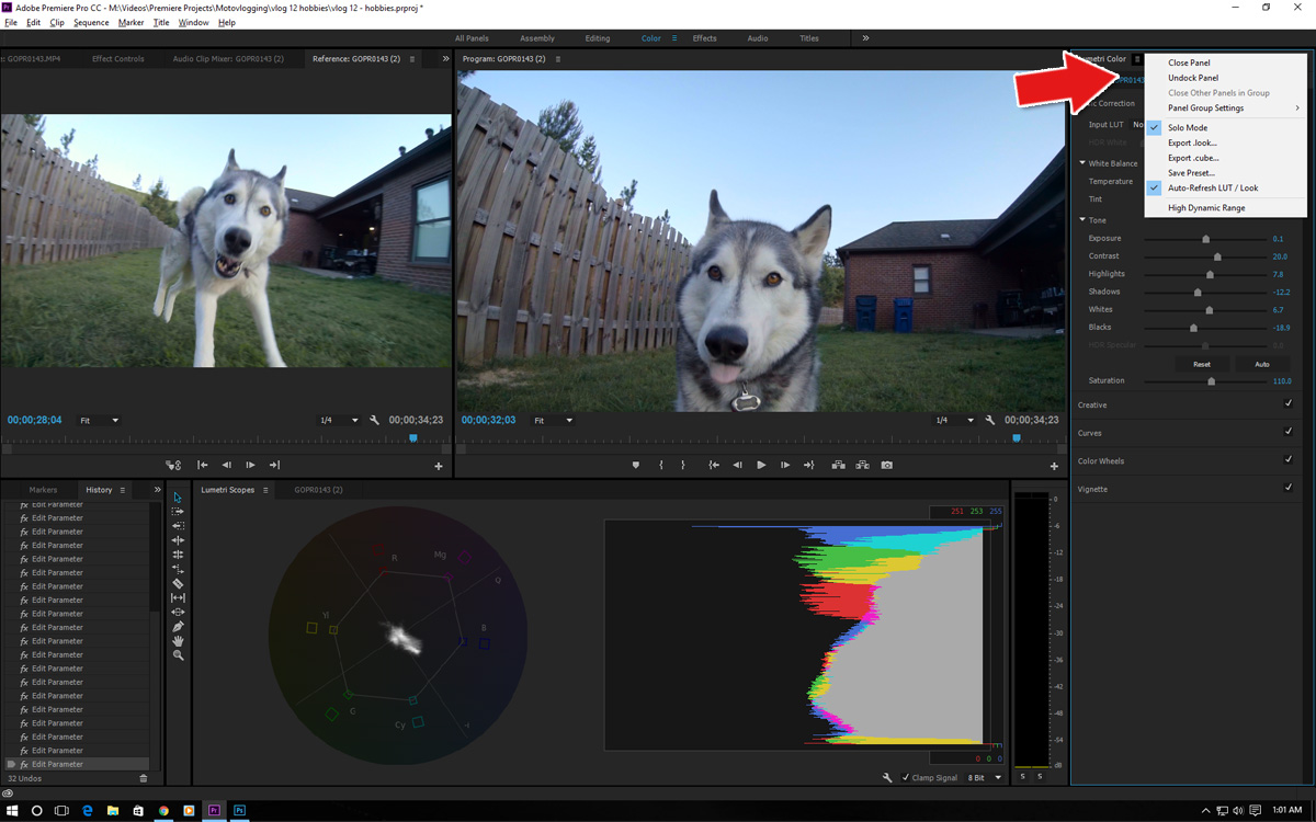

When you've got a look that you like, save yourself some time by saving a preset or LUT file that you can reuse for all of your Protune footage. Saved presets can be found in the Effects area under Lumetri Presets. You can save presets using the menu option in the Lumetri Color window.
