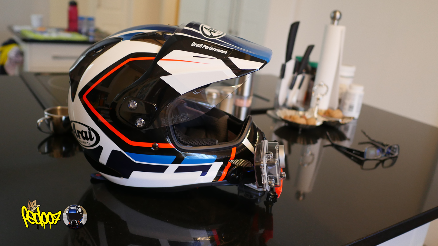

I am running a Hero 4 black on an Arai XD4 with Sena 20s and Sena Bacpac.
Stock Mic, from Sena. Thinking of adding a dead cat.
The hooligan style helmet did not provide great mounting options so I built my own mount using Blender and a 3D printer.

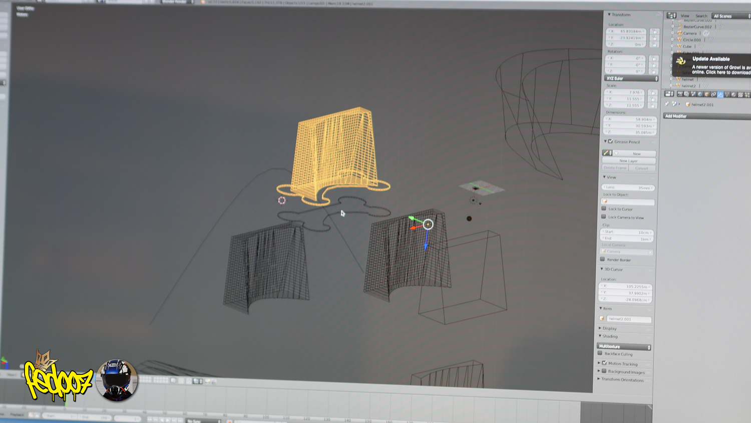

@Kitten , I broke out calipers, pen, paper and modeled it myself in 3D off the helmet dimensions, then exported the STL for my printer. It took a couple iterations to get the expansion scale righ twith PLA but it is holding up like a champ with no post part processing such as edge fusing.

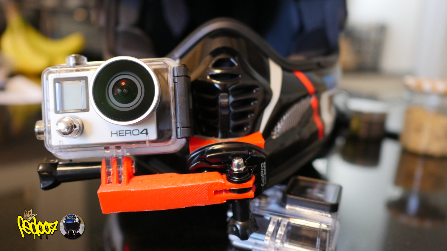

This is the custom arm so I could have it tucked nice into the side and I custom positioned the hinge in 3D for both ends.

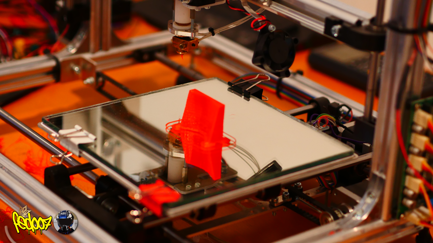

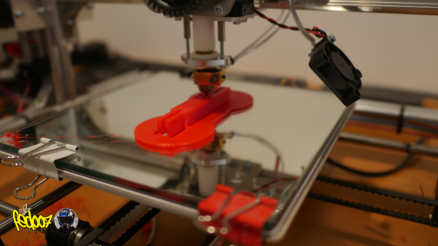

My Home built 3D printer does nice accuracy when
it prints slow!
Yes most of my designs end up in CNC alum. 3D prints are proto only, but can be epoxy coated and post processed.
and yes there is a leash. look for the black dot on behind the cam.
