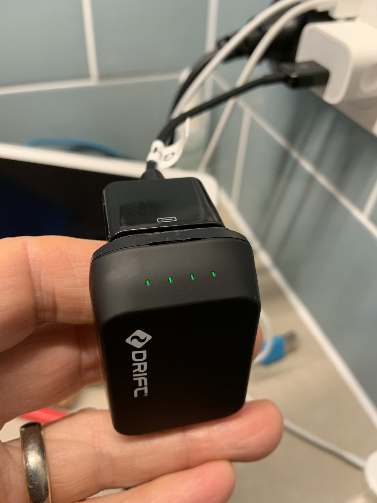

The battery is guess work to be fair, but I also have the long lasting one and it came with built in LEDs which I'll post a pic of. It lets you know when it's charged. Rode do great but not cheap microphones, but I'm pretty happy with the Drift one so far, I use setting 1 or 2 for sensitivity - but I think that depends on helmet set up etc for individual use. I should really consider a tether, but so far I'm pretty confident with the fixing as is. I have two Ghost X. I like them a lot! Still learning with the different resolutions, some googling in the offing so I can understand the differences too.
Pic of heavy duty battery
