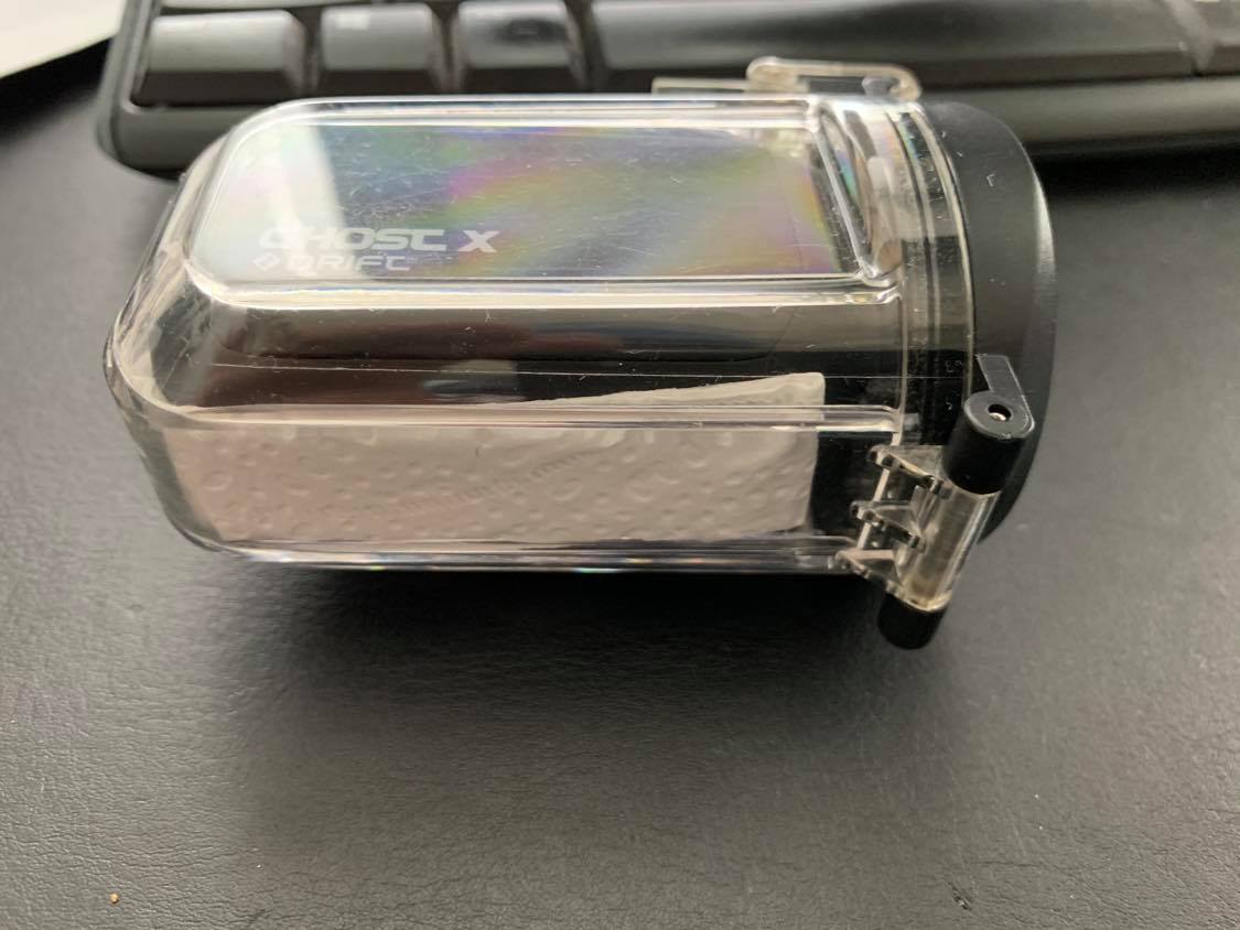

The reason for using the Drift Ghost X is the 5hr battery life (it's too difficult to change a battery on the water) and the tubular format and small size. However I have been having difficulty trying to find a manual (there's only a quick guide from Drift) to resolve some issues and also a way to prevent the waterproof case from fogging up as soon as it gets splashed with water which is cooler than the air temperature.
DIY Anti Fogging
I've also struggled with keeping the lens cover of the waterproof case from fogging up in warm weather when the sea temperature is much cooler and as soon as it gets splashed, it starts fogging up. The trick is to remove the foam padding from inside the case and replace it with a strip of folded paper towel - cheap and easy to replace unlike the GoPro anti-fog strips. Works for Ghost X and 4K waterproof case.

The problem with the Drift X is there's not much room around the camera for one of those sachets without affecting the latch.
But you can roll up a piece of paper towel and wedge it in small spaces.
