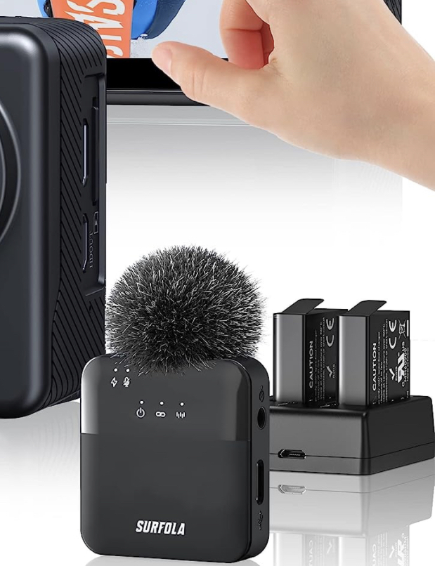

Don’t suppose anyone will know if a wireless mic like this would fit ok inside a helmet, or would it be a silly idea? Thanks!

I have a DJI wireless used with my DJI OSMO Pocket 2. It works, but not as well as the wired MOVO lavelier mic. I haven't put much effort into improving the wireless mic yet, but I'm going to work on it. I really like not having a wire go to the GoPro on my helmet.
I see - I’d be better sticking to wired if that’s the case. Thank you
