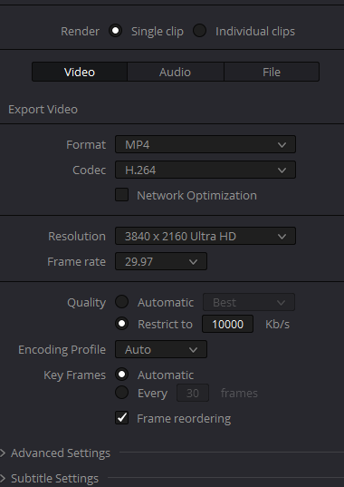

So, i started to try and use Davince, as Magix keeps crashing on the pc (and can't export anything above 1080)
But for some reason the quality dropped massively after rendering.
And youtube still only shows it as 1080, even though it was recorded and rendered in 2k.
Any one any ideas?
The main reason that I can think of is that it hasn't processed on Youtube to 4k yet. When I view it on youtube it doesn't give me any options above 1080 under the quality menu.
Beyond that, a screen shot of the settings you are using to render out your sequence would be helpful. I know quite a few people on here use DaVinci and that would help them narrow down the issue you are having. I stopped using DaVinci before I had the ability to render out in anything above 1080. But in Adobe Premiere, if I don't use the "Youtube2160" or whatever it is labeled, it won't actually ramp up to 4k while processing on Youtube.
After 3 hours being online, and more then 6 hours from the upload moment, it still sits at 1080.
So i think the rendering went wrong.
I will see if i can get a screenshot of the settings when exporting
Yep - LoneWolfer is right - show us your settings and we can narrow it down or fix it, I bet! I export in 2k all the time to upload to YT and it works fine.

Try some different export settings - Jay Lippman did a video on it recently. I've found that it's usually <12 hours for YT to process a 12-15m video.
YouTube has been days slow on processing up to the 4k on my videos. Seriously, DAYS...
Who knew the pandemic affected the little elves in the machines that much?
@HippoDrone , please don't smack me for this, but here's Jay Lippman's video on export settings from DR for YT:
FWIW, I uploaded 3 videos recently, and 2 of them took less than 6 hours to process. They were all 7 to 9 minutes long.
John,
How big is his channel? Big channels get priority for resources over the normal peasants. Been like that since the first YouTubers stepped off the Mayflower.
John,
He's got 35k subs or so - so I get it... in his video, YT processed his video in SECONDS. So I get that bigger channels have higher priority in the processing queue.
BUT, I changed my export settings to match what Jay did, and now my files are about 1/3rd the size with no apparent loss in quality, and YT processes them much faster... it no longer takes a day or more to process a 10m video. I literally uploaded a video at 11:30pm last night, and by 7:30am this morning, it was fully processed in 1080 and 1440 resolutions [2k?], ready for publishing.
